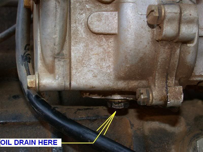

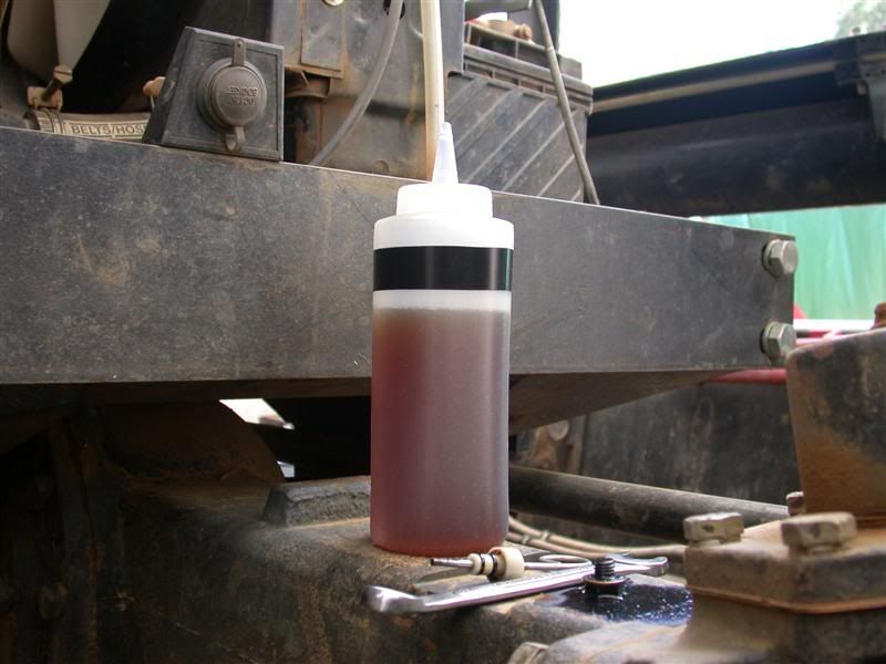

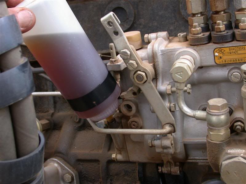

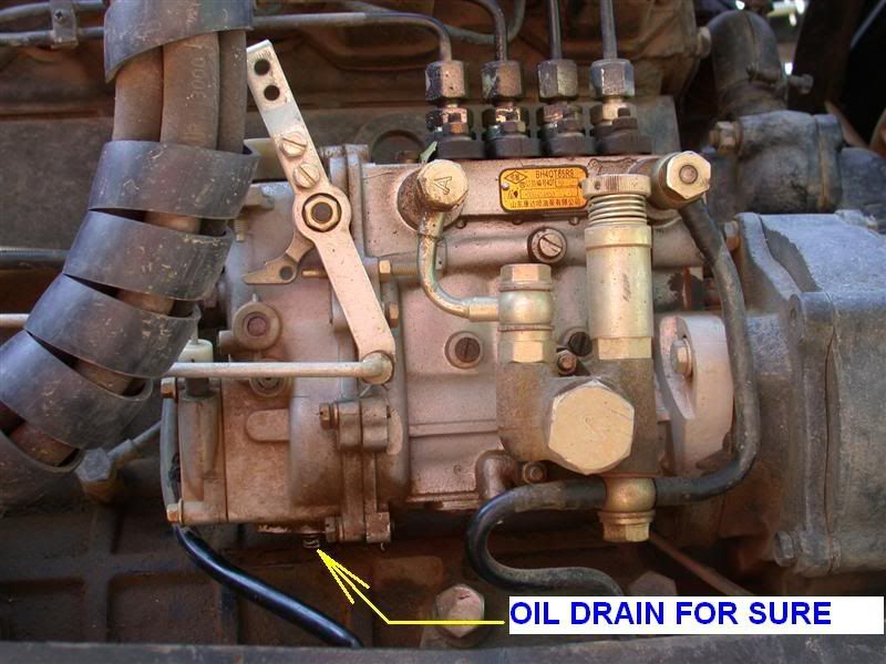

I have changed the injector pump oil several times now, using the suction method. My friend Brad told me there was a drain plug on the left bottom of the injector pump, which I had never noticed before because of the way the pump sits on the engine. But it's there. When I tried to drain from there the first time, diesel started gushing out so it startled me and I had second thoughts about that being the drain plug. I had not experienced the oil being diluted before,l but it was. Anyway, my recent visit to the property allowed me to check it once again, and indeed that plug is the drain on our Kama 554.
I marked a 12oz squeeze bottle at the 10oz spot and drained the oil from that plug. About 8-1/2 oz came out, but I noticed the little dipstick read it was on the low mark. So when I refilled, I put in 9oz of 15w40 Delo and squeezed it back in. Checking the dipstick, 9oz is the perfect amount for my injector pump.
