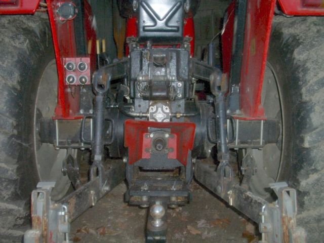

After reading all those safety threads I thought it might be a good idea to get a PTO shaft cover for my KAMA 554. Anyone know where I can get one? My tractor did not have one and my dealer and I are not getting along so good so he's no help. So I'm turning to you guys.

I'm not sure that I have either the PTO Shield not cover. This is not a very good picture with the boxblade brackets in the way, but you can see the rear of the tractor behind the brackets. Maybe you can tell me if there is a shield or cover....I don't think so.

It looks to me like you are missing the PTO shaft shield. Its purpose is safety. To help prevent a persons clothes, hair, etc get caught up in the rotating shaft and being injured or killed.

As for the KAMA PTO shield, you most likely will need to get it from your dealer. I don't think I have any extras, we get one with each tractor and one leaves on every tractor but I will check. The cover I have to offer is just a plactic cap that bolts to the four holes closes to the PTO shaft. Use a lot of caution, until, and even after, you install the shield.

It wouldn't be terribly difficult to make one. Use this photo for a guide, maybe you know somebody with a metal shop

Here's a picture of a handmade shield, just for an example. (I bought this off a VN 'rebuilt' Yanmar.)
This one should have been taller. I had to bend the upper part upward to attach a mower driveline.
A welding shop can look at Greg's photo and this one, and build a similar unit. Just take in a tracing of the attachment bolt holes.
