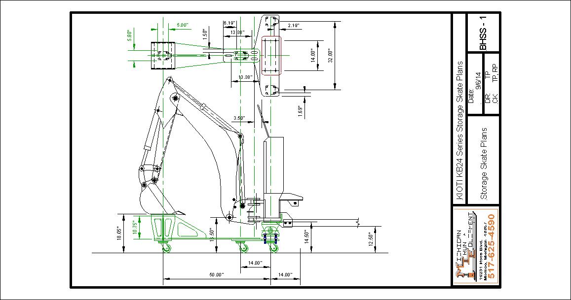

Hi everyone,
I've just finished a 20' x 22' storage barn for everything else I have around. My plan is to store the attachments not in use in it, namely the backhoe and loader during the winter; the snowblower and snowblade during the summer.
I saw a company that supplies backhoe storage cradles for Kubota backhoes; it allows you to wheel it about once it is off the tractor. Has anyone seen something similar for the KB2465?
I would like it to be able to move about on suitably sized steel castors so I can disconnect it in the middle of the barn, raise the outriggers, and roll it off to the back corner.
If any of the dealers out there have such an animal, please let me know.

Harbor freight has movers dollies that work fine. 4 on the corners and you can roll it all over the garage. Works fine if you have a concrete floor.
   / KB2465 storage cradle #5

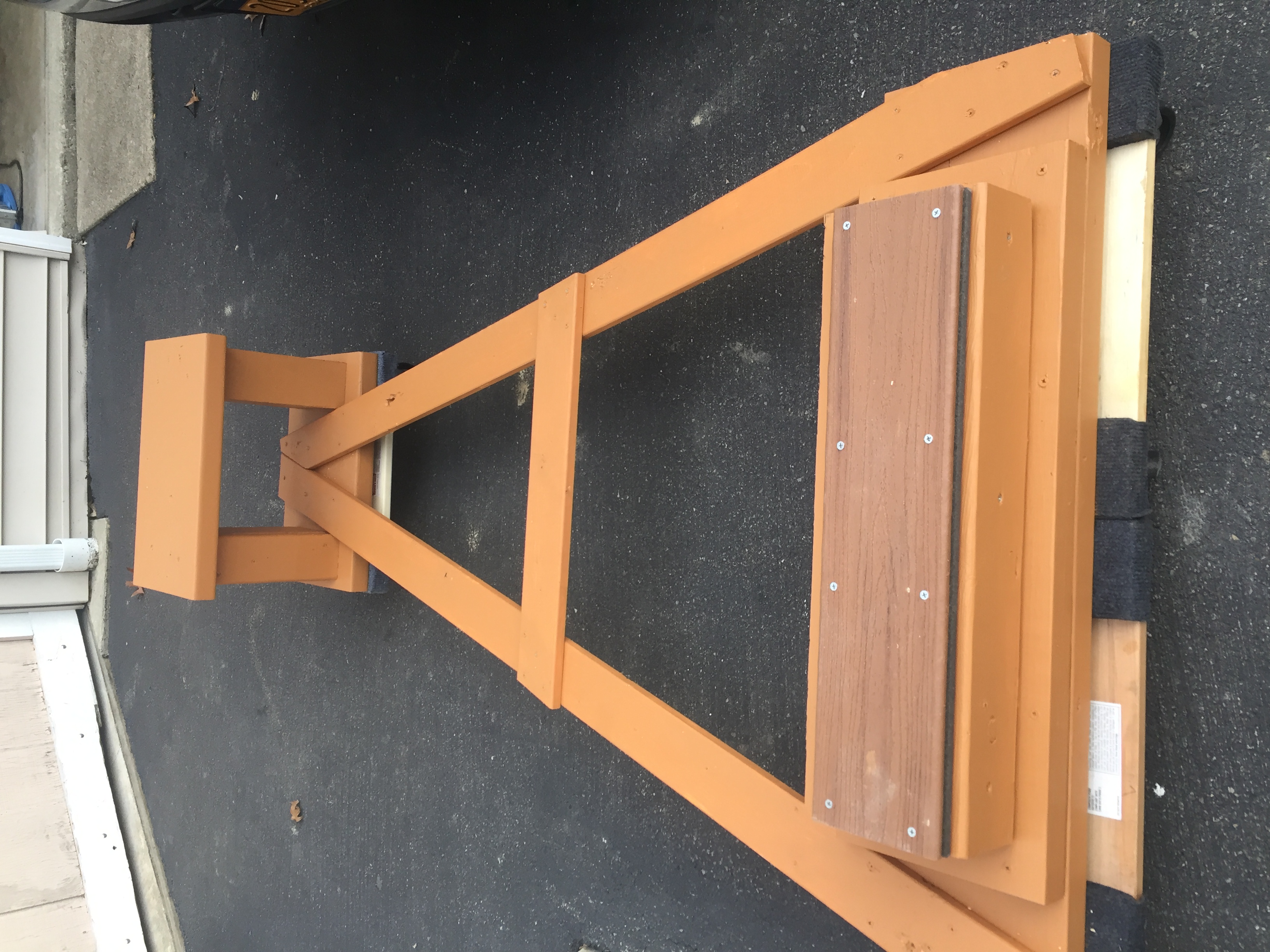

Anybody have plans for that storage cradle? I just bought 4 harbor dollies and ready to build! 7.99 each!
   / KB2465 storage cradle #6
Here is a picture of a Storage Skate design we developed and used for a couple customers requesting the same type of solution.
   / KB2465 storage cradle #8
