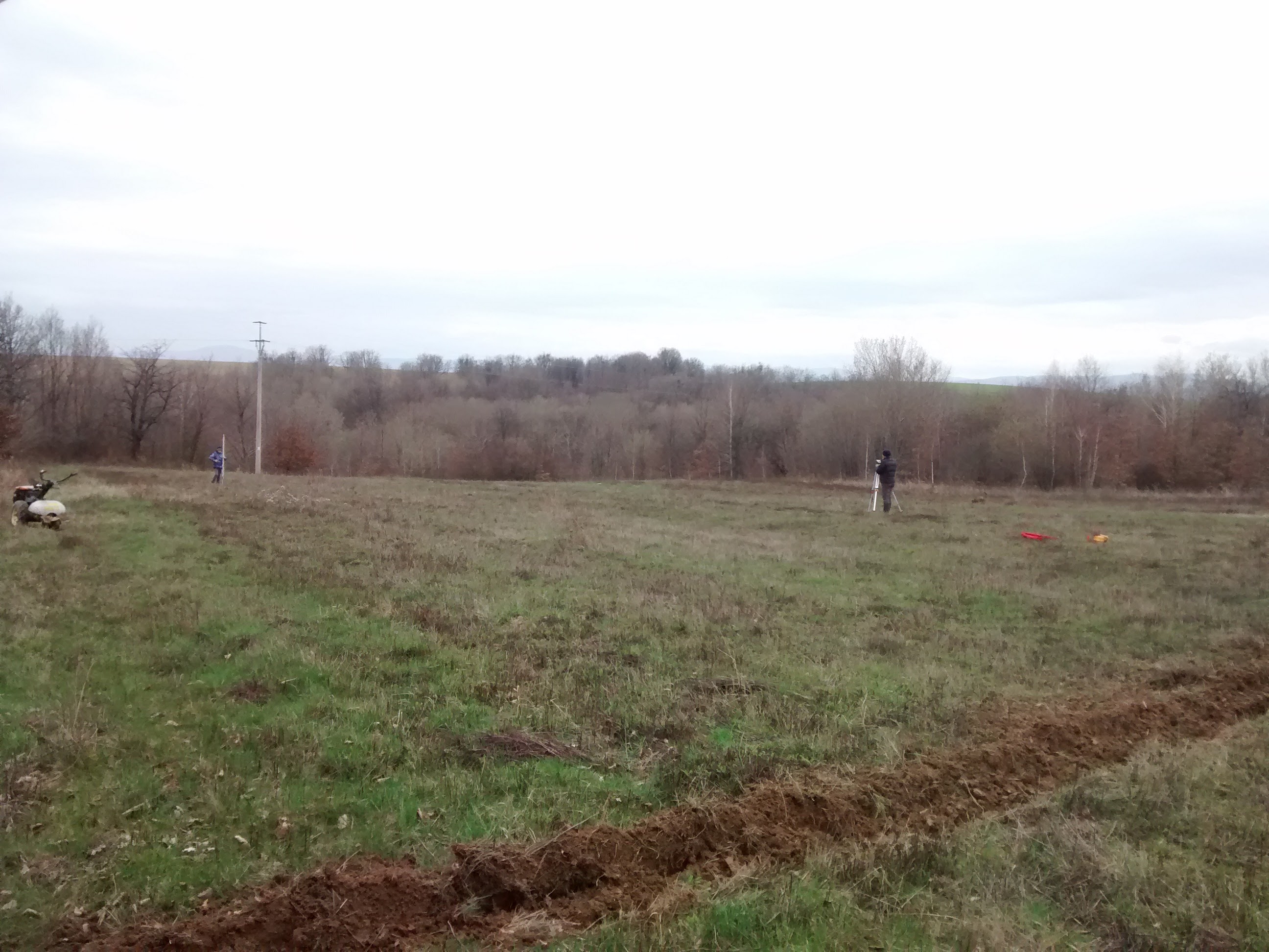

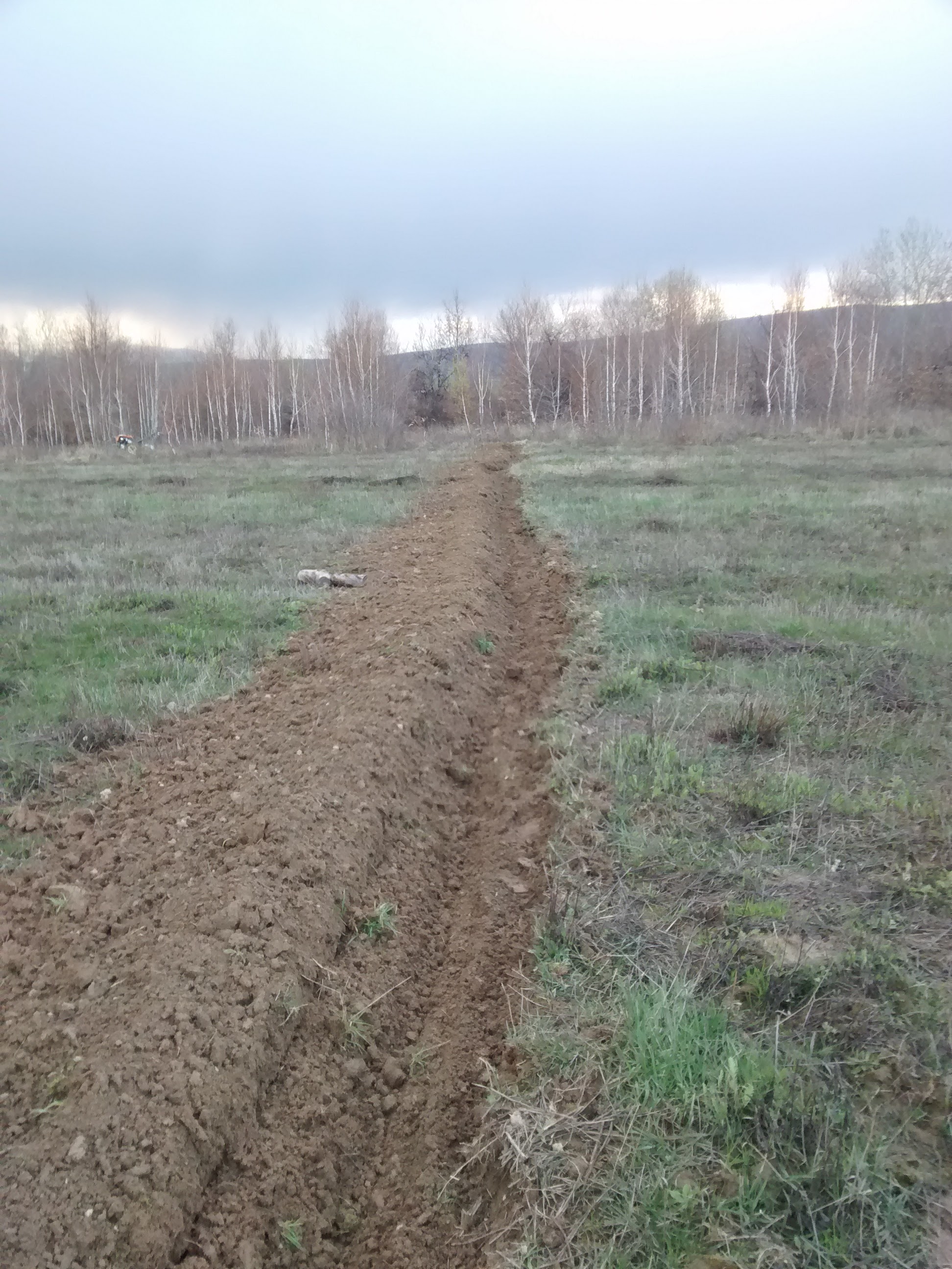

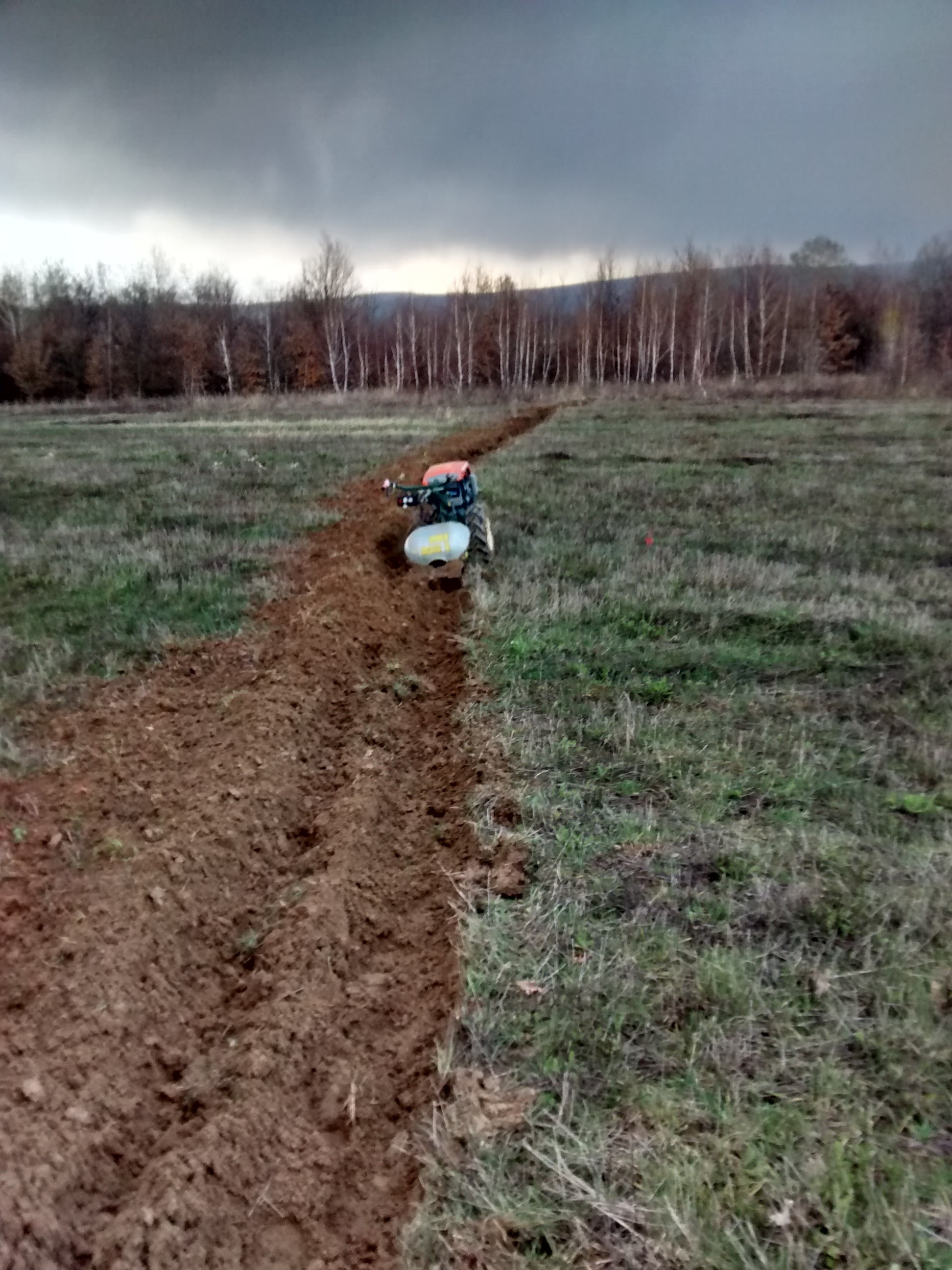

So I just made swales on contour with the rotary plow a couple of weeks ago. But my field is just 5 acres. I didn't keyline though, the slope doesn't have any ridge-valley sort of feature visible over the 80 yard width of the field, so mine are just to keep the water from flowing down and away. They are spaced 20 - 30 yards apart, and I'll be planting trees and bushes on the down slope side of the swales.

Here are some photos of my swale / mini-swale making. It took 4 passes with the rotary plow, and I plan when it is drier to build up the high part more. I can't say how much the swales will help or how effective the present depth (about 12" from bottom of "ditch" to top of soil pile on downslope side). I'm still refining my "technique" at making the swales as well...
