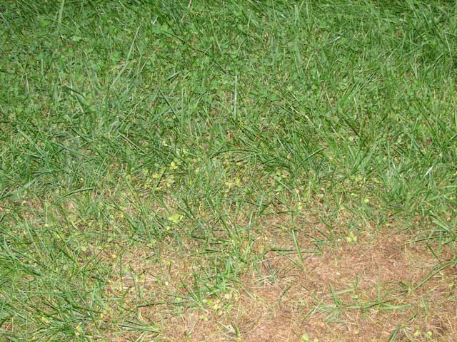

I just sprayed a Dow product - I'll have to look up the name. It was $200 for a gallon of concentrate at the Local LESCO -treats 3+ acres depending on concentration. I worked like a charm - better living thru Chemistry.
   / Killing clover in lawn #7
It was spotlight
Here's a pic where I didn't get close enough to the fence. The bare spot is where the clover once grew

Pilot - with the spotlight I saw results in days (yellowing) - It was completely gone (bare spots) in 2 weeks.
