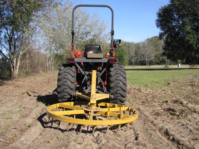

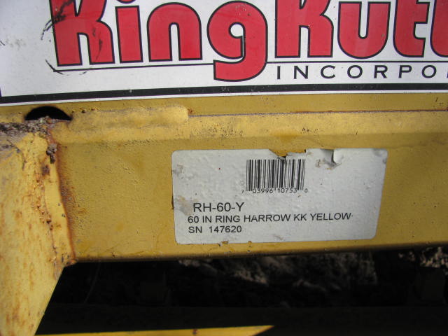

Photo #1 I purchased this 60" King Kutter Rotary Harrow from Everything Attachments, Newton, N.C., during July 2012. It was purchased new-old-stock at reduced price of $799, delivered. The paint is faded but all important pivot bearings are perfect.

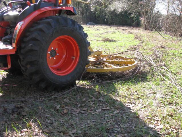

Photo #2 After loading on the the 3-Pt. hitch harrow is adjusted as follows: Lower harrow RIGHT arc by lengthening right threaded lifting rod until spikes 1-2" into the dirt. LEFT arc spikes should be slightly ABOVE dirt.
Fore and aft adjustment via top link is less cut and dried. Most often front arc is adjusted so spikes enter dirt about 1-1/2" to move dirt to right and pull weeds. Rear arc is 1-1/2" above dirt so loose material can pass under. Rotary harrow will occasionally windrow accumulated trash. See photos #3-#4-#5.
For final smoothing of a seed bed front arc is set a 3/4" higher than rear. Therefore front arc smooths lumps initially, followed by a second smoothing by rear arc, which is slightly lower than front arc. Harrow nearly level left-to-right.
Photo #3 + #4 + #5 As tractor moves forward, engaged ground-powered spikes on RIGHT arc move to rear; unengaged spikes on LEFT arc move forward, pushing dirt forward and to the right.

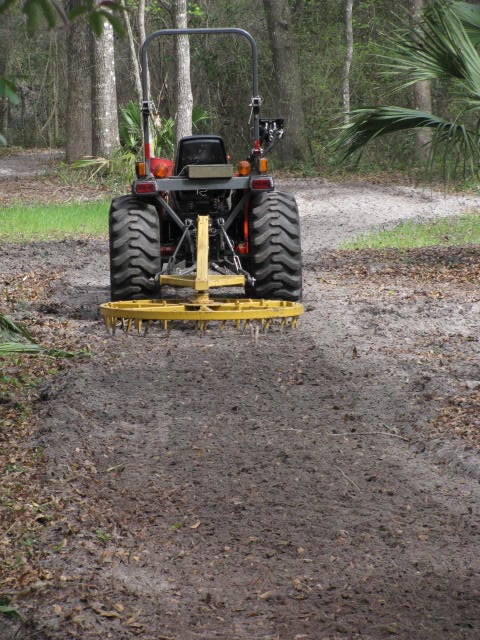

Florida woodland trail grooming photos from today.
Trail surface first chopped with Howse 600 pound disc harrow, notched discs fore and aft.
ETA Cultipacker was run over it several times.
King Kutter Rotary Harrow adjusted for fine smoothing; front 1/2" higher than rear. Harrow removed crown, smoothed surface.
Result: Hard packed dirt base, 1-1/2" soft dirt on surface, all trash removed. Will firm after a rain.
A good exercise path for Seniors in our community, easy on the knees, minimal trash to trip over.
Trail crosses several deer food plots.
