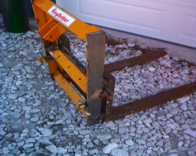

Take 1 King Kutter carryall (slightly bent), 10 feet of 3/8" x 3" steel, some 1" thick scrap, some old forks, and a beautiful Sunday afternoon....
   / King Kutter carryall --->Pallet Fork
#2
Here's how it started....

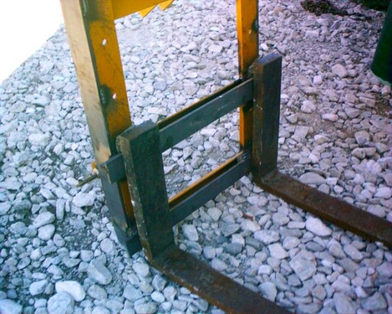

And now it's actually a useful piece of equipment!

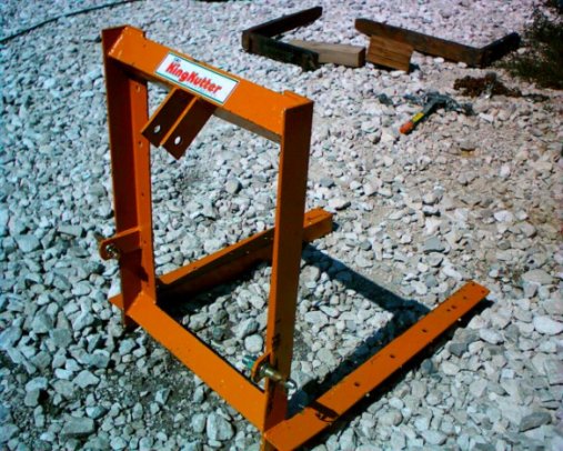

Another angle

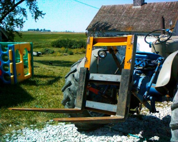

Ready to go to work (after some paint)
