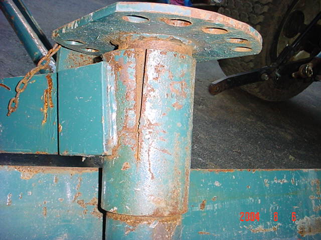

Last week I was doing some site work for a friend using my 6 foot KK grader blade. I was backing up when my friend asked if I knew my bracket was cracked. Here is a nice shot of it. There is also another split near the bottom on the left that goes around the left side unde the frame. Both sides of the pipe near the top have weld cracks also. I did manage to sqeeze it back together and weld it all up again. This blade was not made to be used in reverse. I was only pushing 3/4 stone with it. The pipe they use is very mild steel and can be mangled pretty easily. The blade did not sustain any damage of any kind. This tells me that the round pipe on the bracket is of inferior quality.

Yikes.
I've seen a few grader blades i wouldn't put on my tractor either. I like some of the older solid designs.. sometimes hard to find HD stuff. Any change the welds were bad or already broke?

I think the split in the tube was already there and hidden by paint. The crack is (was well rusted). The same may be for the weld cracks also. I also welded up the cracked welds around the grader blade post in two places on the right side where the post is attached to it. The paint was cracked and I assumed the weld had cracked also. I just laid a heavy bead all over the place on this.

Fortunately for me this came with my tractor for free. I do understand that the cheaper the item the cheaper the quality. A simple band of 1/4" steel tubing around the upper section would not have been too hard to install while building this unit. That would have just about made it indestructable. I will re-engineer it if I have anymore problems with it. This is the weak link on the whole unit.

Different rear blade but I've had several breaks on the same piece you showed.
