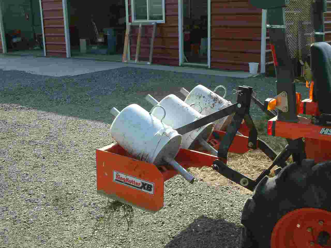

I have a 4-ft KK XB box blade. Way too lightweight for serious stuff like scraping turf. So I have three 120-lb concrete weights to help out.

My XB BB only has about 3/4" of the front cutting edge below the bottom of the side plates (I removed the rear blade). I plan to cut about 3/4" off the bottom of these plates later this year when the rainy season arrives (Nov-May) and I get serious about installing a new lawn. Hope exposing more of the front cutting blade will make the thing work better for turf removal.
