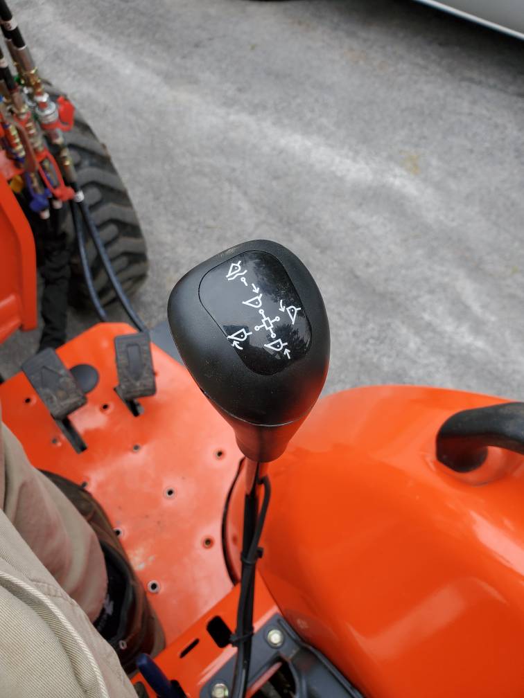

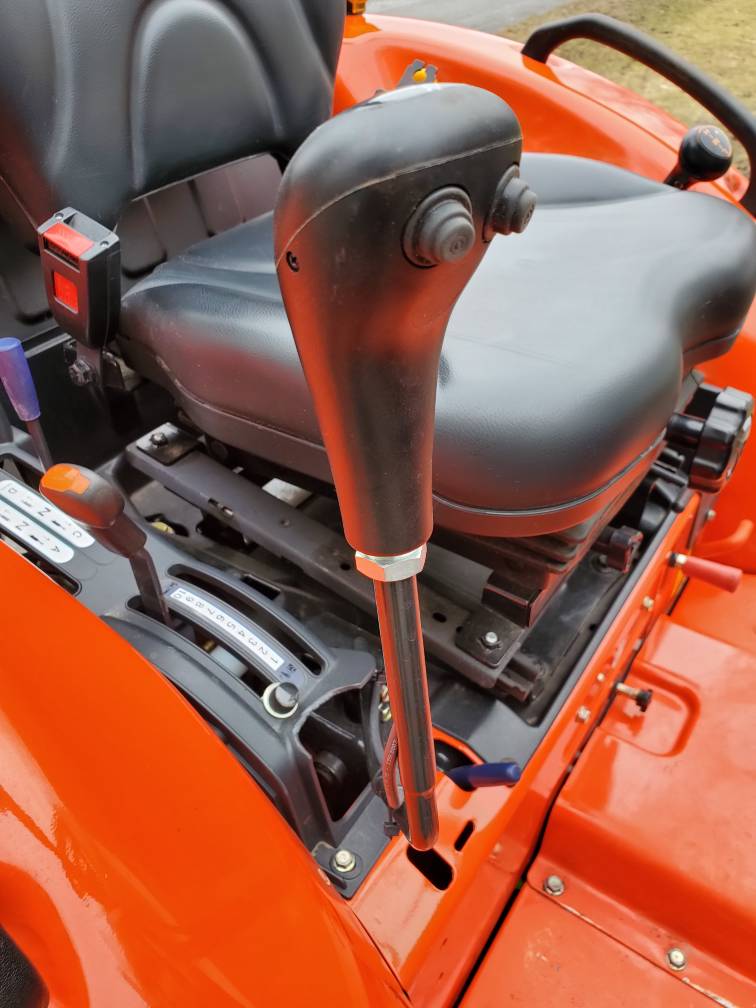

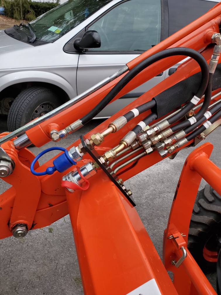

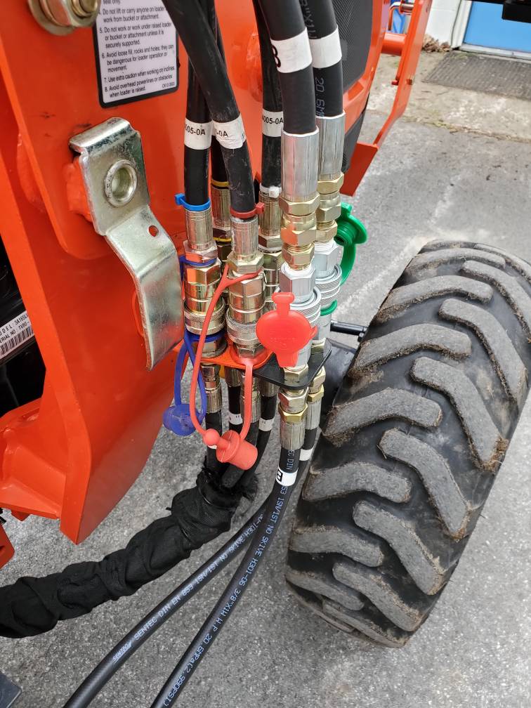

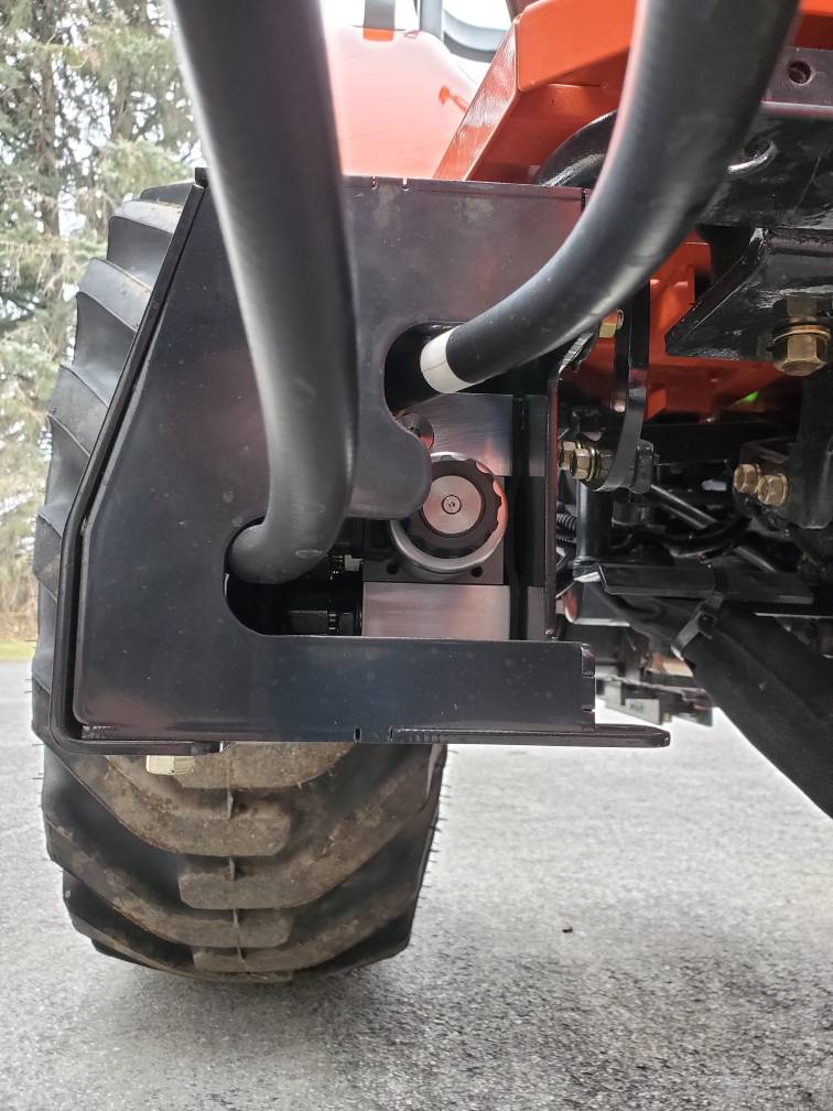

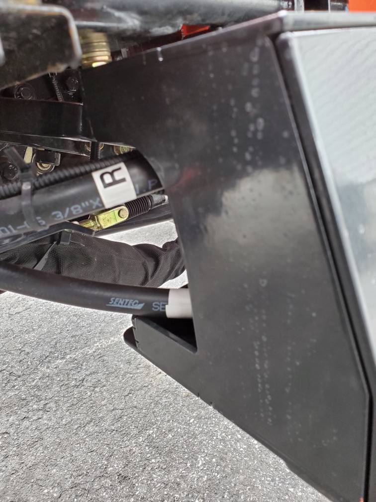

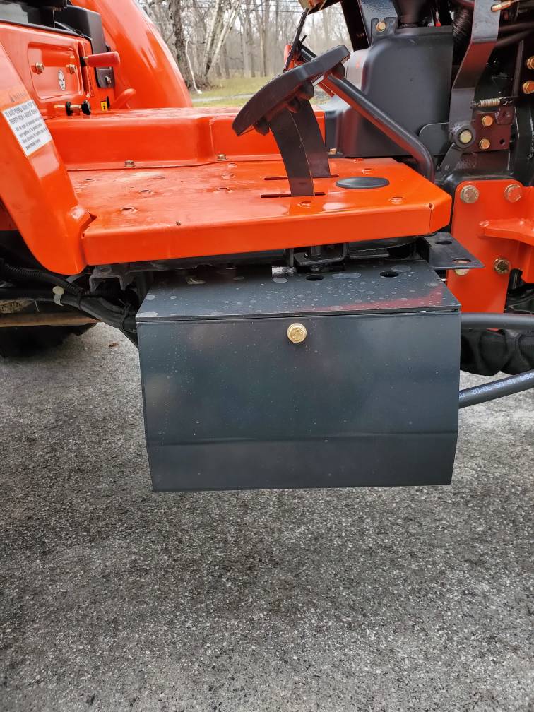

I just had my dealer install a Kioti 3rd function remote on my CK2610 HST.
I ordered a Wicked 55 a couple weeks ago from Everything Attachments and needed a 3rd function remote installed. I did quite a bit of research on them but couldn't decide which one to get. I called my dealer to have him install a pair of rear remotes and I asked him if Kioti has a 3rd function kit. He looked it up and they did. Apparently it's made by the company that makes the FEL. I decided to have him order it and install it while he had the tractor apart installing the rear remotes.
They just dropped it off this morning and it looks great. It looks to be well protected with a shield covering the new valve.
I don't have anything to attach yet but as soon as I do I'll let you know how it works.
For those of you wondering what the Kioti 3rd function remote looks like here's some pics. 20190405_104047.jpg20190405_103905.jpg20190405_103922.jpg20190405_104008.jpg20190405_104000.jpg20190405_103915.jpg20190405_103938.jpg

Thats great! I'm currently going through the same thing, my dealer just researched this for me and sent me some crappy pics. Its nice to see all parts involved with nice pics. Appreciated it.
Are you able to say what you payed for it installed? I got quoted 1300-1500, he said he wasnt sure...not sure if they never installed one or what, or if he wasnt sure on the service side.
Thanks!

That sounds high. I bought a Case IH Farmall 125a & wanted the 3rd function. They wanted $1000 installed.
The kit was $550. I got them to throw it in with deal & I installed it myself.
It took me about 30 minutes to install it.
Had to remove a couple plugs from the valve, route 2 hoses & the wire harness to the quick attach. Actually really simple.
This is the only one I have ever installed so I'm sure others may be more difficult.

The part with the valve mount kit was $768. Install was 3 hours but I also had him install the Kioti 4 port rear remotes for $420. Total was
$1,445 for both installed so your dealer is high but since it's new and he probably hasn't done it before he's probably estimating higher.

Oops I misread. I have DK10se cab series. For some reason I read yours as the same...still, Kioti has one. This would maybe just be a bigger version, higher gpm
   / Kioti 3rd Function Remote
Yeah I would bet it is. My dealer said they are specific for the FEL model.
