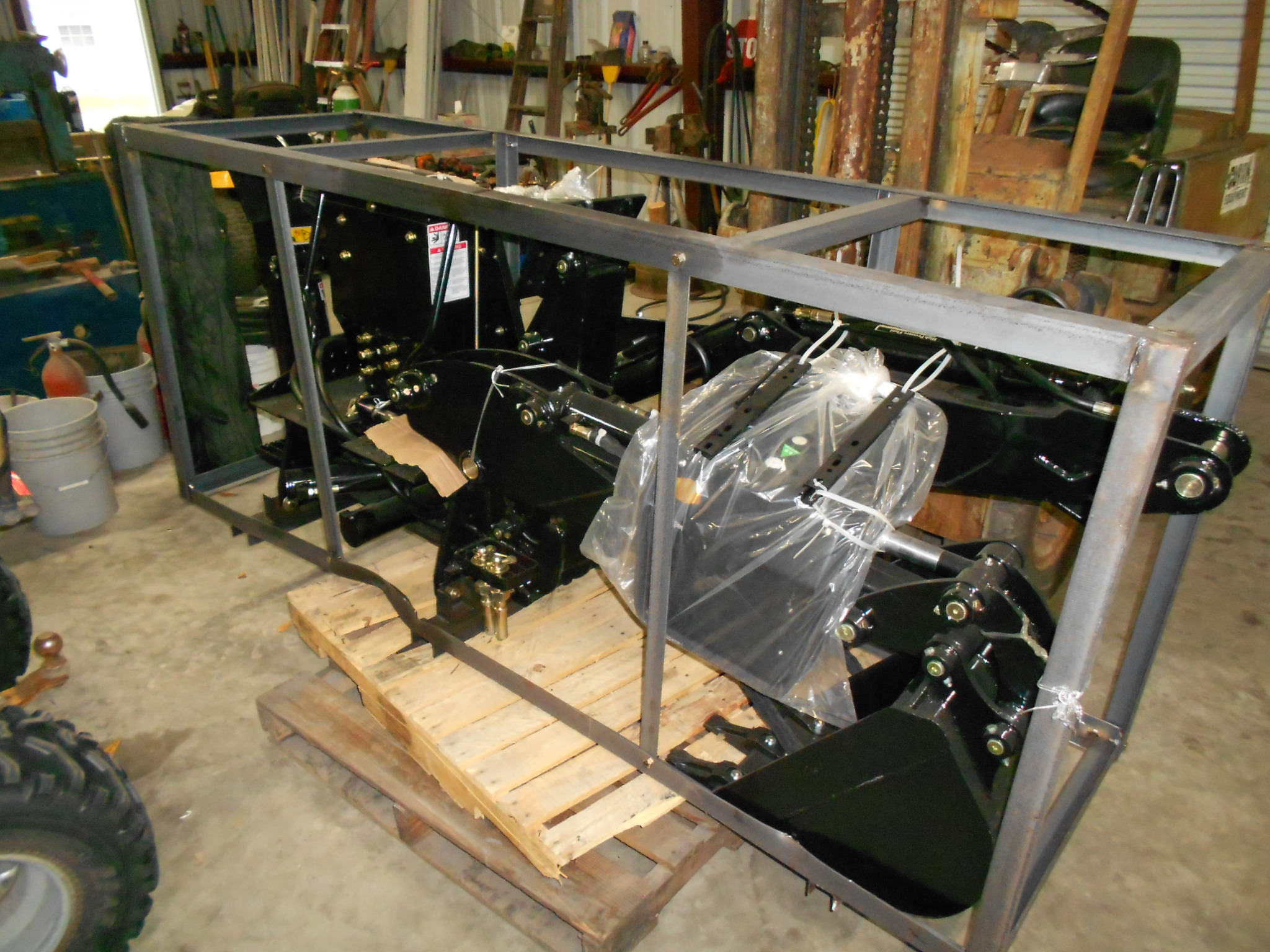

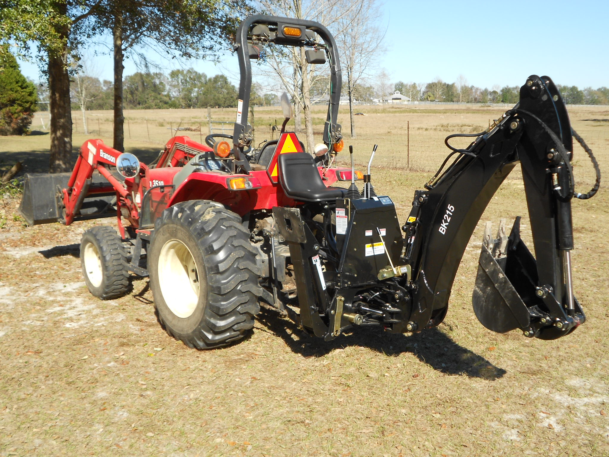

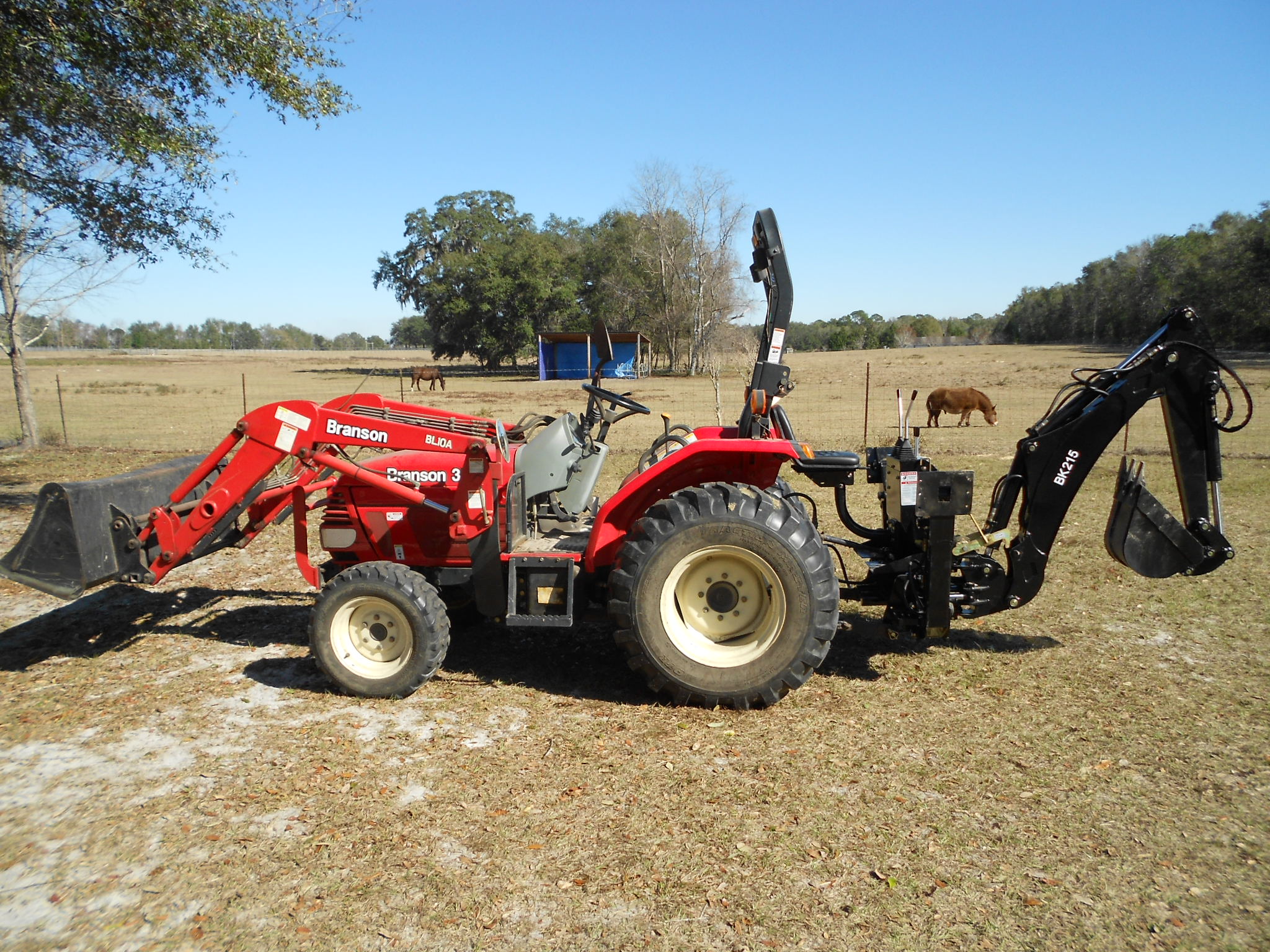

Watched the video and that hoe is available in generic form from Titan Attachments - PalletForks.com - 8-65-8241.
I bought one first of the year, see pic.
It doesn't come with the sub-frame which you should have.
I made my own sub-frame for my 3510 Branson.
