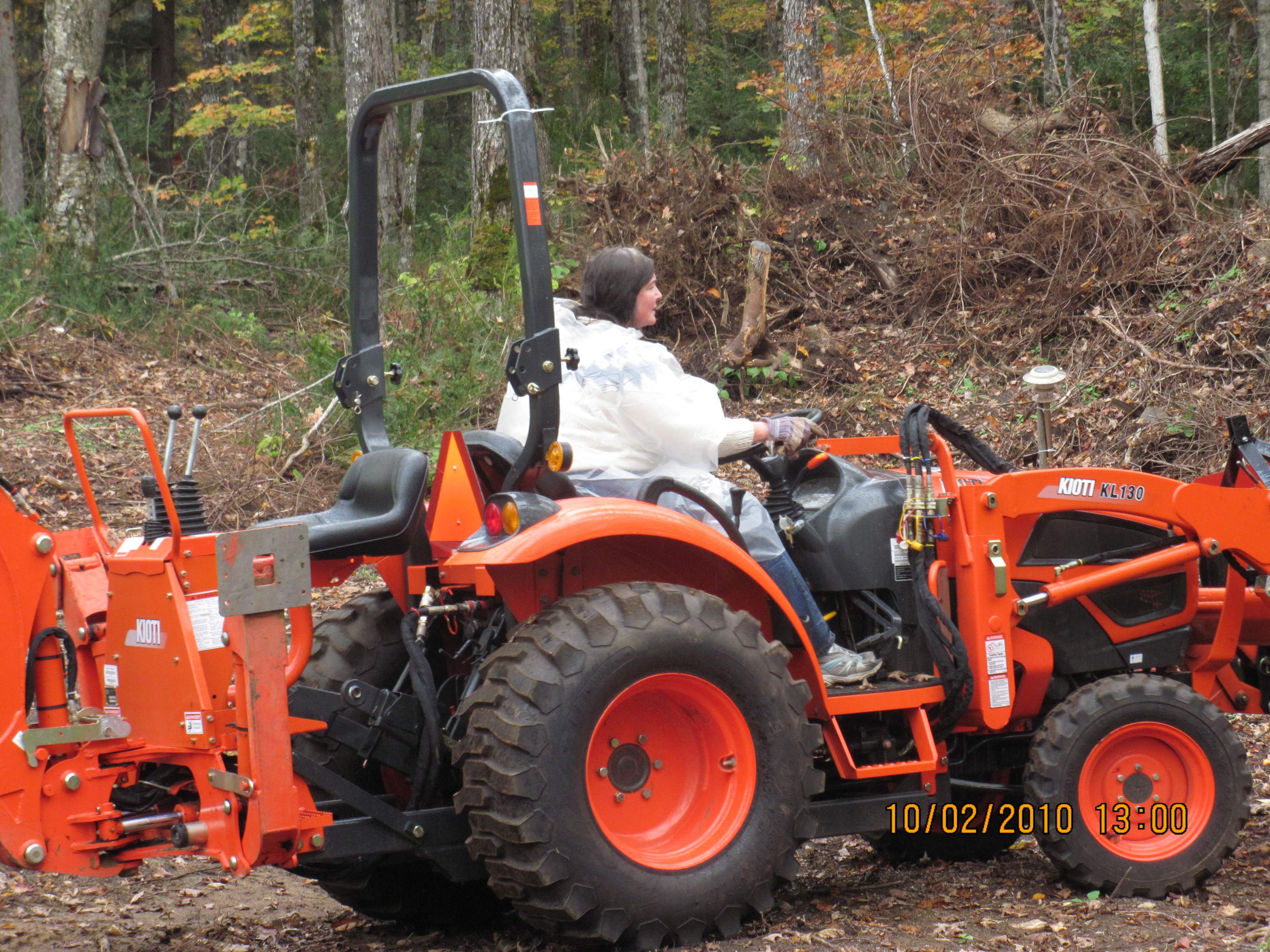

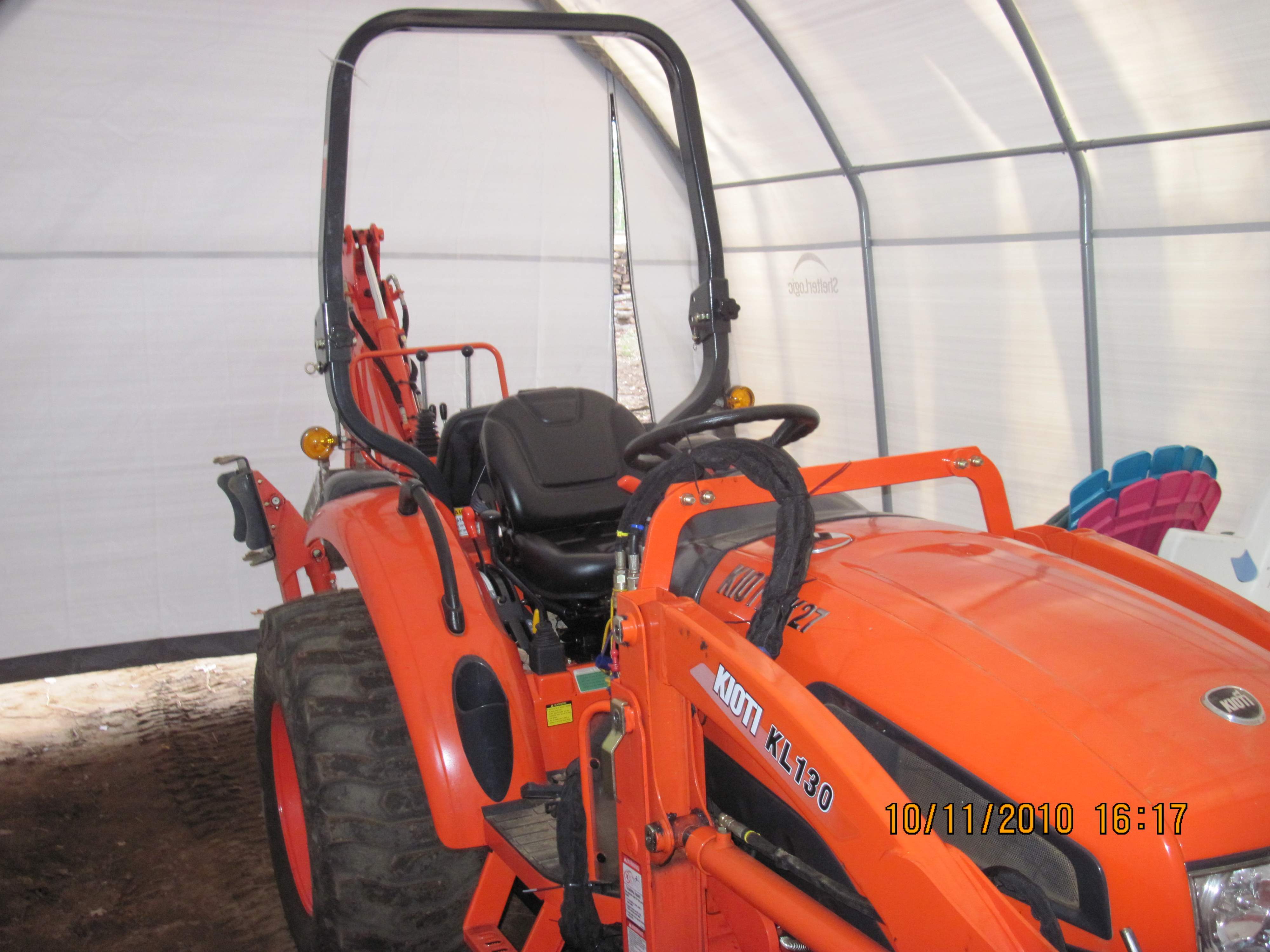

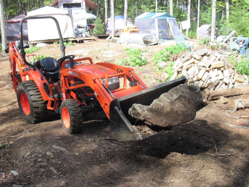

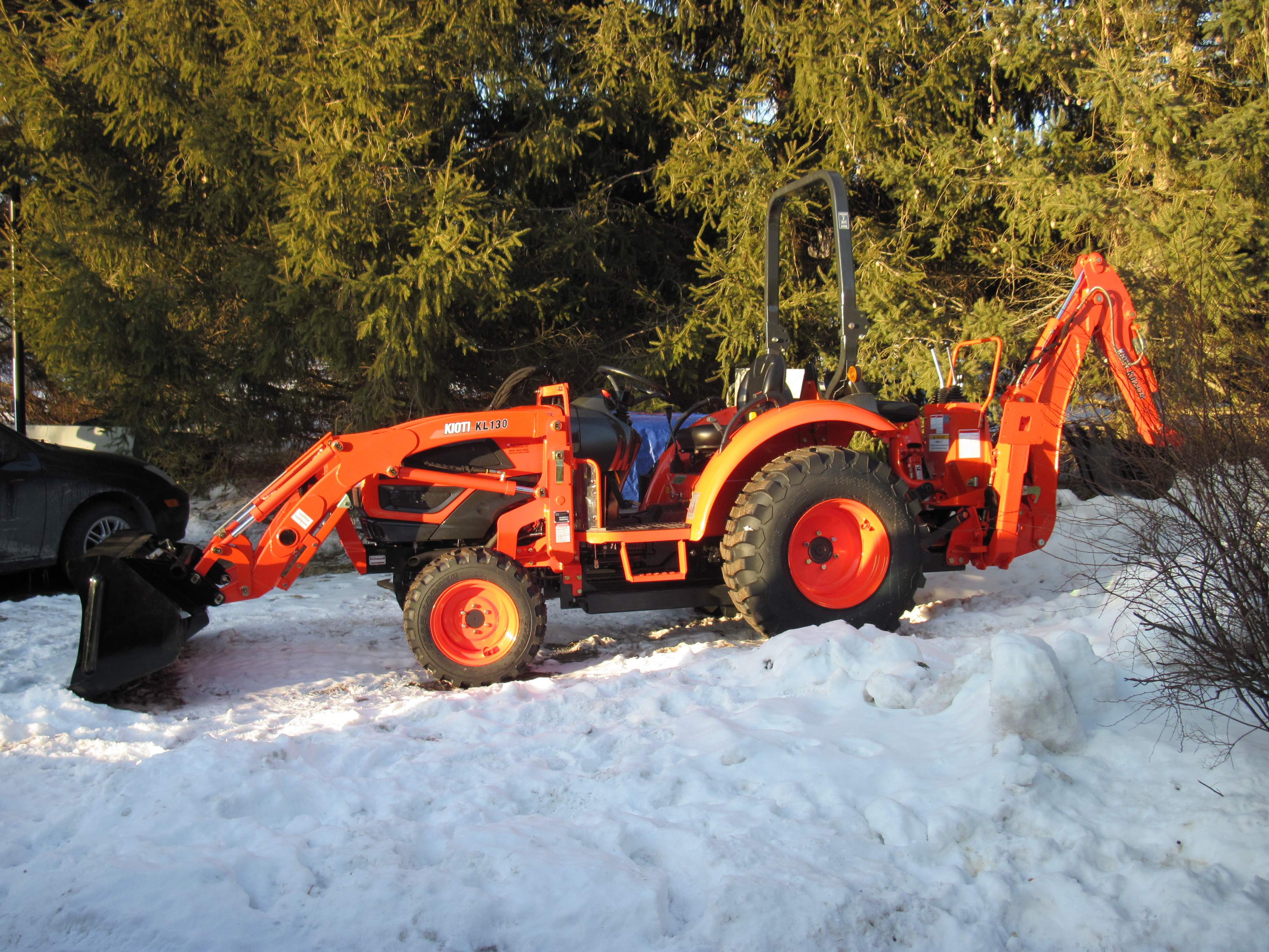

I have a CK27HST, and 14k with 150 hour is very resonable, it's a very capable tractor, I have a front end loader and backhoe, and it has done evrything I have asked of it so far. had one Hydraulic hose leak on FEL replaced under warranty. In Low range I can pull anything I have tried, and climbed some steep inclines on the property.:)
   / Kioti ck 20s hst ck27hst
Thanks mx. I'm hoping to see the trac tomorrow. How many hours on yours? Any pics I can see?
Thanks
Matt
   / Kioti ck 20s hst ck27hst #5
If memory serve me right around 72 hours, I really like the way I can take a stump out in hours that would take the hole weekend nearly killing me, I now enjoy removing stumps now.:)My wife like driving it to move and pile firewood.:thumbsup:That rock was very heavy, use side of hill and forward motion and fel to get it off the ground to move. It's now sleeping for the winter under its own tarp building.
