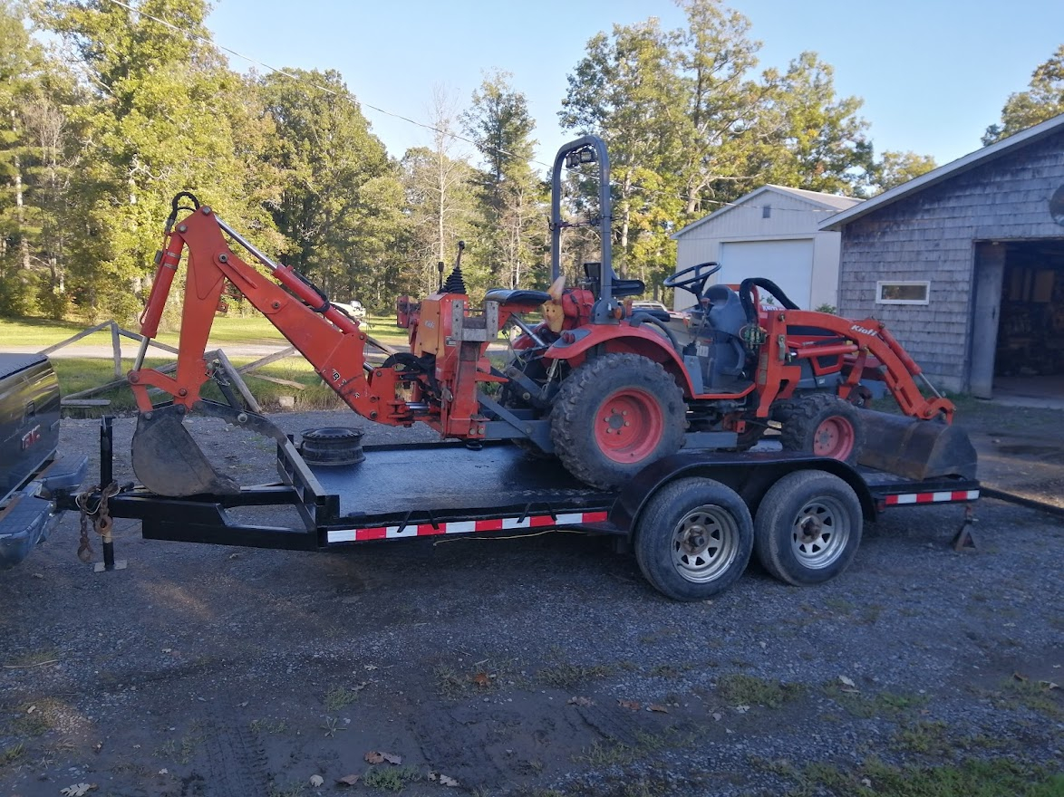

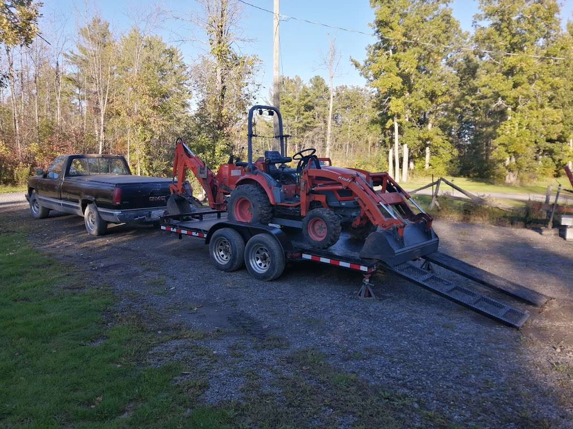

Hello guys I have a 2005 ck20 manual shift but it has no high low range selector . Looks like it was never installed but I think see where it was suppose to mount and there isn't even a mark to show there was even a lever attached to it . Why would it not have one. Would any of you have the ability to take photos of your high low shift lever and how it connects to the trans so I can possibly make one or purchace one . I have looked for an answer to the problem online called dealerships no one has an answer for me. The dealers say my machine doesn't come with one but the manual say it does . The machine is old but only has 500 hrs on it or at least it did when I bought it . I have put 200 more on since I bought it with no issues other than this .

Do you think you could post some pictures of the operators platform?
Looking at TractorHouse it looks to have a two-range transmission, so I don't know what your dealer was on about.

Thank you for your response. It made me challenge my local dealers to find the solution to my high low range selector issues. I had absolutely no help at all here in ont Canada from my kioti reps. Even kioti themselves. Finally I got and answer from down in Pennsylvania. I'll post there name when the parts arrive. The previous owner apparently never greased or lubed the high low Range pivoted points and they were seized solid. No movement at all I managed to force the lever at the transition off of the pin without any damage. Cleaned up the pin and the lever drilled a hole in the lever mount and added a grease fitting. Put it back to gether now I have high and low range that I can shift by hand without the shift lever. Low gears work excellent now I will be able to brush hog with low gears. So I won't be racing through the woods anymore brush hogging. Loved this little tractor and its power in high gears gonna love it even more in low. Now it's a little tank. To bad I could not get any answers to my problem here in Ontario Canada from any of the kioti dealers or kioti themselves.
