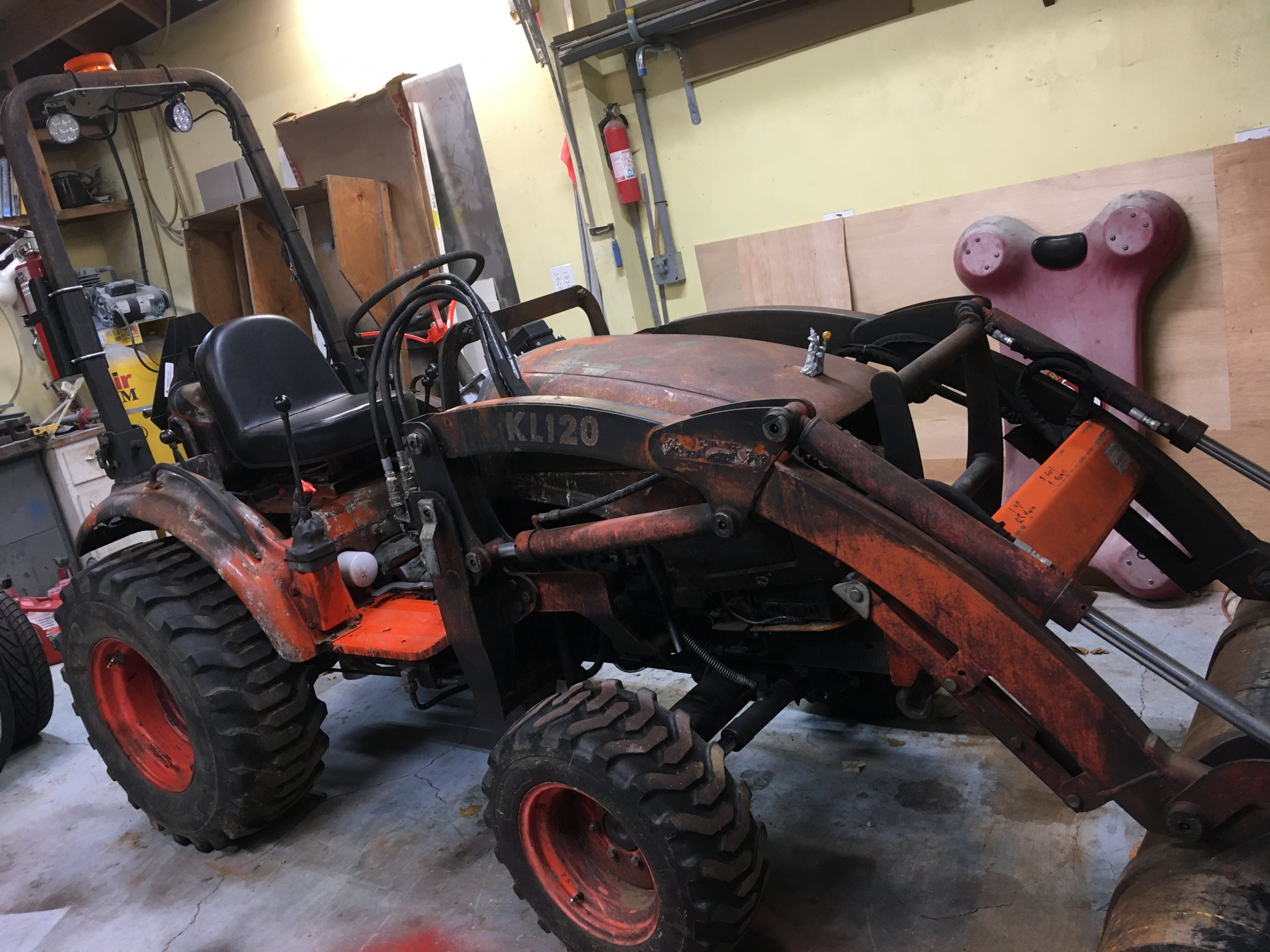

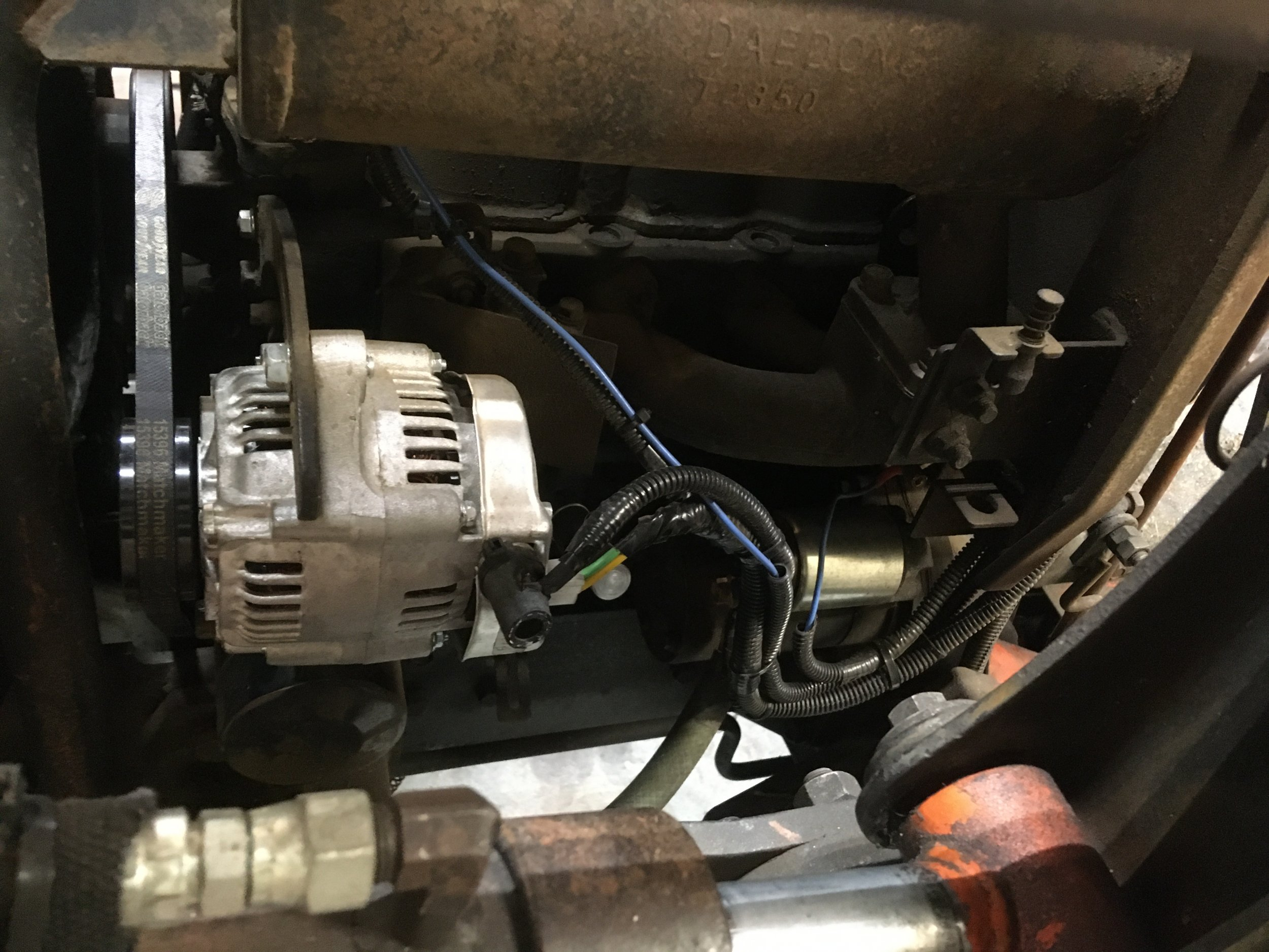

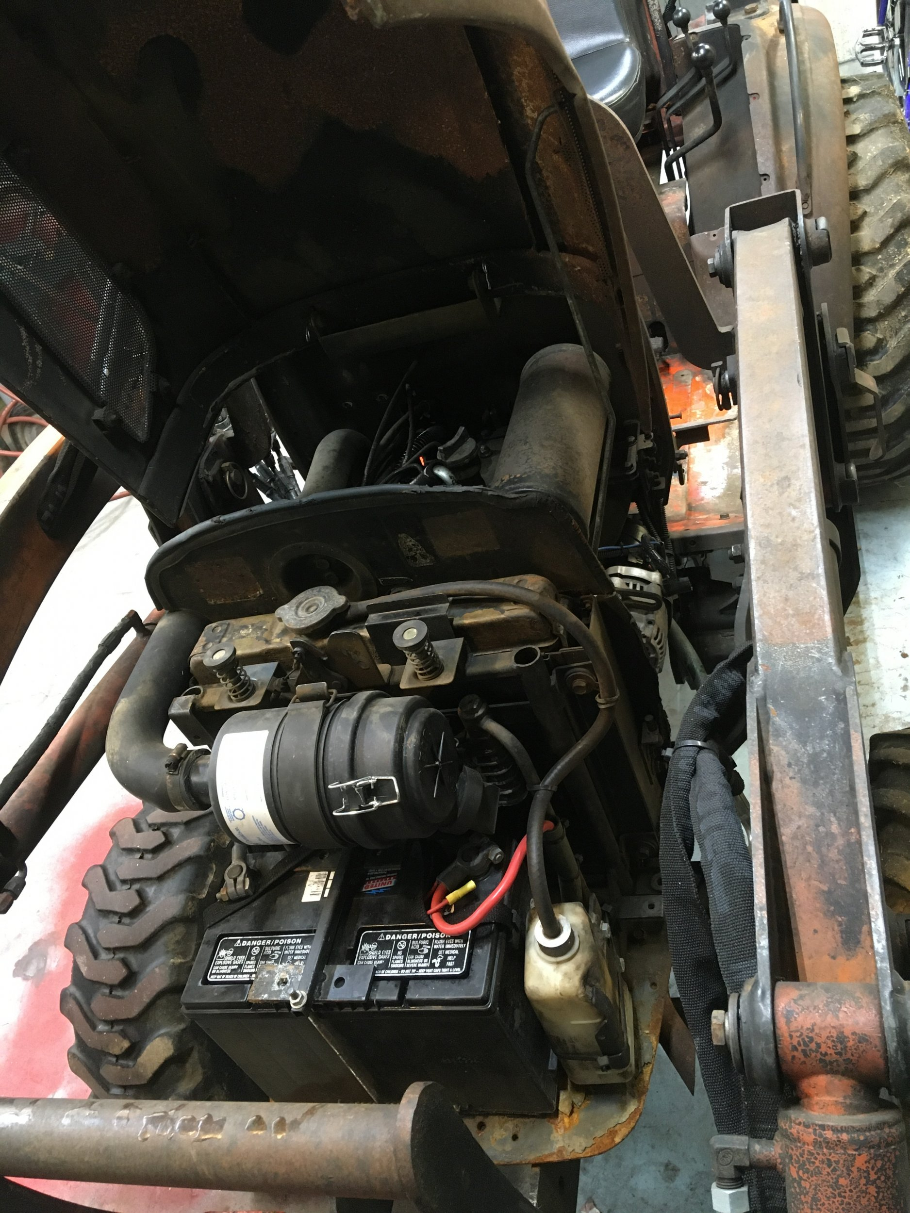

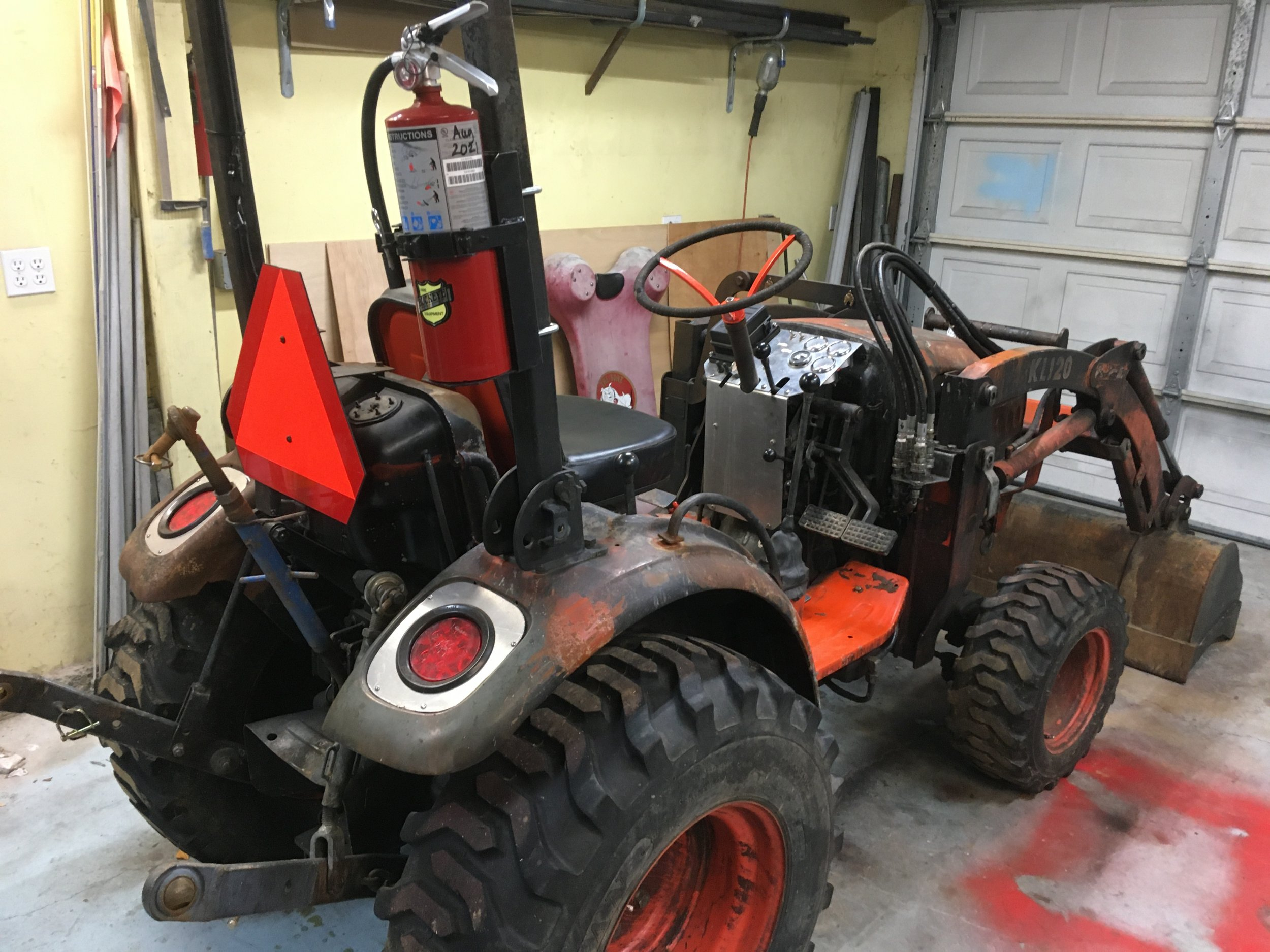

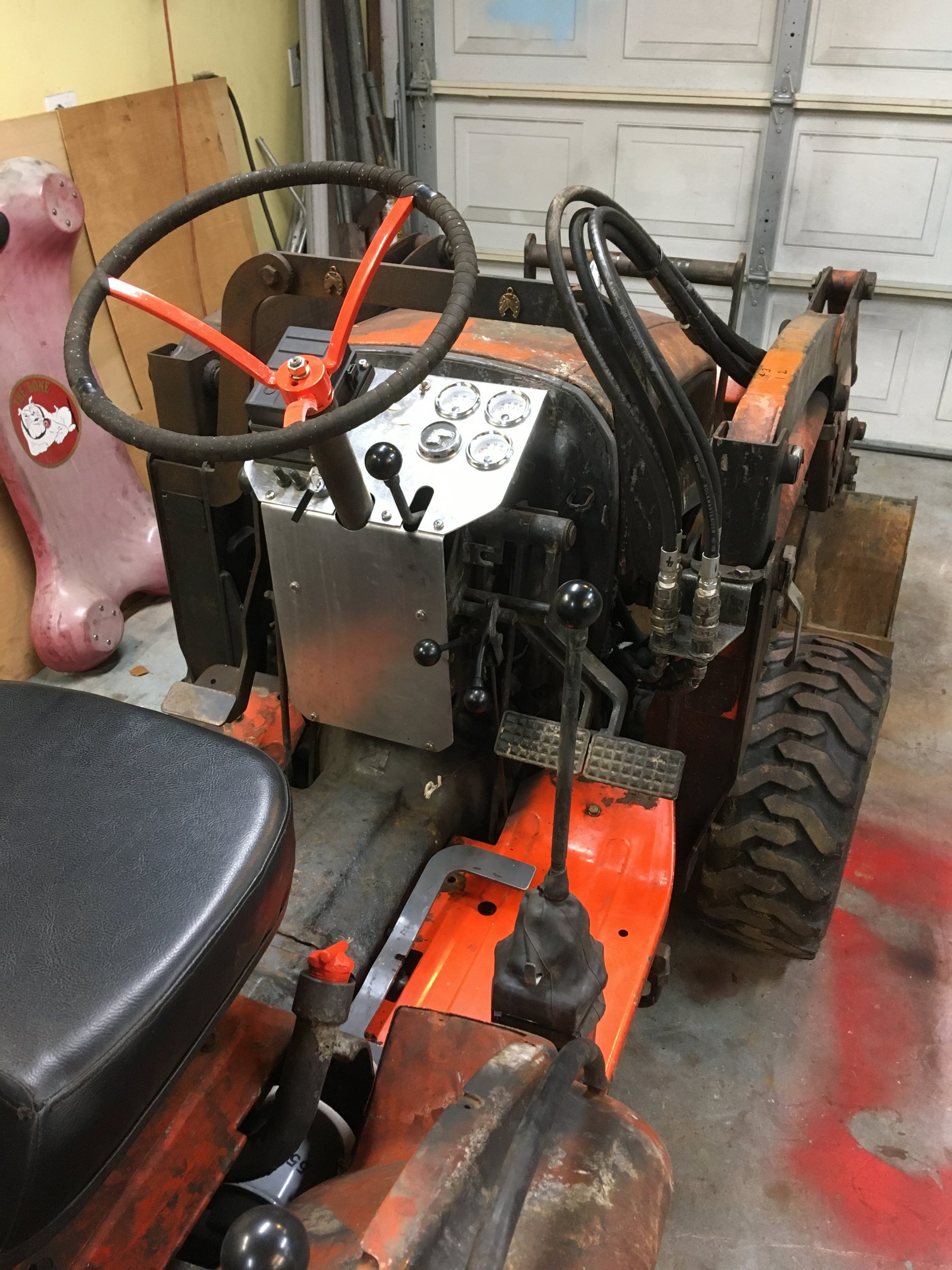

Here's a few pics as it sits today, i'm not going to paint it, just fixing what it needs to get to work! We bought a 12 acre little farm and i've done some mowing and spreading of gravel so far. I really am having fun with this as i work the bugs out.
First crack at the oil level was based on factory fill spec and marking the stick. I suspect i'm a little overfilled though. I'm getting oil out of the vent tube, and after an hour of mowing i had the oil pressure drop way down.... So i dropped the oil pan yesterday to check for crud in the pickup screen, but its clean. Thought about changing the oil pressure relief valve but the forward frame blocks access, and it would be a big job. New oil now set a half inch lower and i get good oil pressure running until warm in the garage... im hoping my issue had to do with overfilling/ windage/foaming leading to drop in pressure
