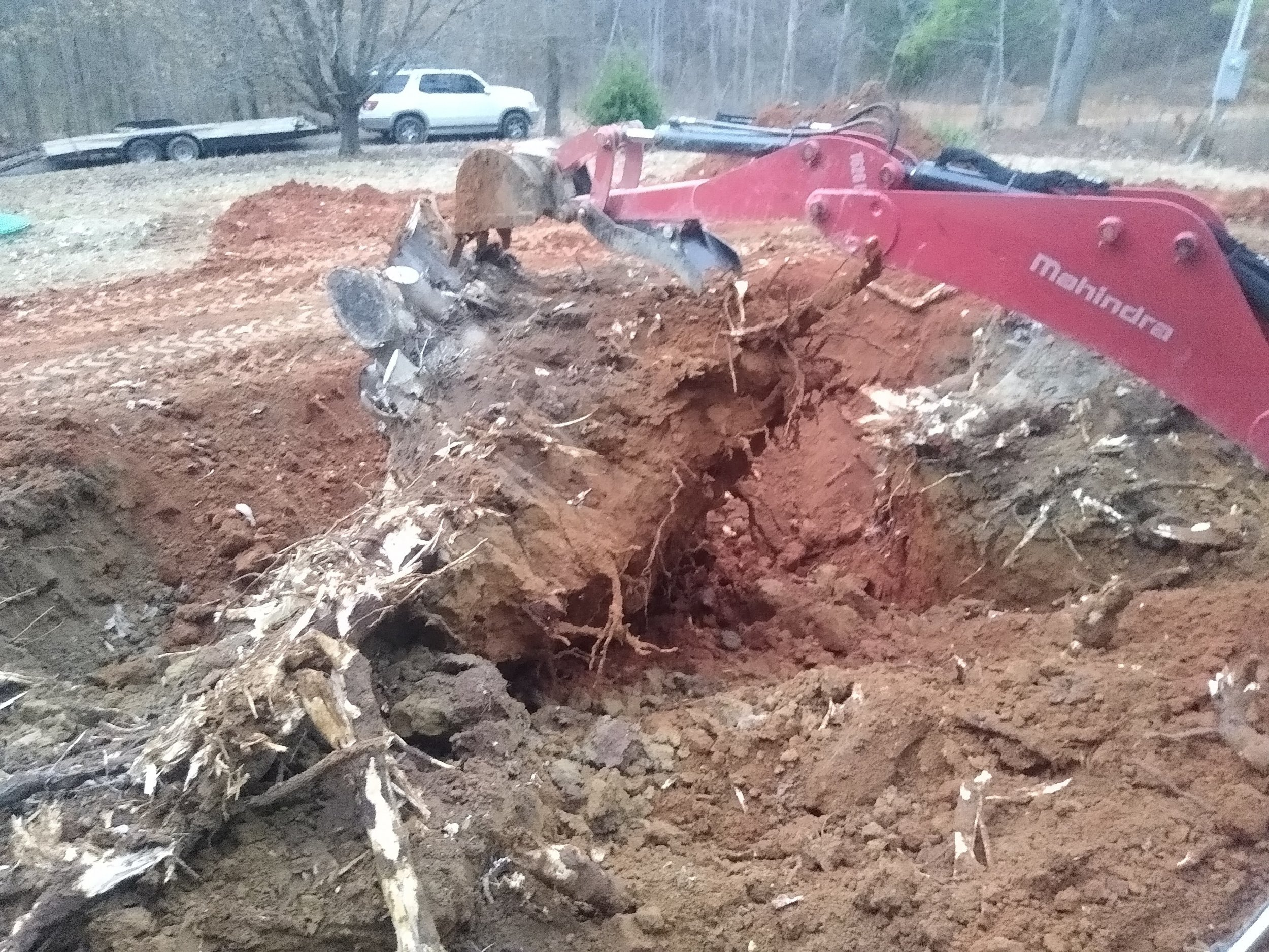

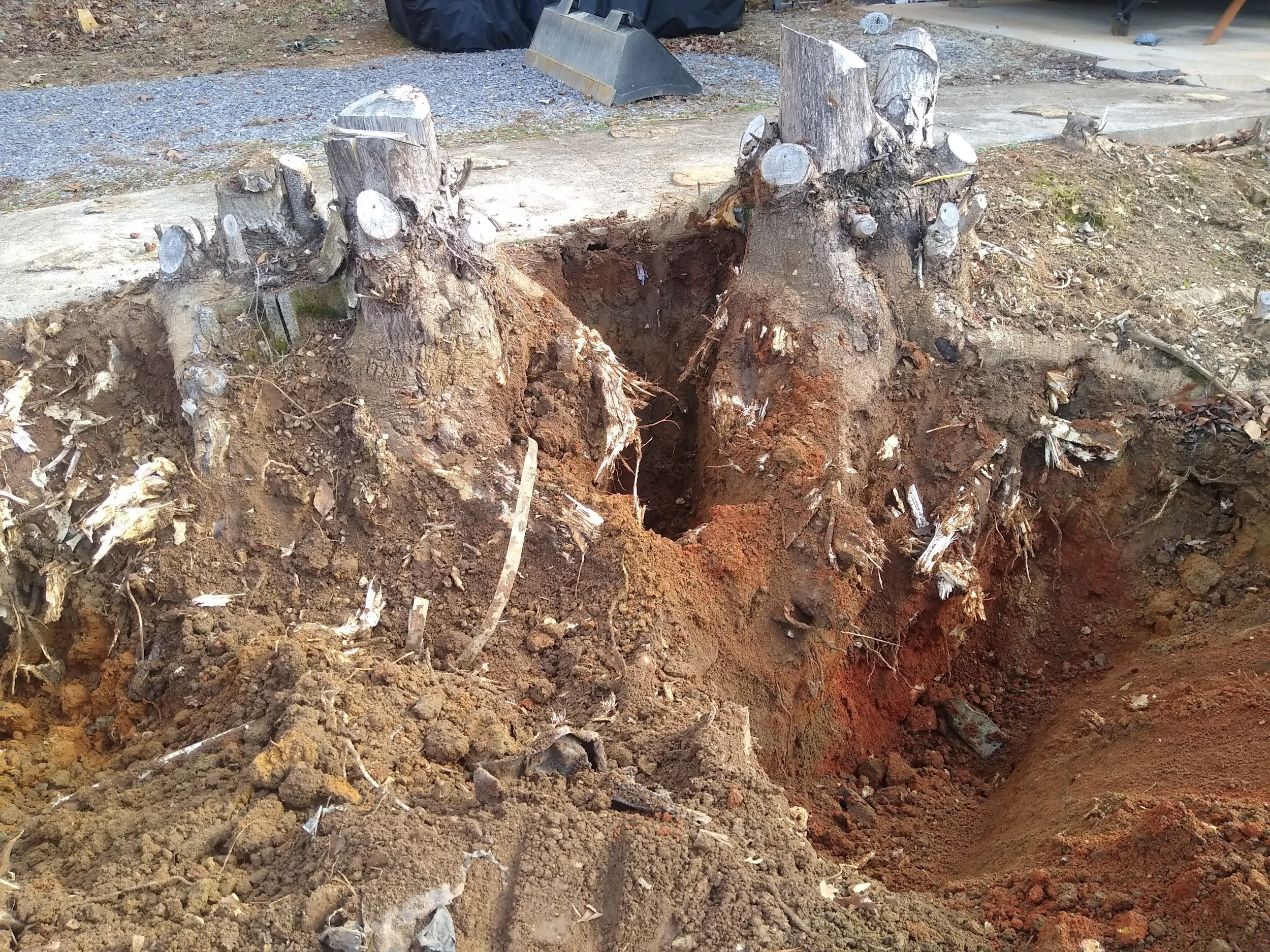

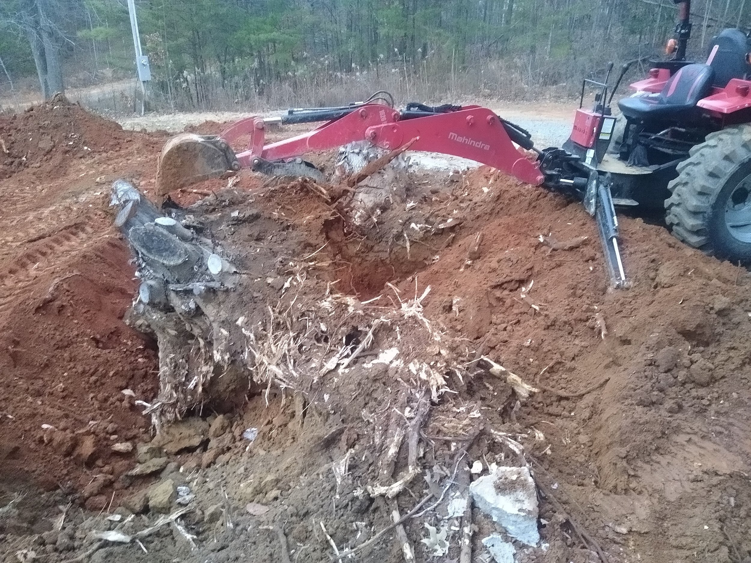

I have a Mahindra 1626. I've done over 24" in less than 2 hours easy. A lot depends on type of tree, soil types and condition, how many angles you can tat it from.
I did these recently because they couldn't be ground due to cement pad next to them and rocks and cinder blocks had been absorbed by tree. They were pretty big and I was on a time crunch trying to beat the incoming rain. Took about 3 hours. I pulled it out with my 2002 Sequoia and the tractor. I was by myself.
