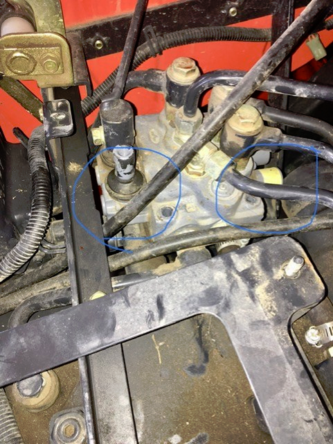

Good Morning all,
I have searched this thread but all I find are control valves that do not look like mine. The conventional wisdom is that the spring and balls are at the front. But mine does not look anything like the ones that do. Before I pull the assemble apart, has any one worked on this style? Thanks

That is the same. It looks different because of the way the lever attaches. The springs and Detent balls are under the cap circled on the right of your picture.

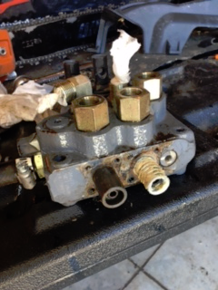

Update. Well I had to remove the valve.Spool piece looks nothing like I have searched for. Will talk to dealer but looks like I need to replace entire spool piece. Left is the detent.
