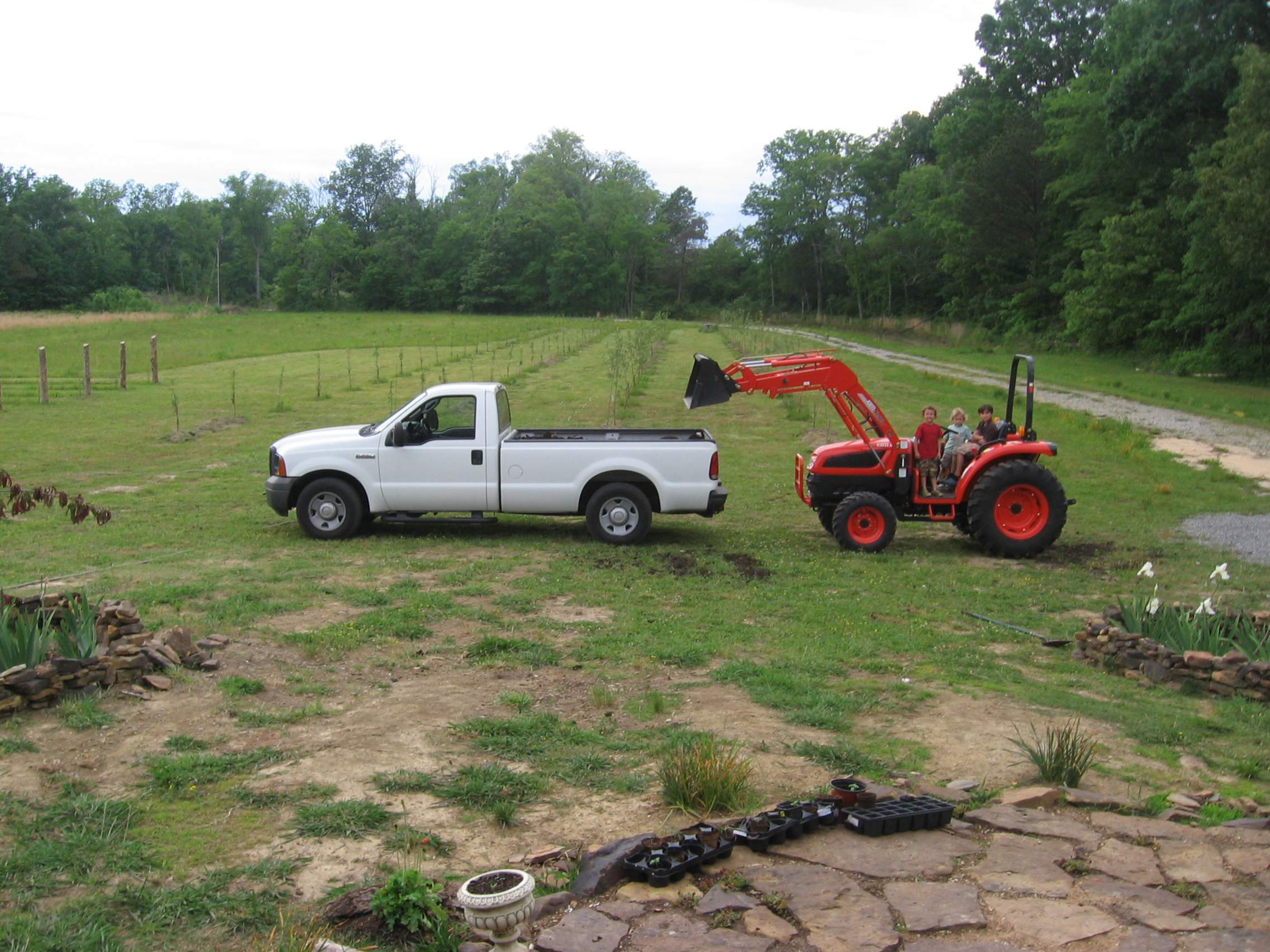

Thank you Martian. Here a pic of the new Kioti tractor next to a Ford F250 for size reference.
