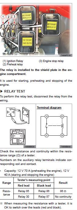

I found 3 on the firewall, does anyone have a picture or diagram showing what ones what? I need to purchase a repair manual I suppose. Thanks for the help and links guys!
   / Kioti DK40SE starting issue #8
Here is the photo you requested... Yes, you really should buy the manual. Your tractor isn't getting much younger and will always need servicing throughout its life. :)

It appears it was the ignition switch, Everyone thanks for the help!
