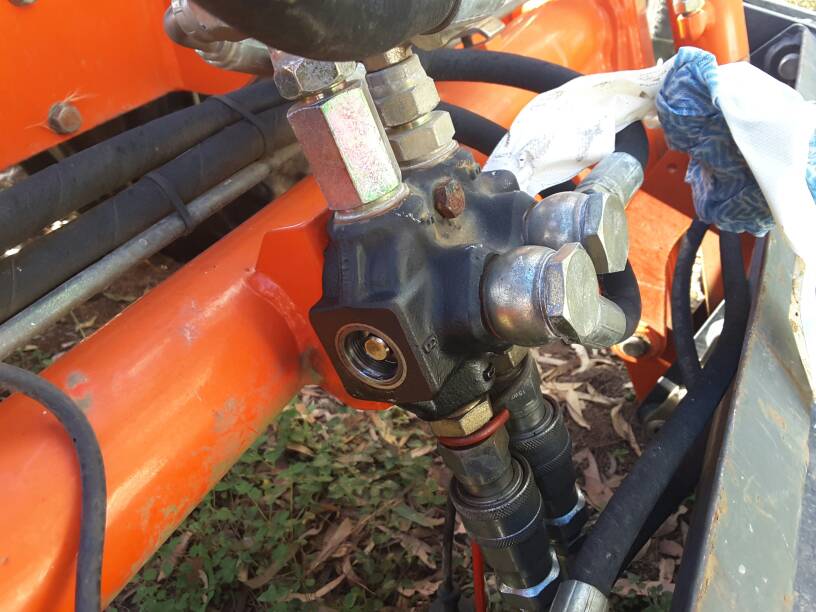

How about a photo of this thing? Does it have a brand name or model number on it? Where is the valve located? Does it work by switching the function of the curl circuit or does it use a three-position (up-neutral-down) rocker switch?
You can get a quality valve for $200-300 but you'll need to match the port threads and mounting holes for a clean installation.
   / Kioti DS3510 with AL 36 FEL 4 in 1 bucket fitted.

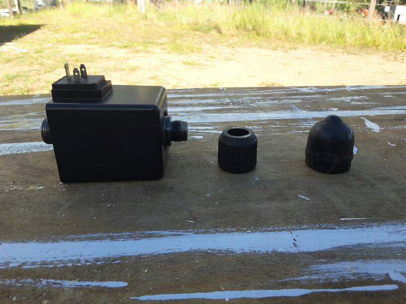

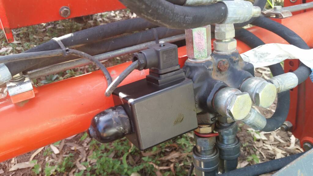

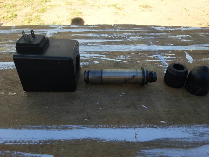

The only info printed on the item looks like Lisa Ireland Pat'd & Pat. Pend.
Couple of pics attached
   / Kioti DS3510 with AL 36 FEL 4 in 1 bucket fitted. #10
Well, that is indeed a diverter valve (as opposed to a third function valve). I haven't seen one that looks quite like that before or one mounted on the torque tube, maybe that's just my limited exposure. Can you expand on what you mean when you said the solenoid failed?
There are two parts to these valves: a hydraulic "spool" that does the actual switching of the flow and an electrical solenoid that moves the spool (against spring pressure) from the default position to the other position. If only the electrical coil has failed, it can easily be replaced if parts are available. In fact, these valves can be ordered with any of several coils for different applications (e.g. 12v, 24v, 110vac, etc.) Do you know if the spool is jammed or if the electrical solenoid has failed?
You can certainly replace the complete solenoid valve but the trick will be ordering the one that mates with the existing fittings and mounting bracket. Here is an example of the kind of valve I see these days in the US: http://apps.boschrexroth.com/products/compact-hydraulics/cdv-catalog/pdf/vs151-152-155.pdf
