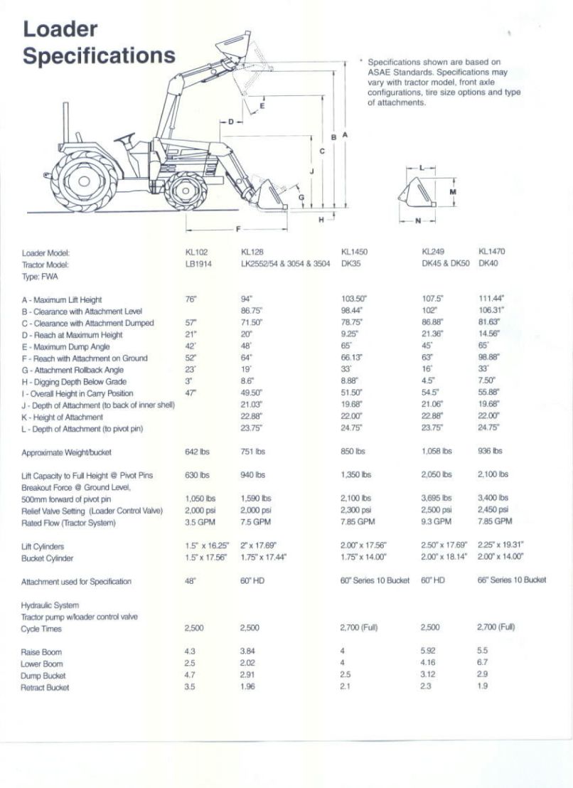

My new LB1914 has a FEL. It is identified as KL102, Serial#SL20369.
I'm looking for the specs on this loader. I discover from the Kioti literature and website no info for this loader.
Both the website and info sheet show that the loader for this tractor is the KL1210, are they the same? I need your help and advice! Thanks.

The KL102 was the original loader number when the loader was manufactured by someone else. I don't have the specs, but I'm looking for you. Maybe someone else has one and can provide the specs for you. Other than that, contact customer_service@kiotitractor.com and ask for the specs. John

   / Kioti FEL- KL102 Questions #4
KL102 loader
Max lift hight-76"
reach at max height-21"
max dump angle-42 degrees
reach with attachment on ground-52"
rollback angle-23 degrees
digging depth below grade-3"
overall height in carry position-47"
approximate weight/bucket-642#
lift capacity @ pivot pins-630#
breakout force@ ground level-1,050#
relief valve setting-2,000 PSI
rated flow-3.5 GPM

Hey guys, my dealer just gave me this.

Yep, thats the same flyer I got the specs from
