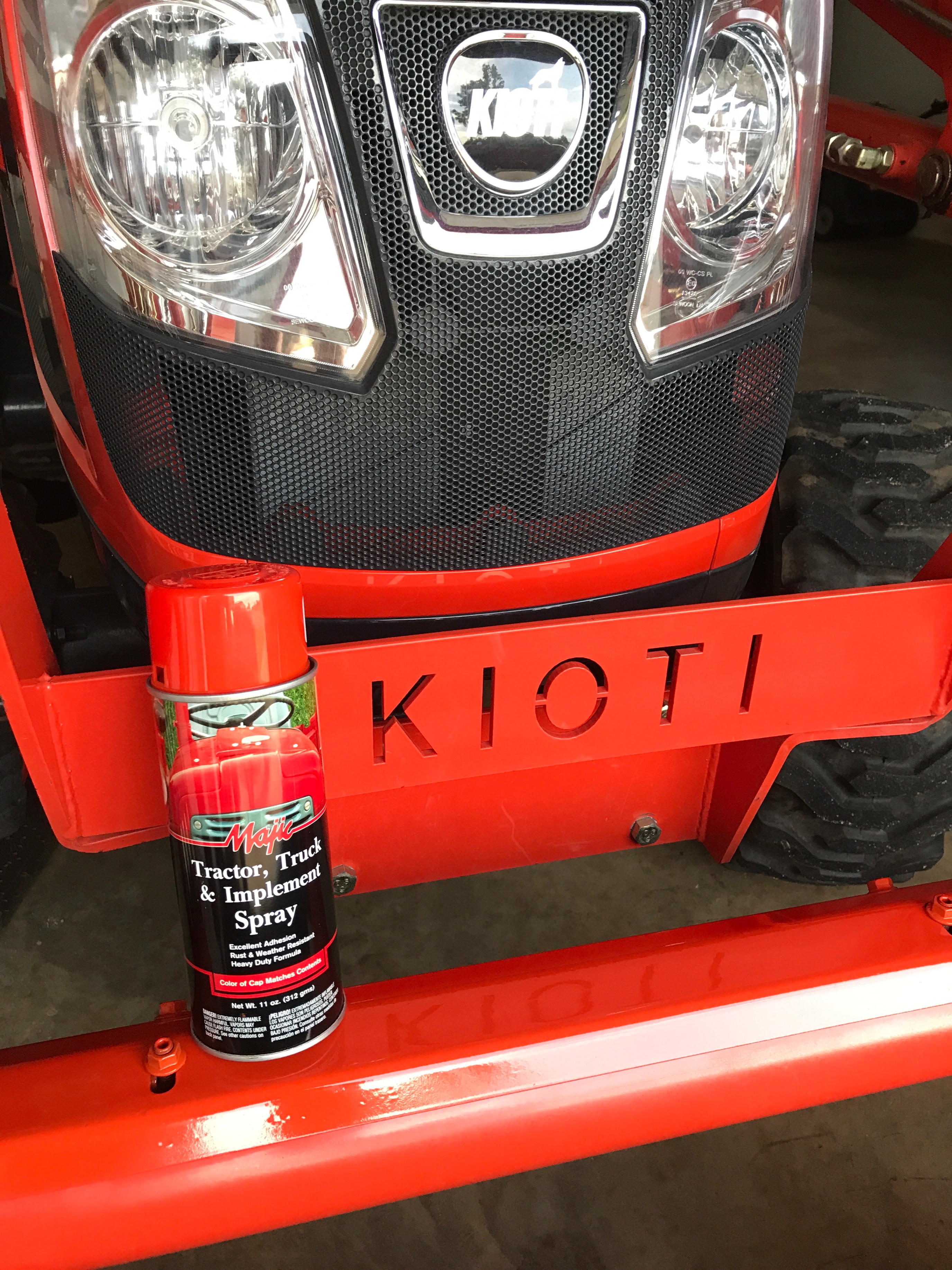

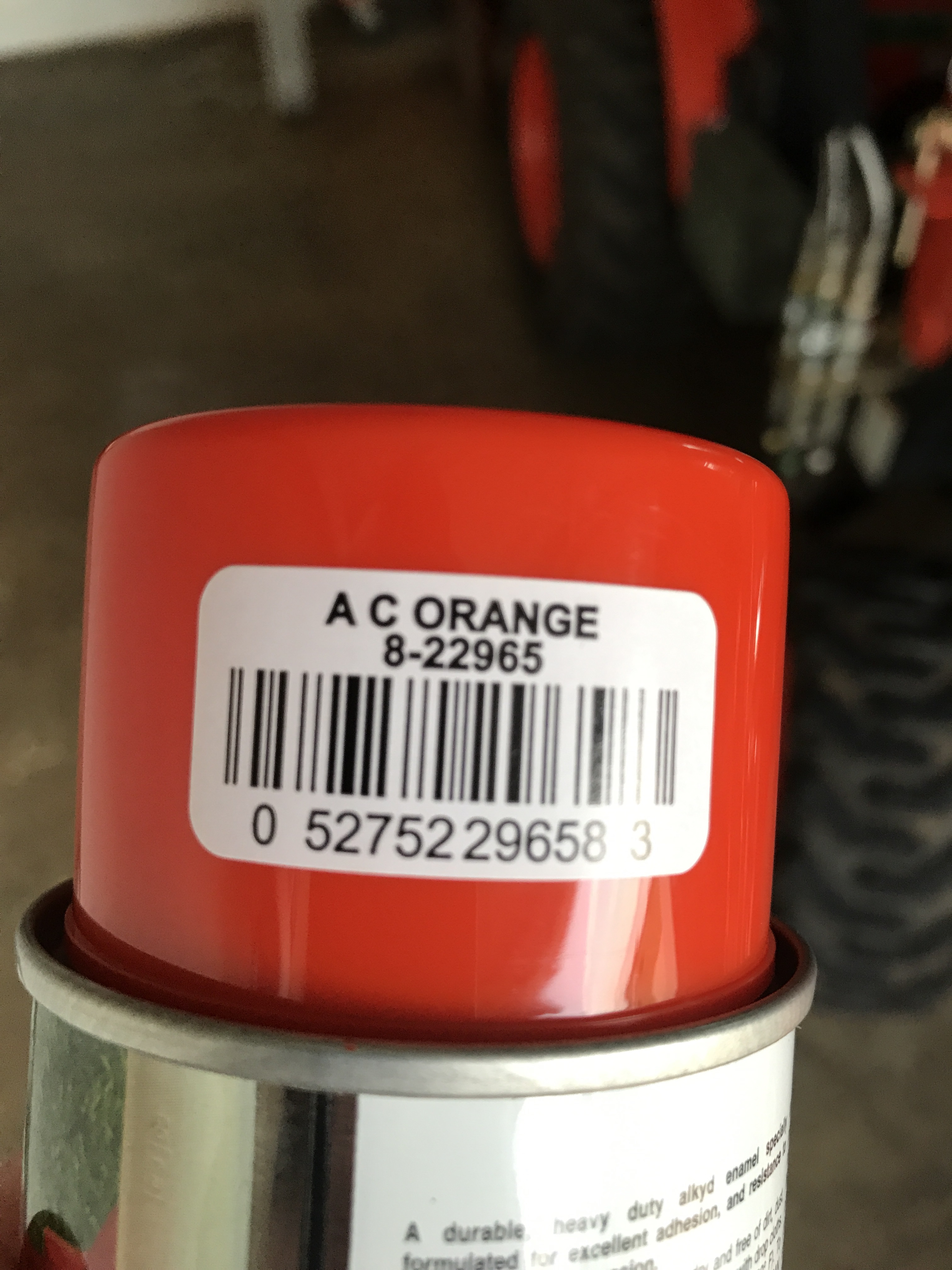

Not sure about the gray, but I found a pretty good orange match from Tractor Supply. FWIW. I was actually looking around for gray match but didn't find anything that looked similar. IMG_1093.JPGIMG_1094.JPG

Thanks. I repainted my orange step years ago and it was too light colored. rest of my old tractor has nice paint, cracked decals on engine side panels.
