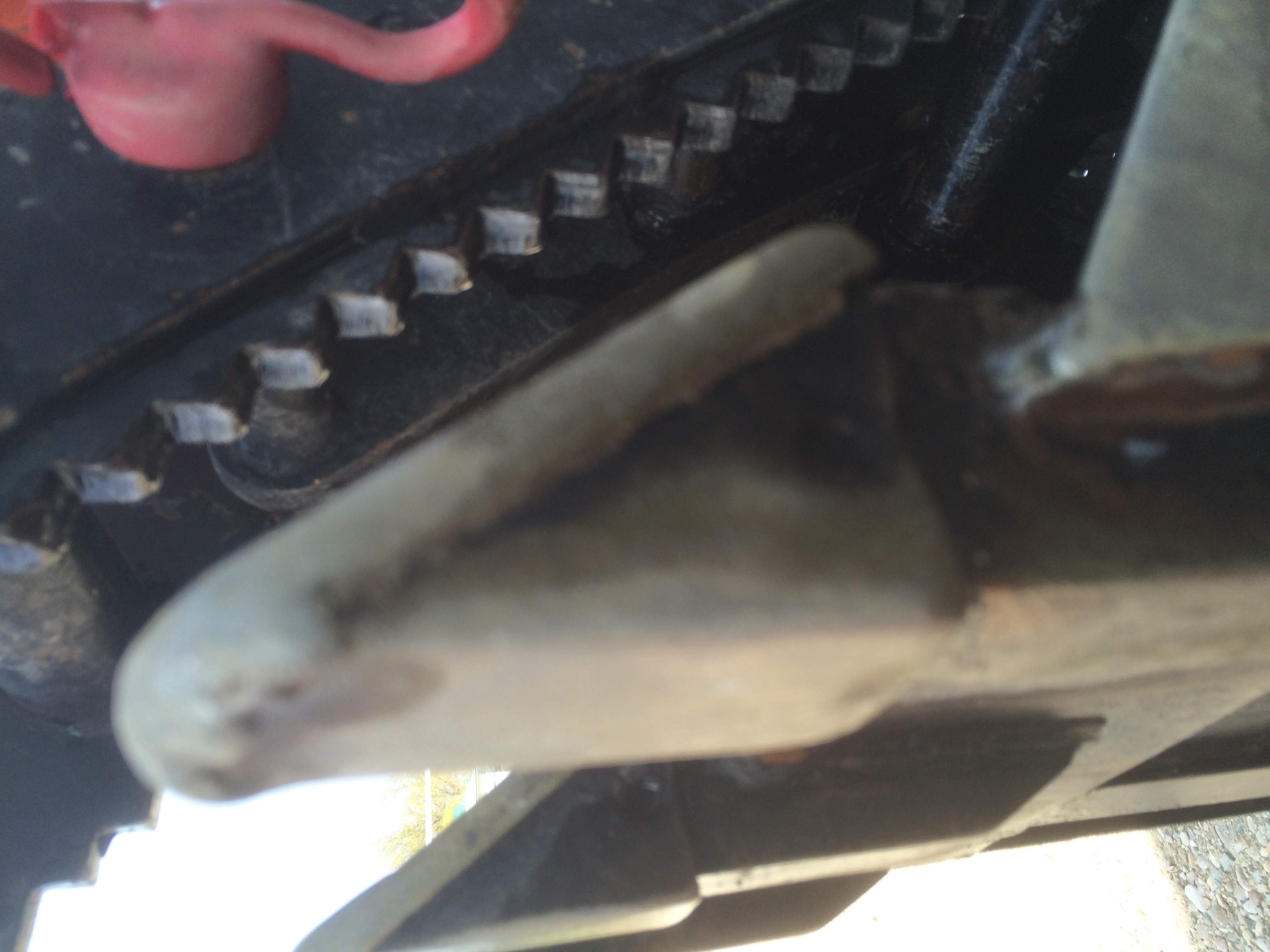

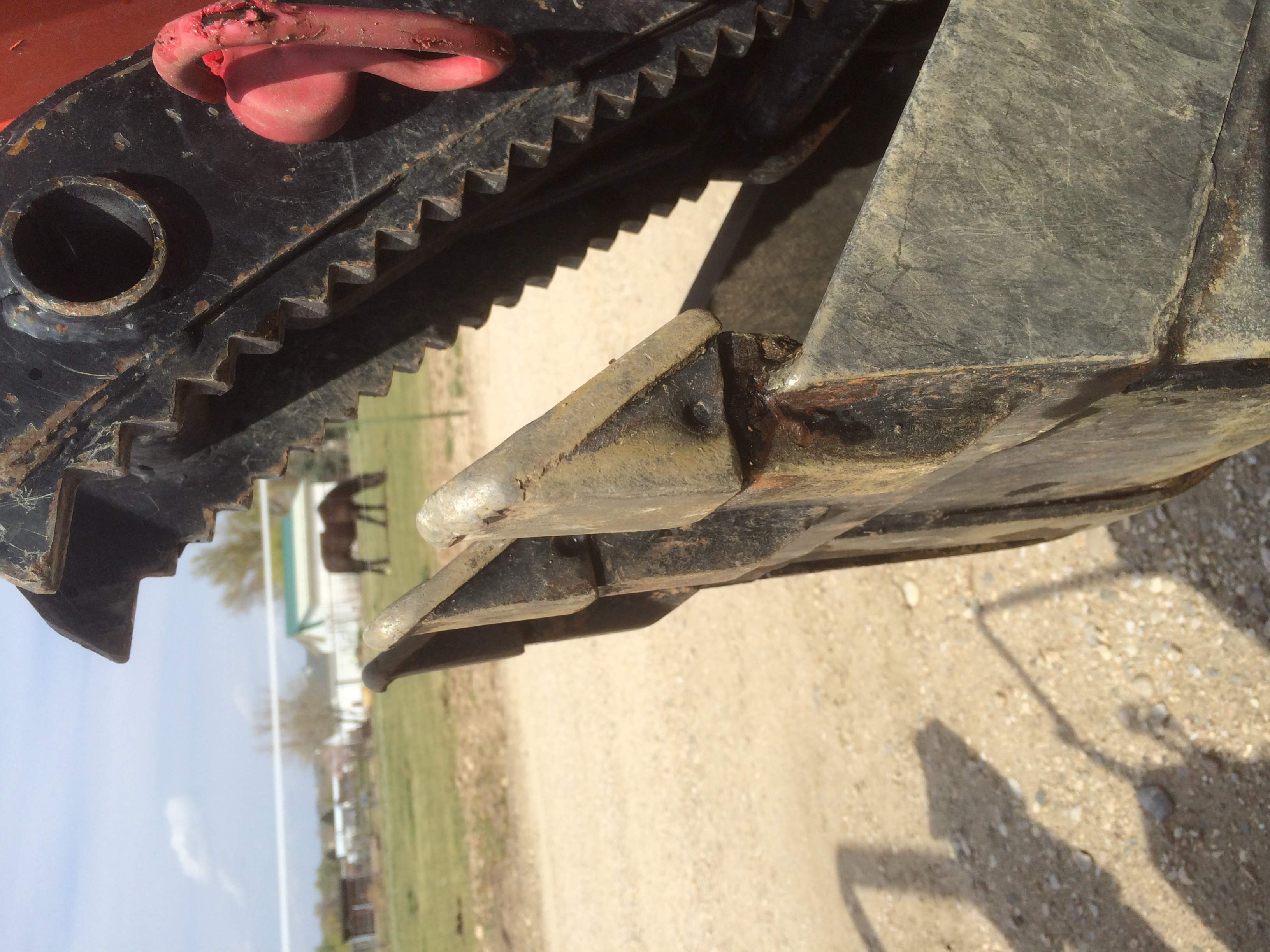

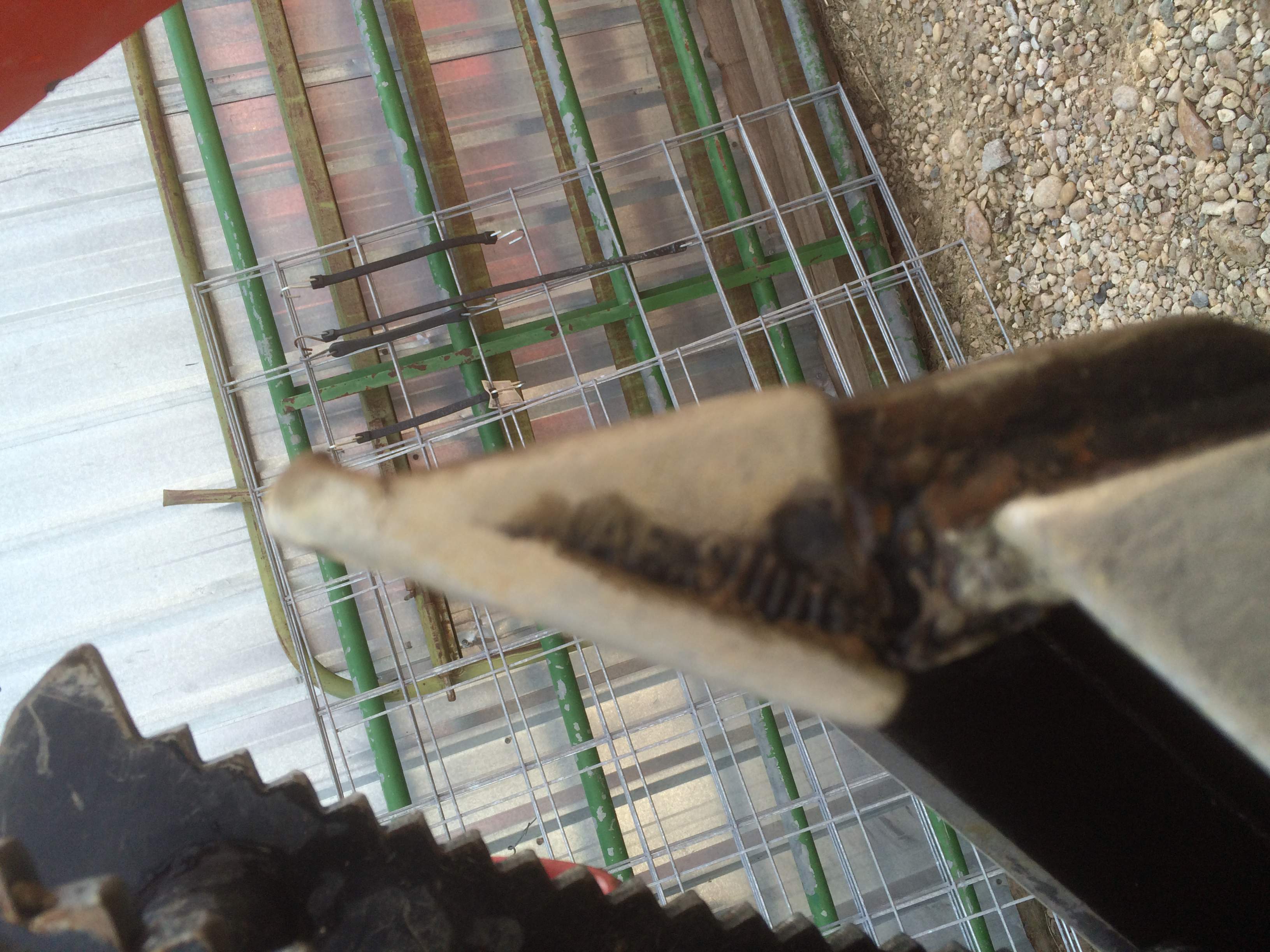

I need to replace the teeth on this backhoe. The owner's manual shows no separate part number for the teeth and the dealer does not list them either. Seems you have to replace the entire bucket - YIKES! Has anyone replaced the teeth on one of these? I have a 12" bucket w/ 3 teeth.

They aren't broken off, just very well worn from digging in gravel we have here. I have added weld to them on the ends a couple of times and figure it's time to replace them. They have "dimples" on them where I think they slip onto the 'welded tooth anchors' that they would clip onto ...? I am thinking that if I have to replace the bucket I could replace it with CAT or JOHN DEERE, something with 'replaceable' teeth. I don't know if the pins would match though, haven't checked into that.
   / Kioti KB2475 backhoe teeth
I have attached pics

The teeth look replaceable to me.
They look the same as the teeth on my Rhino backhoe.
You should be able to just knock the tooth off with a hammer, replace the tooth and peen the tooth recess into the shank.
