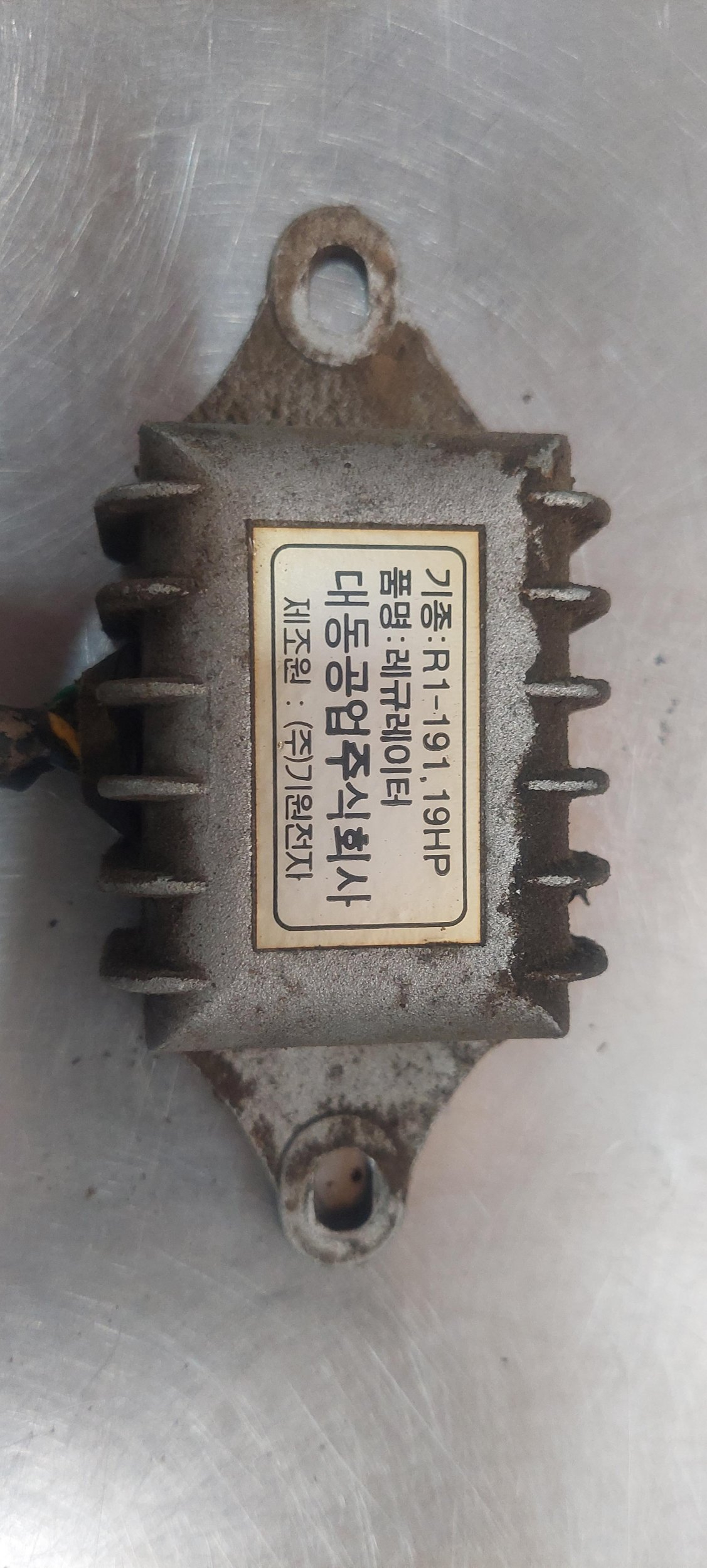

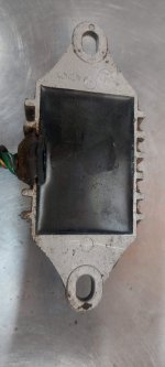

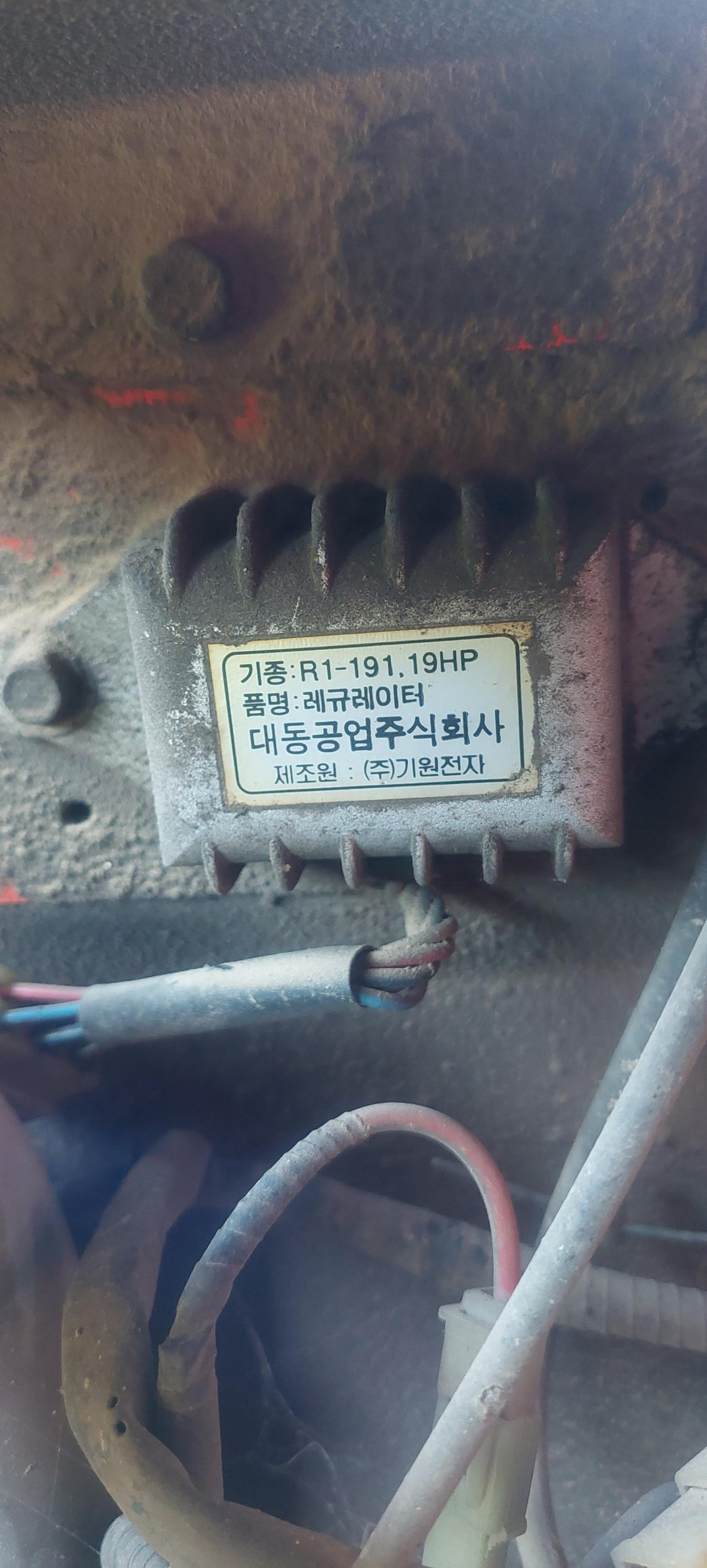

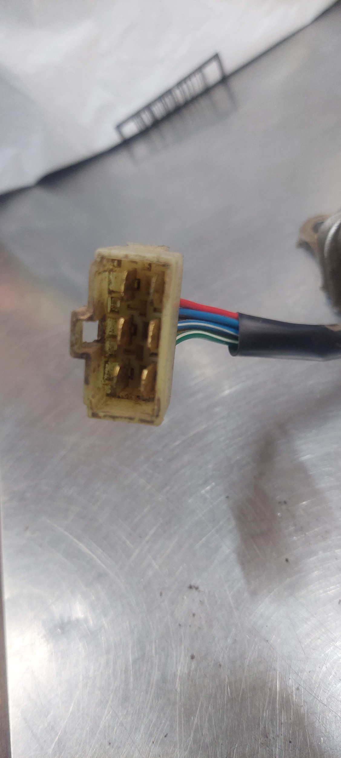

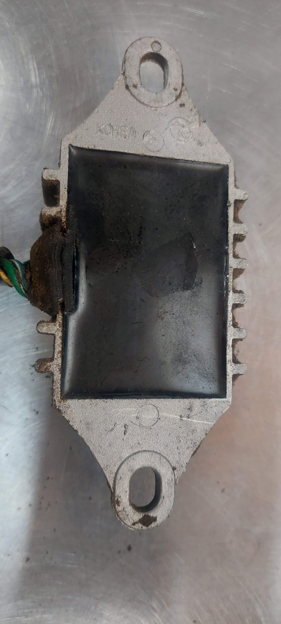

Ok, here's the update: I made a 30 amp circuit breaker "tester" this morning to replace fuse temporarily, I thought I had more circuit breakers but could only find a 30 amp. When I connected the battery cable, it took about 20 seconds before the the magic smoke started to appear. It was coming from the regulator, which is what I was suspect of when I saw the smoke yesterday, as it was located around the right area where the smoke seemed to have came from. In the 3rd photo below on the backside of the regulator, you can see some cracks in the sealant/epoxy. Also around the wires as well.
Now my concern is if it is just the regular that went bad due to internal corrosion or etc causing a short. OR is there something else that shorted and in turn fried the regulator.
So far I have not found any other wires that are bad or anything. Even the wires going into the regulator are not burned or etc. So at the moment I am hoping it was just a bad regulator, and that when I replace it the new one won't also burn :rolleyes:
Looks like the regulator is $85 to $100. Found it for $85 on Tractor Joe's:
What do you all think? Just a bad regulator??

If and when you get a new regulator, i would unhook the positive battery cable before installing the regulator. Then I would hook the previously mentioned seal beam headlight between the battery post and the cable, thereby limiting the maximum amps that are available to fry the "smoke" out of a component.
Keep in mind that even the headlight strategy could pass enough amps to fry the new regulator, so no guarantees from me, but it would be better than giving the new regulator full battery amperage, which runs in the hundreds of amps.
Again, if the headlight glows pretty bright, I would hesitate to re-hook the battery cable direct until I could get that headlight to a dim or even no glow.
   / Kioti LB1914 30 amp "slow blow" fuse burned twice - can't find cause #8
And remember, your goal is to get that headlight bulb to glow pretty dim, if at all. If it's still bright, unhook some of the leads to the alternator to see how that affects the bulb. It could be that there is a problem in the ALTERNATOR itself, short circuiting to ground THRU the regulator.
#9
Yeah, thats a good idea. I'll try that and see what happens when I get a new regulator. I replaced the alternator a couple years ago when the original would [Not] charge any more. But anything is possible.
