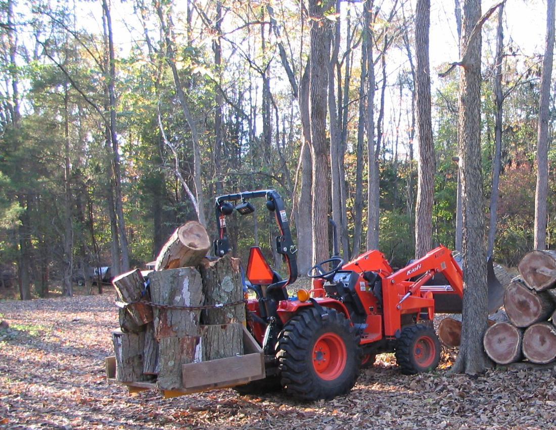

   / kioti lb1914 lift capacity #4
I believe it is ~1300 pounds at 24 inches behind the eyes with using the holes closer to the eyes to connect the links to the lift arms and ~1000 at 24 inches using the near holes. With the first set up I mentioned you have less range of motion. I can confirm that mine will lift 12 rounds each over 100 pounds on a wooden platform on top of a carry all. That's proabably 1,300 - 1,500 at 20 inches back.
   / kioti lb1914 lift capacity #5
This isn't the load I was talking about but probably weighed as much.
