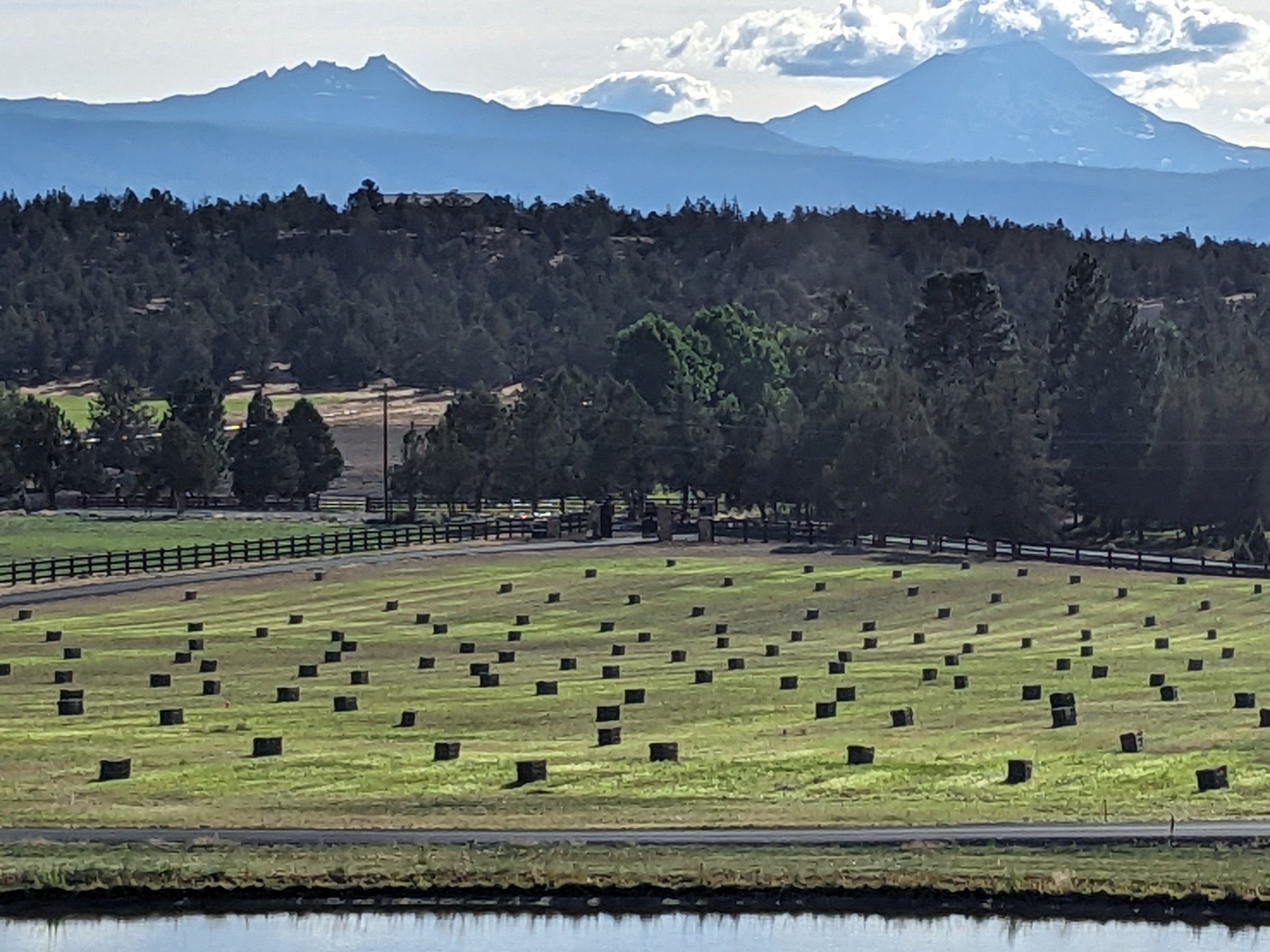

Situation : 25 acre ranch in Central Oregon, 14 acres hayed.
Looking for a general purpose tractor to help me complete some chores and projects. Want to buy new and keep it for decades to come. Not completely ready yet to take care of all of the haying myself, but as a minimum want to be able to load the bales (90lbs , 3-string). Might add more tasks in the future, but balers are expensive.

You are correct, it doesn't make economical sense to invest in a baler, for now I would just keep on using a neighbor's contracting services. Having said that, my own tractor would be a first step toward more independence from a very unreliable local employment/contractor market. Bend Oregon is a more upscale market dominated by equestrian facilities. Some of those (spoiled ex-PDX or California) people even like smaller batches of 60lbs bales, delivered to the barn. It's really a **** show down here, where you have to be able to be self-sufficient and do all your own maintenance, etc...
