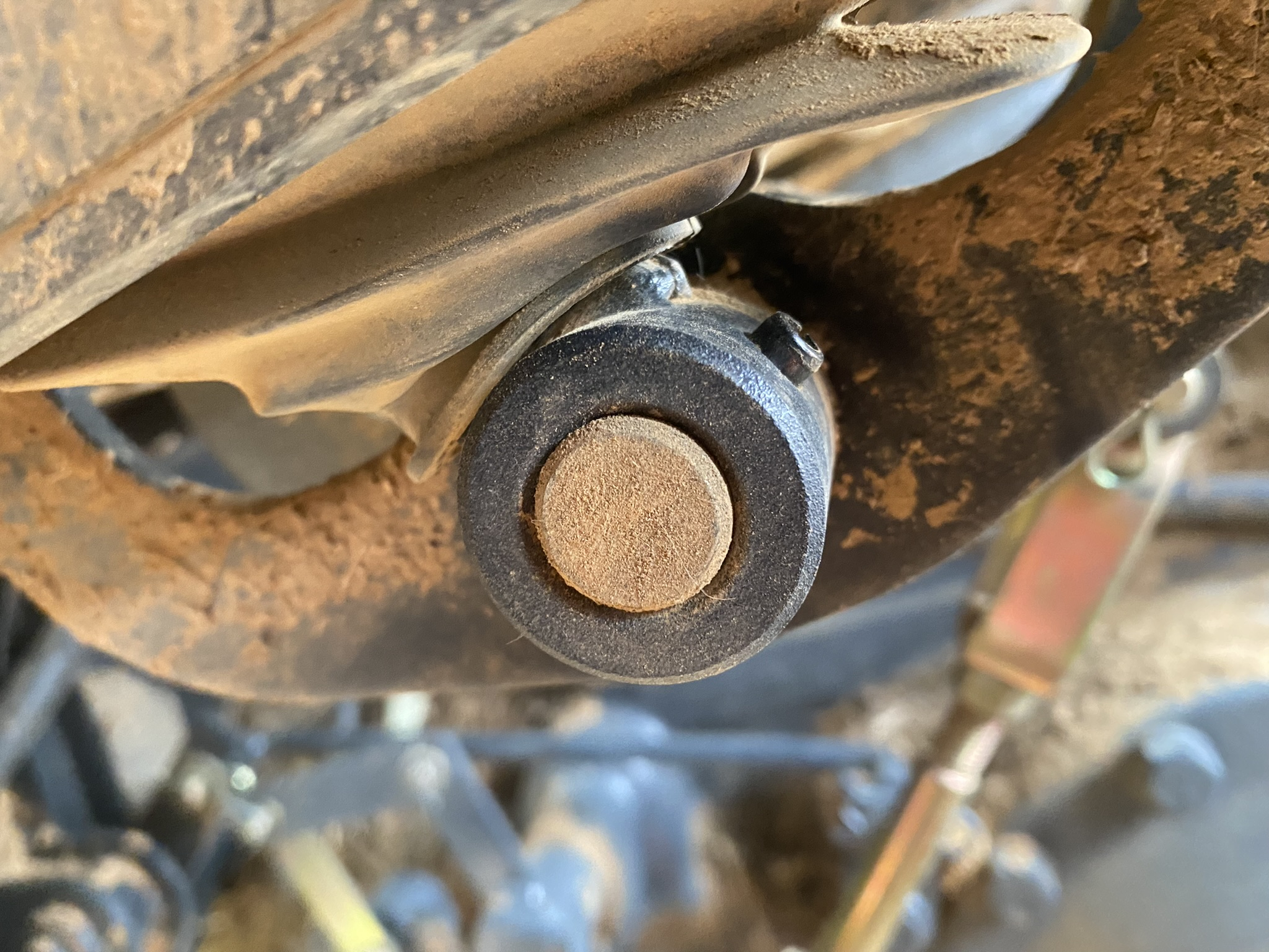

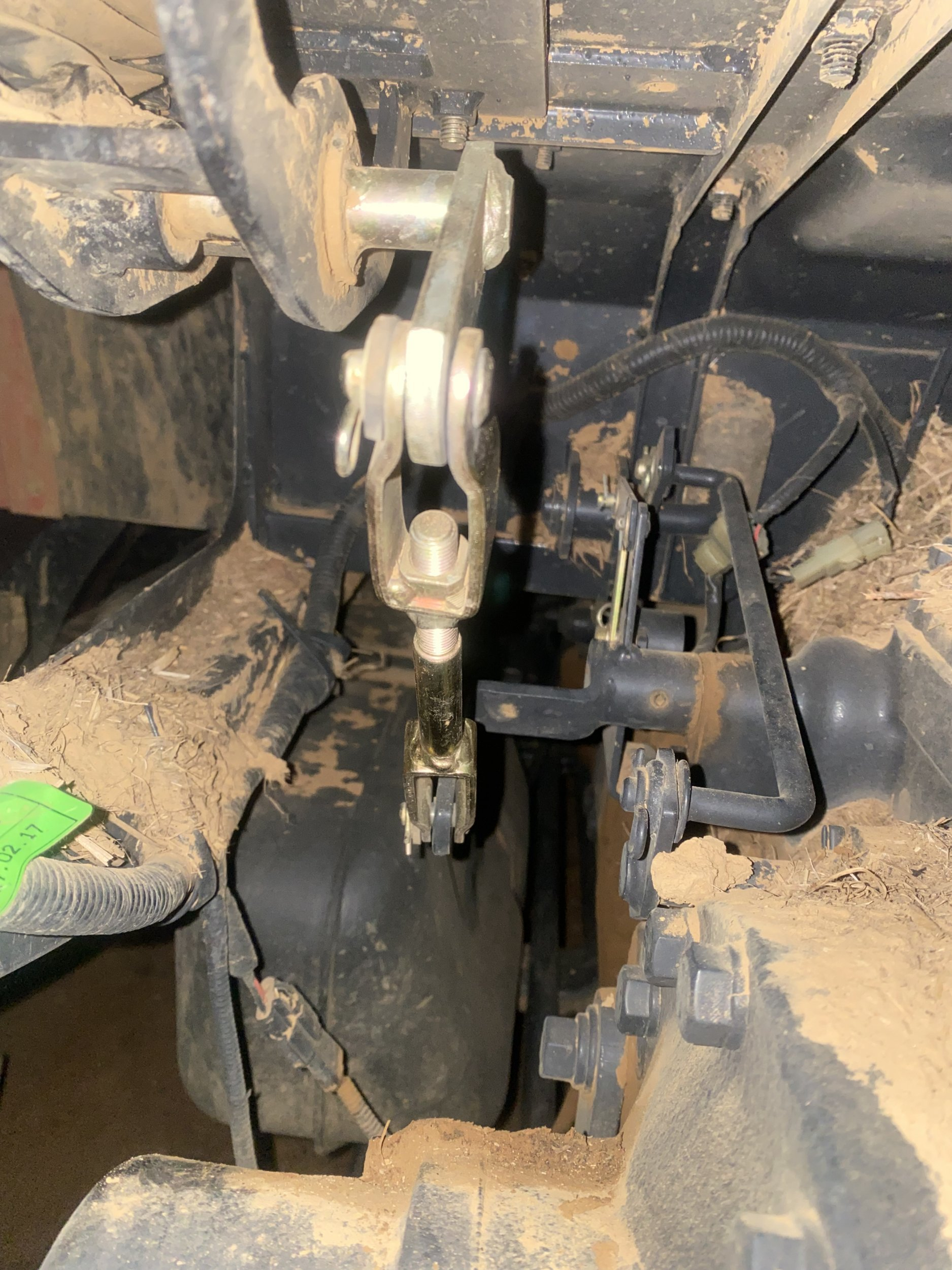

Pretty sure the linkage between my in cab shifter H M L and the transmission fell off. The shifter has no pressure and just slides through what should be the gears. Can anyone that has one take a picture of theirs and post it up for me to reference? Here is what mines like thanks for any help

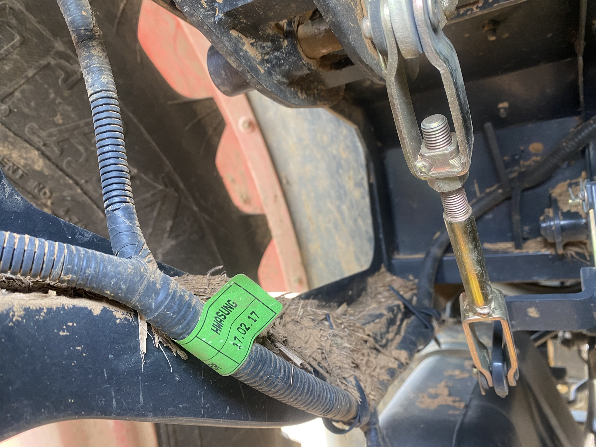

thank you. It looks like all the parts are there

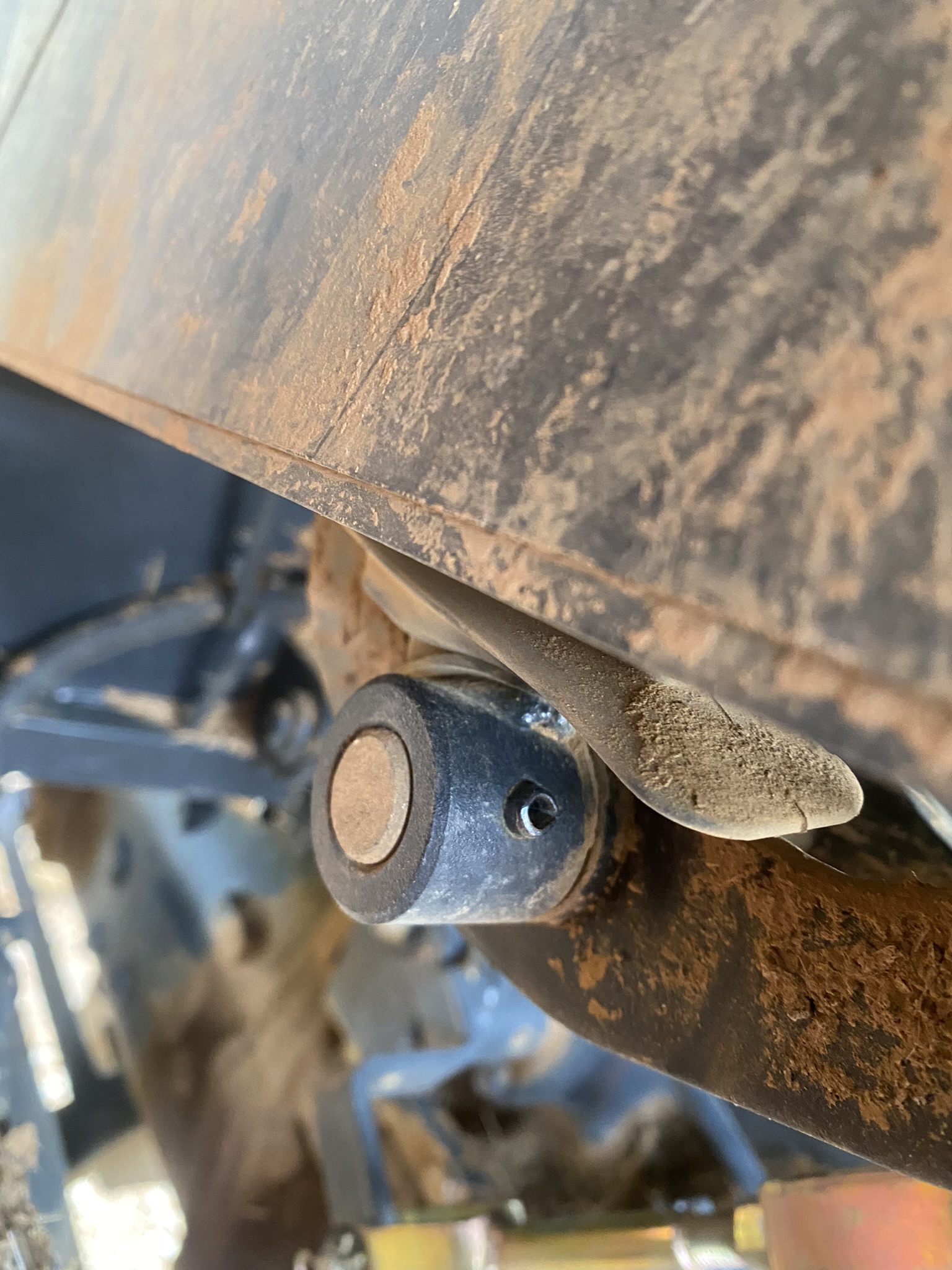

Is that set screw still tight?
Theres one in the cab and at the transmission lever arm as well.

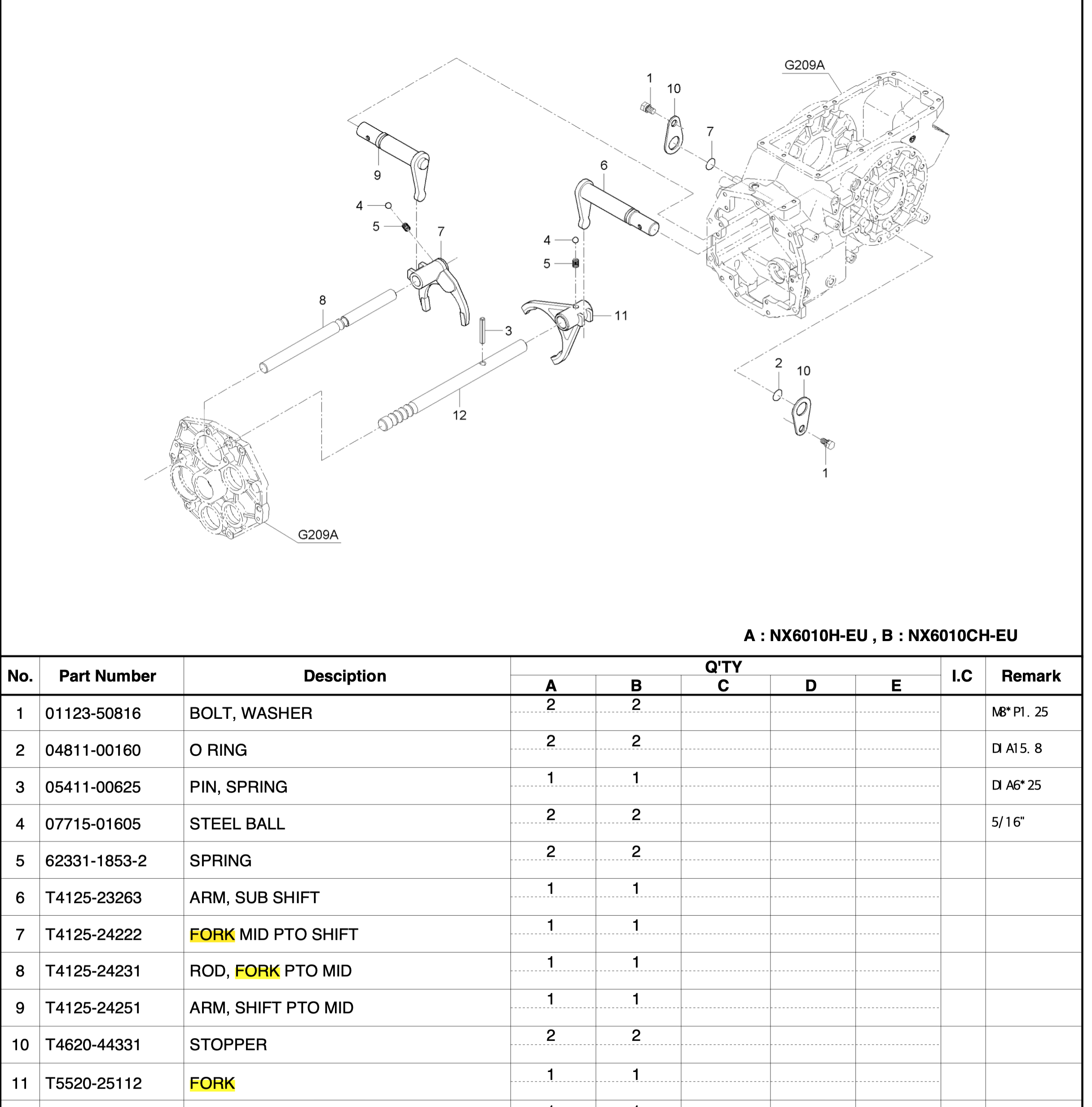

Have somebody get into the cab and cycle the range selectors from low to high. Follow the linkage. If the linking is moving and that movement goes into the case, then the likely cause is the shift fork has come loose from the range shift arm (the shaft going into the case)

Eric when we shift the linkage barely moves it moves a little but I would expect it to move more EveryThing looks intact I was expecting this to move more I followed everything down into the boot of the shifter and everything is attached

Just an update ended up being a broken roller pin Got it punched out and replaced and everything works well Thanks for the help
