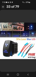

I'm hoping someone reading this can help me. I have a Kioti CX2510 that I just received. When I was looking at the tractor before buying it I saw 3 empty switch locations on the dash with plastic blanks covering the openings.
I really liked this as I like to add lights and wanted a switch for my spreader vibrator and I really liked the possibility of installing professional looking rocker switches in those locations.
I bought the machine and also ordered 3 automotive rocker switches for those openings.
These openings aren't standard size openings. They are the same width but just a little longer. My switches are too small.
Does anyone know where I can find appropriate sized switchgear?
I don't normally assume anything. I was wrong about this one.
Any help or link would be greatly appreciated.

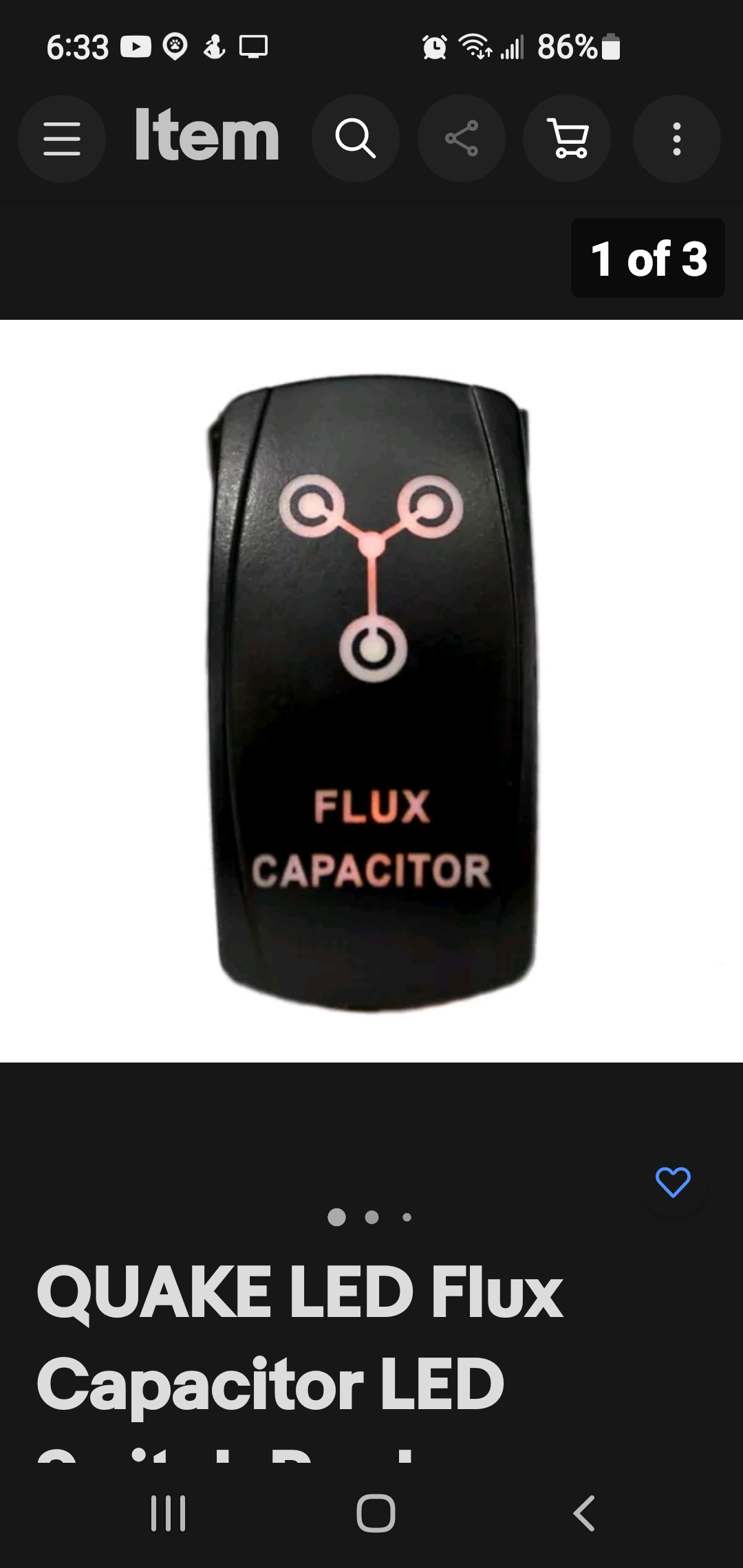

I thought it would be cool to have switches that said stuff like Flux Capacitor.

And nut for Nottin, but I'm pretty sure my Dealer doesn't have cool Flux Capacitor rocker switches.
Ha! There you go! Almost as slick as the Big Foot illuminated work light switches that Minnesota Eric used in his epic NX6010 HC thread a few years ago!
