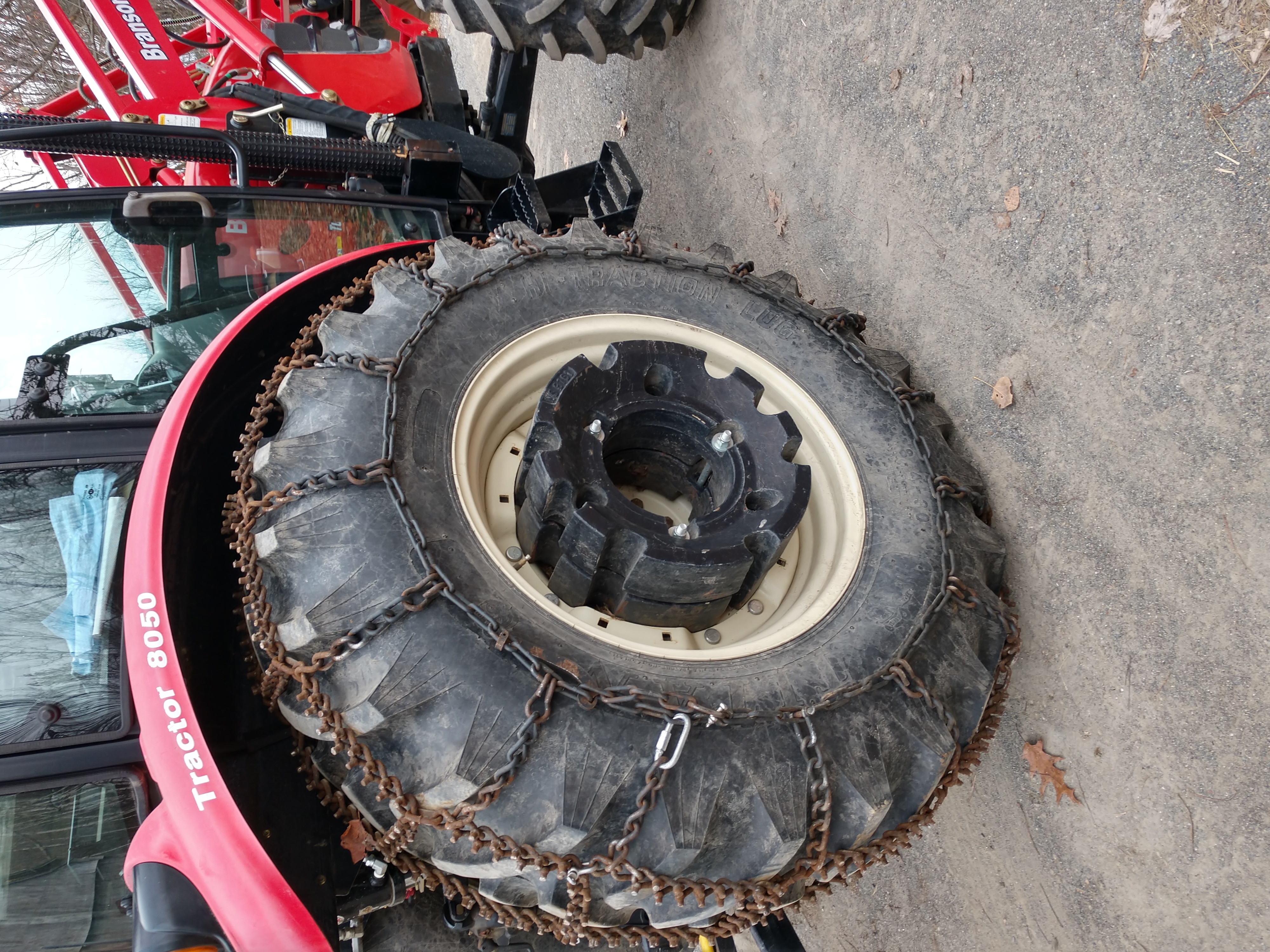

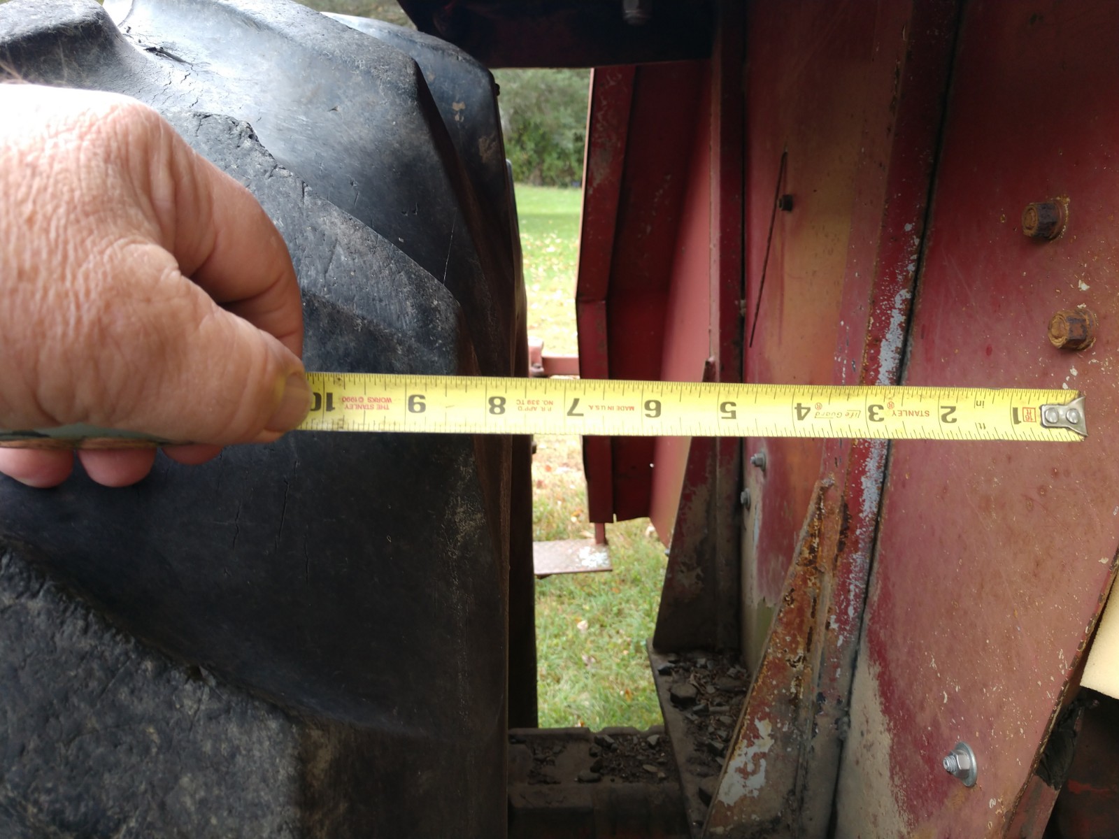

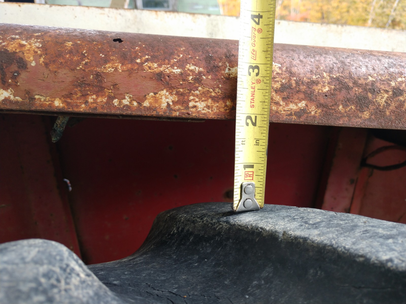

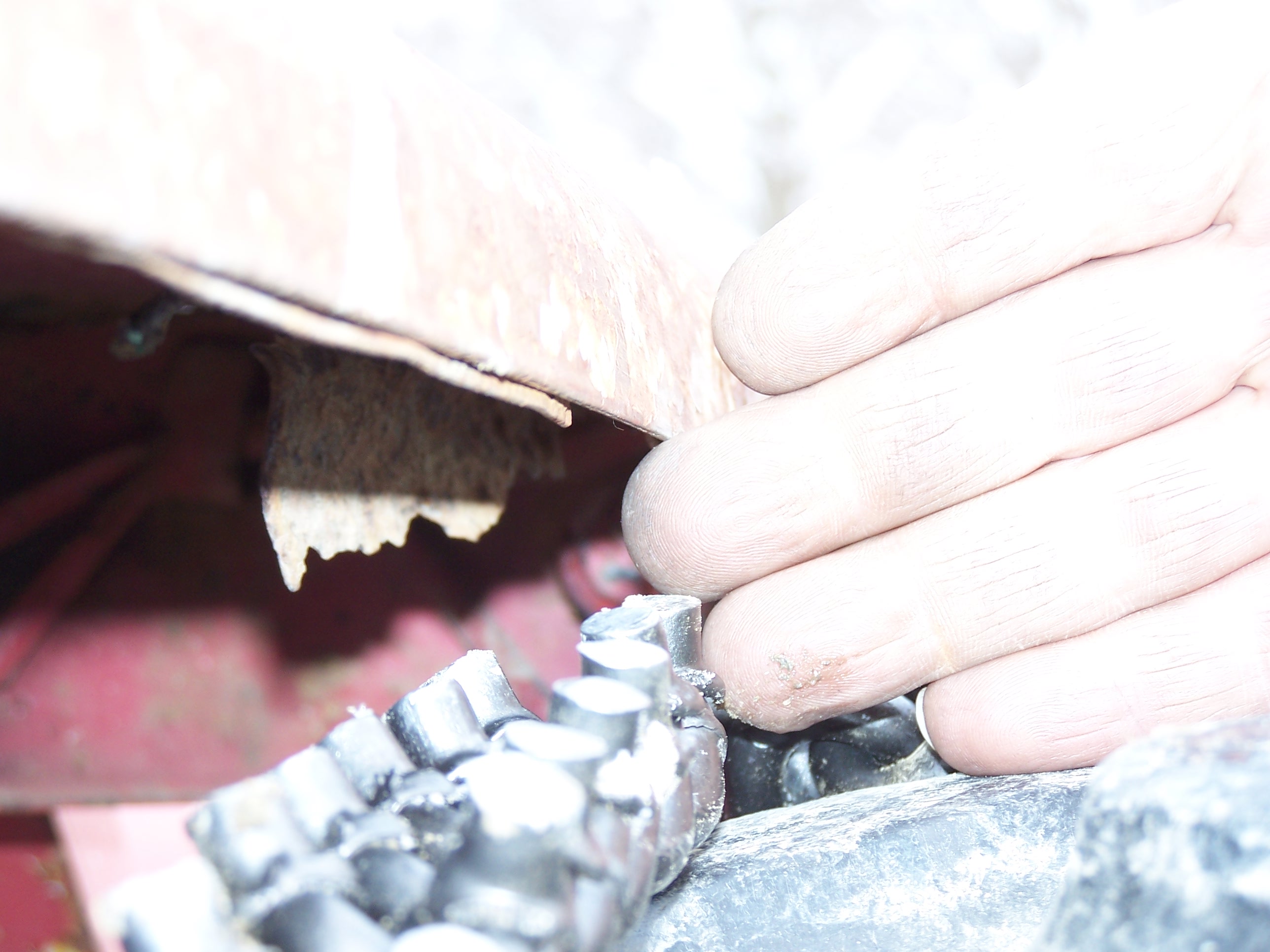

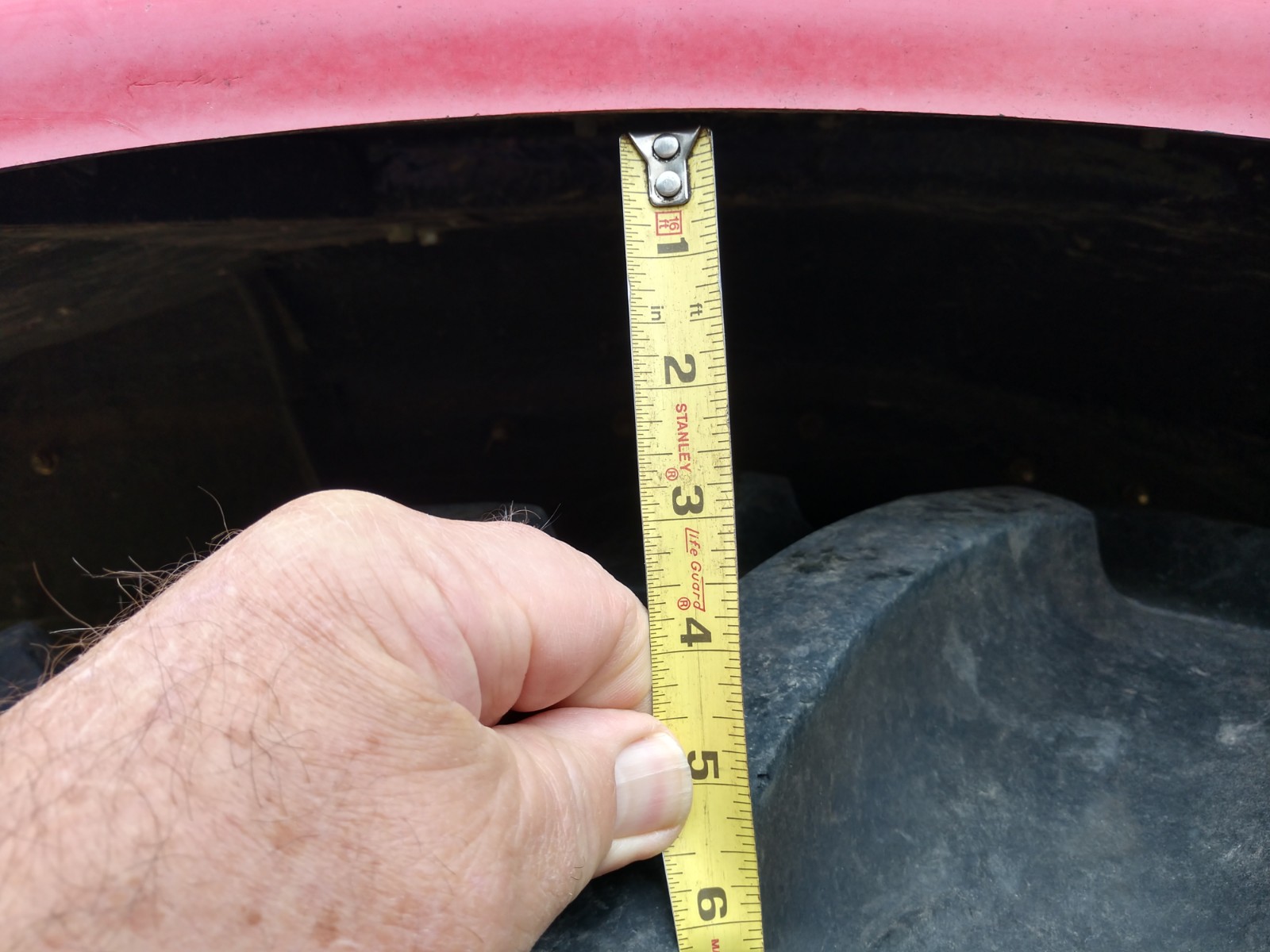

Maybe this will help you a bit;
100_4175.JPG on my IH 574 the upper fender is close
574 fender clearance.jpg about 2 inches clearance
574 inner clearance.jpg the inner fender is no issue about 8 inches
This tractor gets roaded very little max speed is maybe 10 mph but no fender issues.

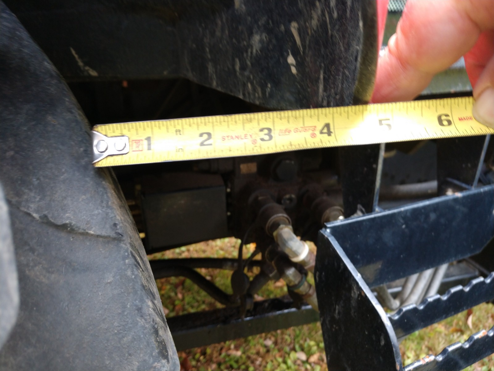

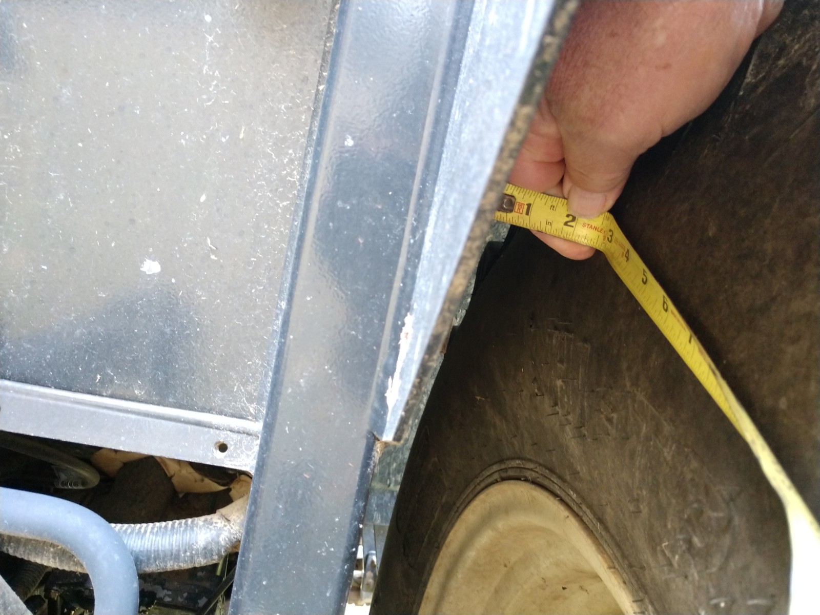

upper fender clearance.jpg Branson 8050 about 5 inches clearance to upper fender
front of fender clearance.jpg a bit over 4 inches to front of the rear fender
inner fender clearance.jpg to the inner fender just about 2 1/4 inches, it needs a little bit more occasionally while traveling at high speeds I will get a small click from the latching levers, I should remove the wheel weights and swap the tires from side to side for a bit more clearance.
These are the Aquline Talon chains which are similar to the OFA's
Lou
