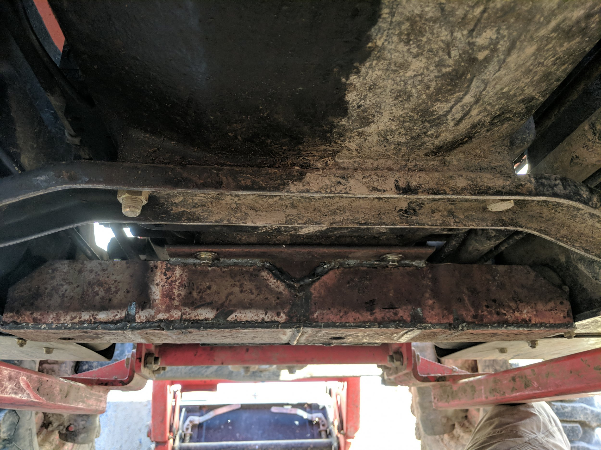

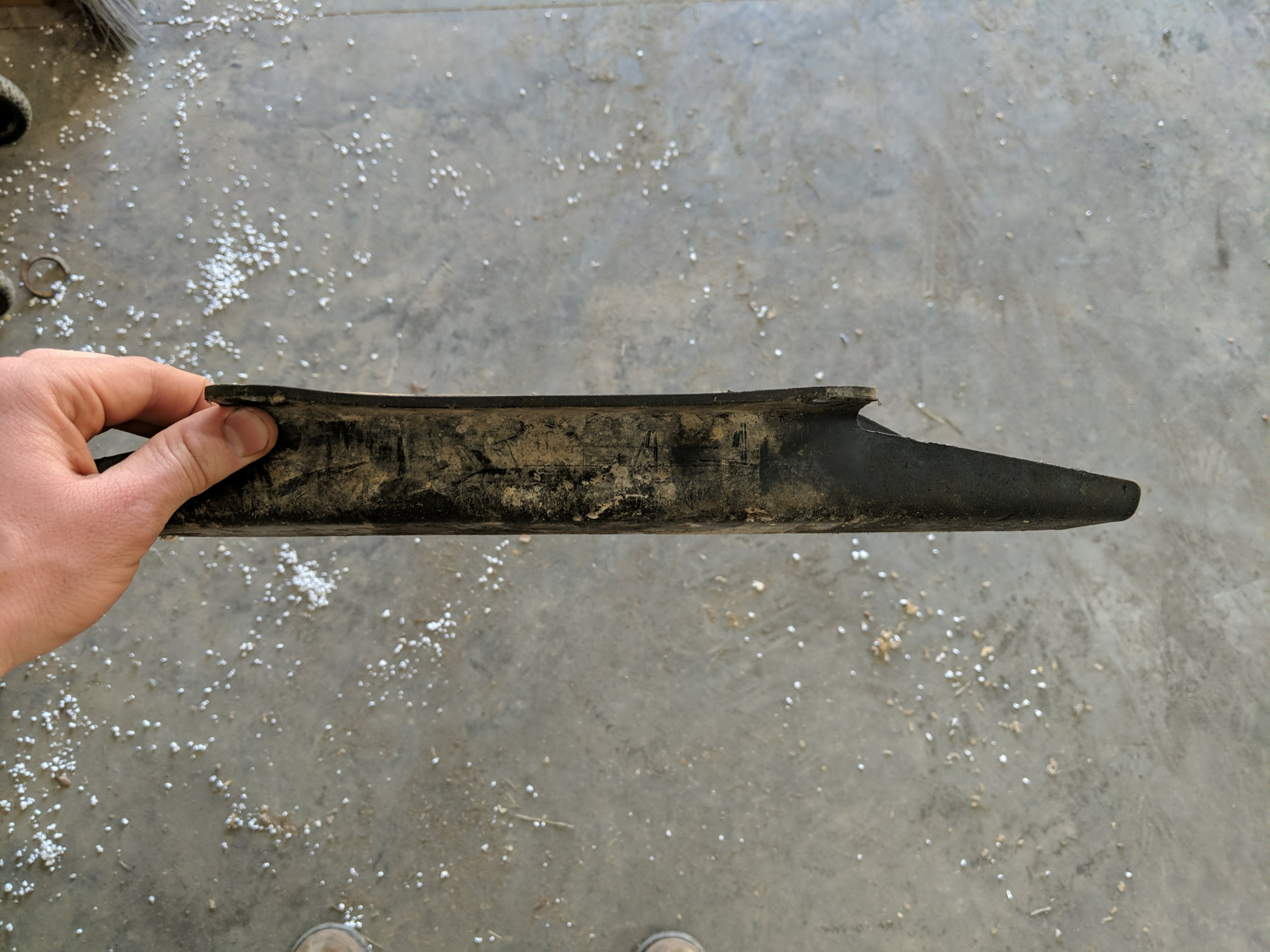

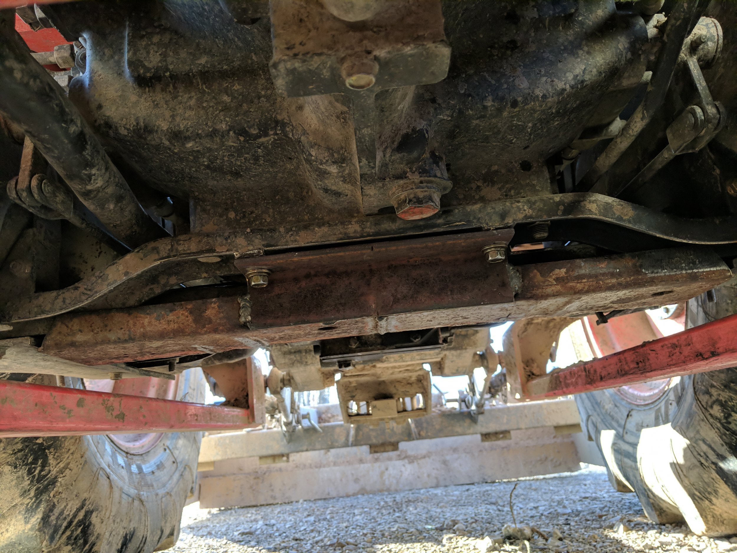

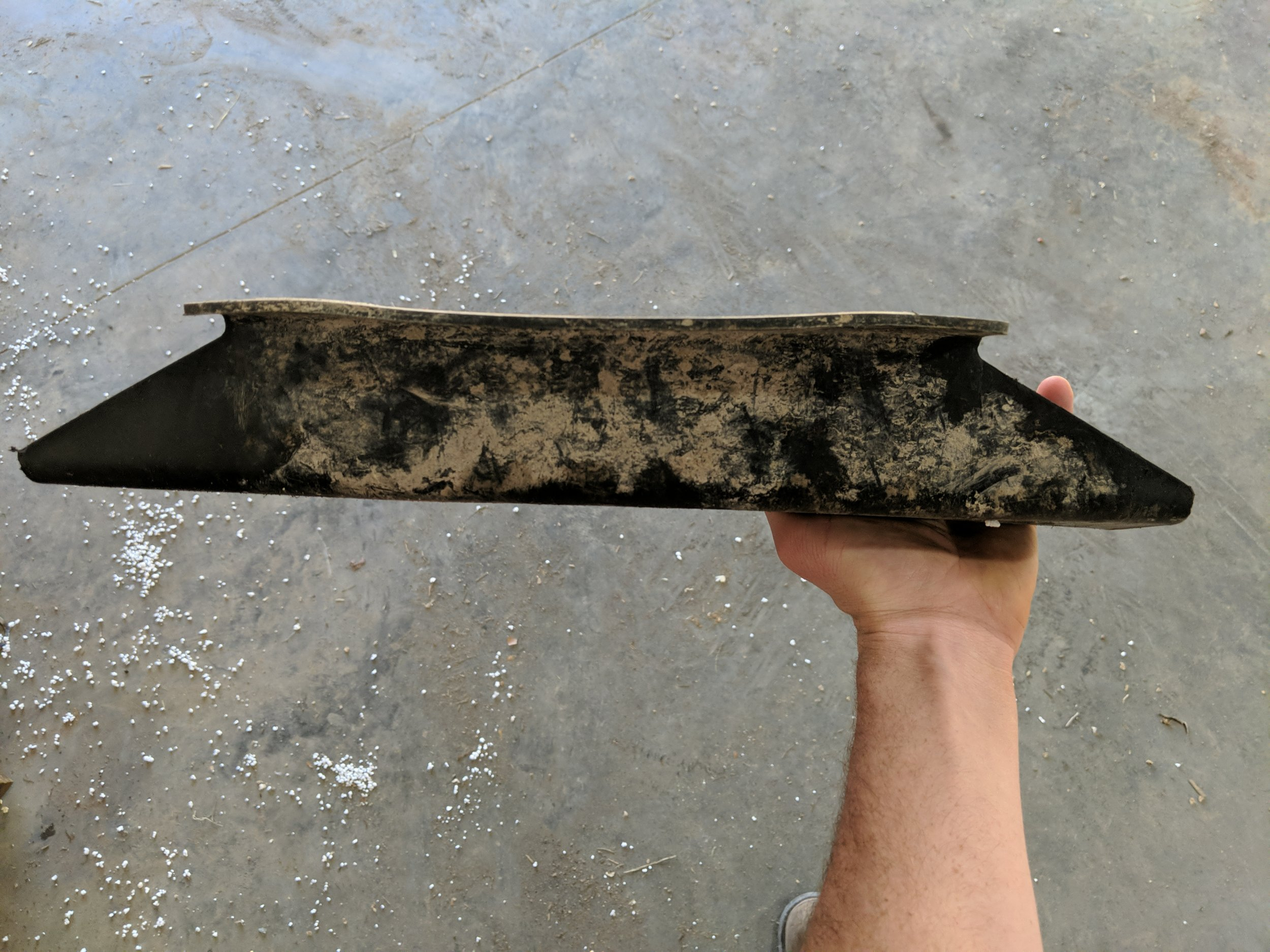

I have a Kioti Rx7320 that I'm using to flatten land I've cleared. This tractor is a complete beast, by far my favorite of all of the tractors I've owned. This tractor has a very well protected bottom (steel skid plates everywhere), however the 2inch fuel line that connects the fuel tanks on either side just had a piece of 1/4" thick plastic covering it.... I drove over a stump and turned it just right to pop the fuel line off and then drain the 18+ gallons of diesel... Annoying. My fix:
I got some angle iron, some flat plate (mobile home plates for setting the concrete blocks) and welded a proper steel plate for it. I should have taken pictures as I when, but here is the final piece bolted up (the rusty piece under the tractor) and the previous plastic piece.
I think it's a good solution and wanted to show everyone!
