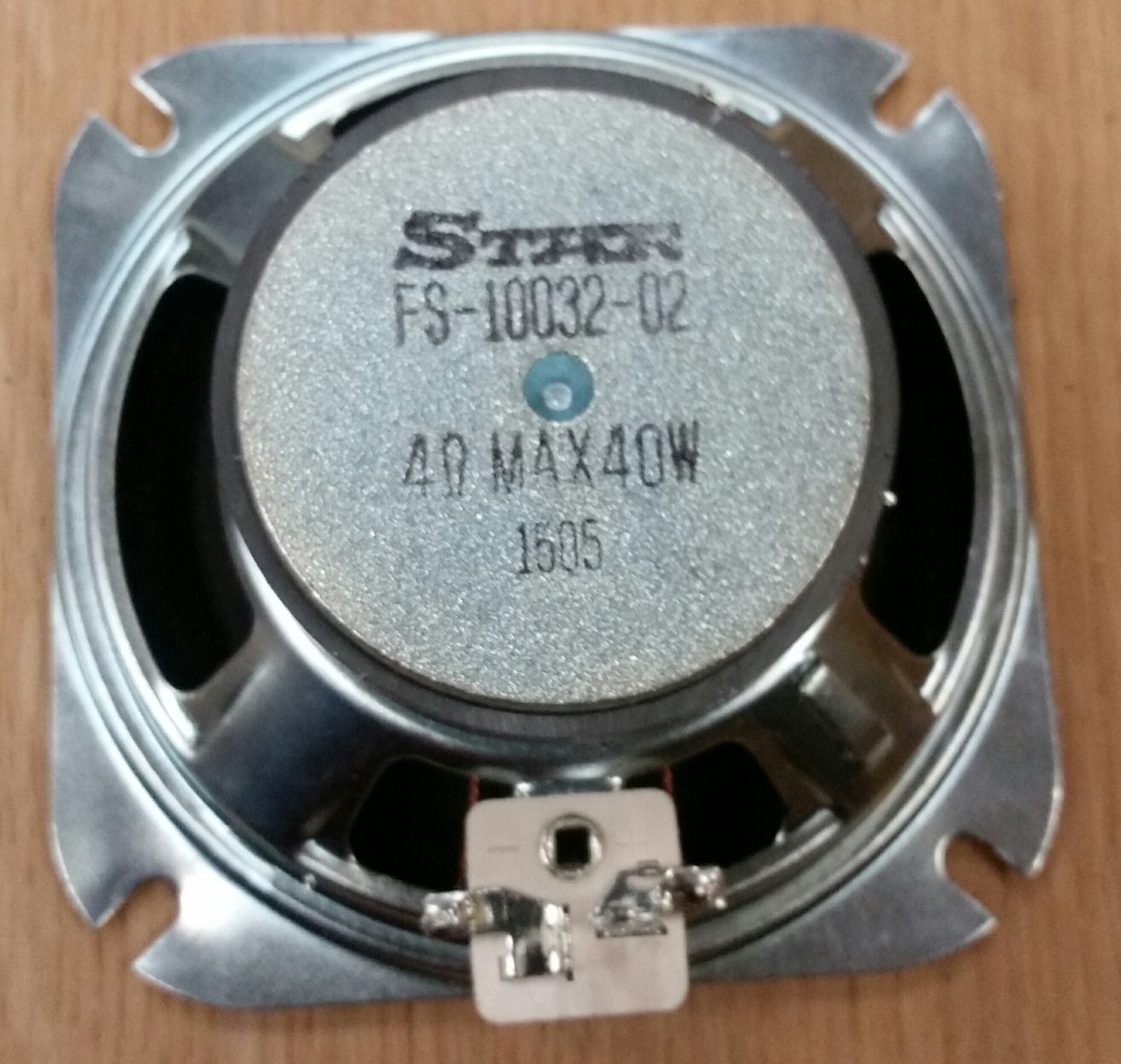

Mine sounds fine so far. It's what you'd expect. The speakers are small and cheap. But plenty of music comes out.

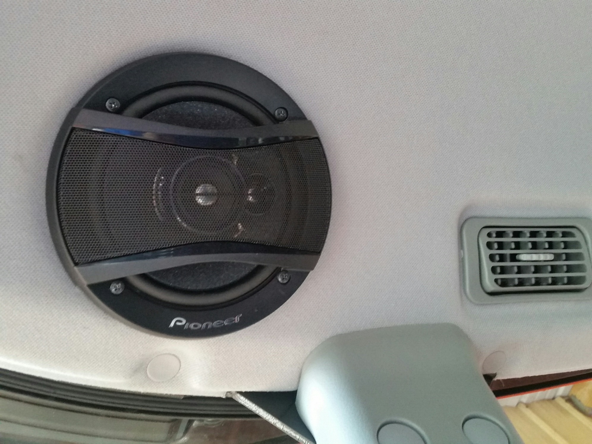

The speakers are cheap. I changed mine out to pioneer 3-way 6.5" speakers..sounded better but still not great so I ended up swapping out the Factory for a Kenwood Bluetooth radio..now is sounds great...and Bluetooth my phone rings in and can talk hands free and the wife couldn't tell the tractor was running. All in all a huge improvement over the factory cab NX radio
   / Kioti's Radio - Comments Appreciated #5
Did the 6.5" speakers bolt in or did you have to do any modifications?
   / Kioti's Radio - Comments Appreciated #6
Put in exactly the way the factory ones are. Just cut the opening with a razor blade to accommodate the new speakers, make new screw holes and you can reuse the screws and nuts used on the factory ones. You will need to lift the top to get access to even remove the old speakers so you can hold the nut from turning with the screw. IF you have a second pair of hands you can change them pretty quickly.
   / Kioti's Radio - Comments Appreciated #7
Speed clips are perfect for this. They hold themselves in place.
   / Kioti's Radio - Comments Appreciated #8
Yes, I used some Tinnerman clips on a couple of screws I had difficulty since I did it all by my lonesome..
If you have an extra set of hands outside to pull the magnet and seat the speaker while the inside person aligns, drills holes and puts screw in it can be installed quickly with origional hardware.
