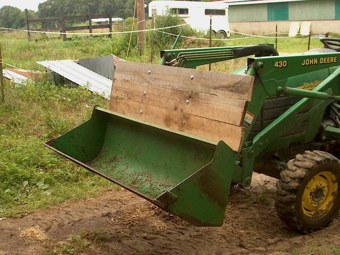

a simple thing to make my life easier
it carries boards and posts when i have fence to repair
and i can put my tools in the bucket

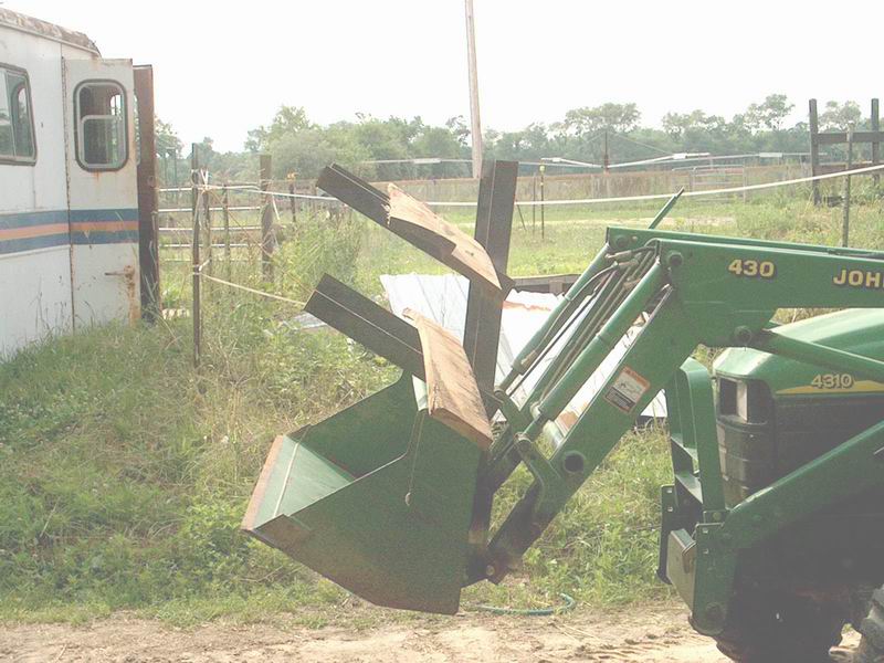

another pic

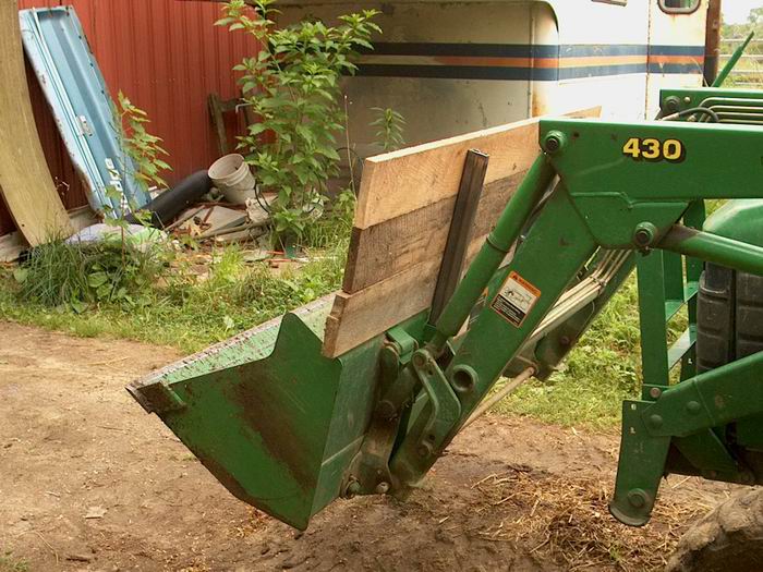

when i do something i always try to think what else might i want tu do with it
this is one mor app for the bucket mounts
when i load manure it always falls back over rhe top of the bucket and makes a mess
this stops that
   / KISS
another view

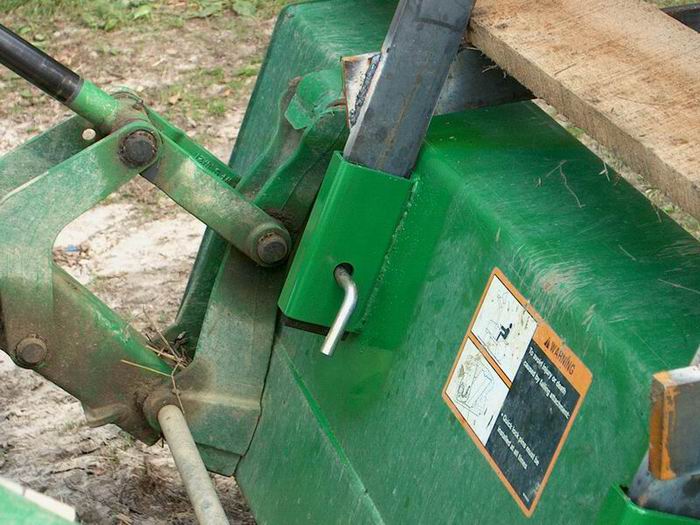

attachment mounts
i have other ideas for attachments that will use these mounts
for future projects
