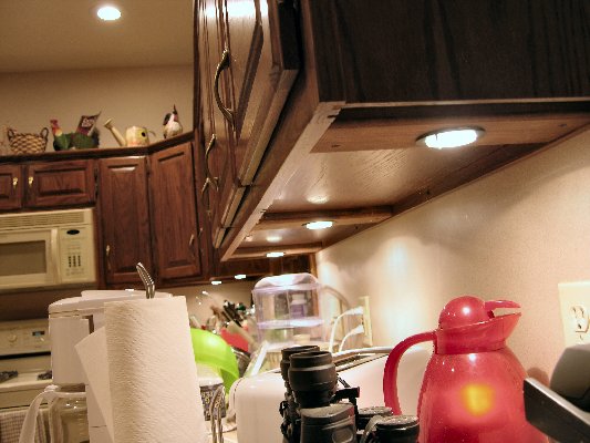

These are the under counter lights that I suggested. I cut the pieces of wood that they are mounted on, routed out the back to hide the wiring, and stained the wood to match the cabinets. The lights come on with a soft delay rather that immediate full intensity. Very nice touch!
