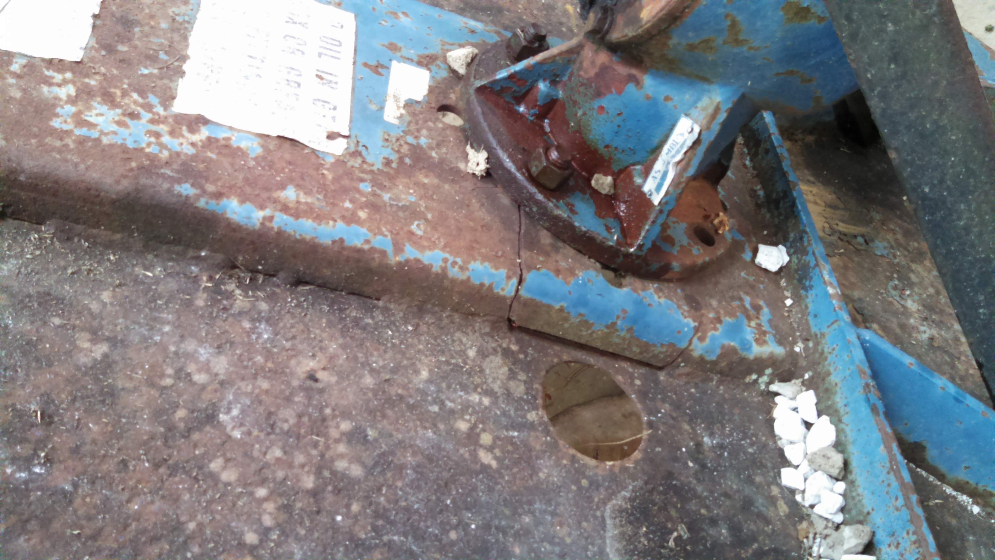

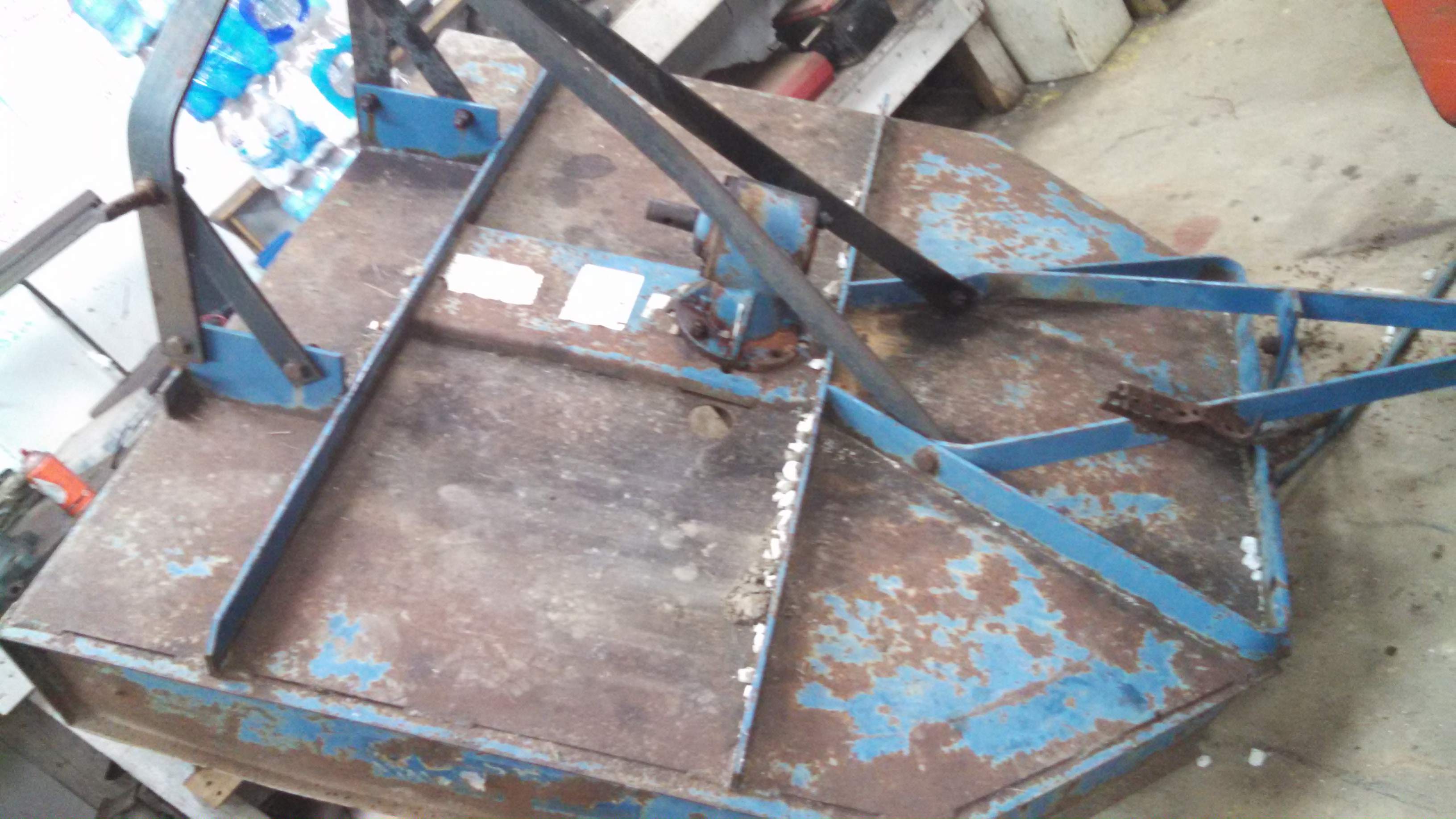

Just thought I would share some pics of a KK 60" cutter I just finished up.

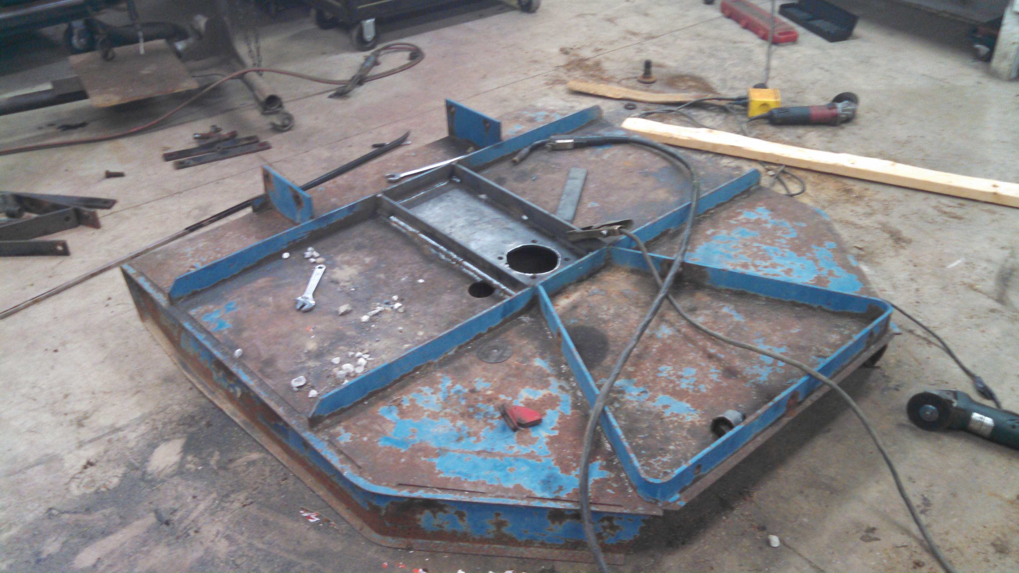

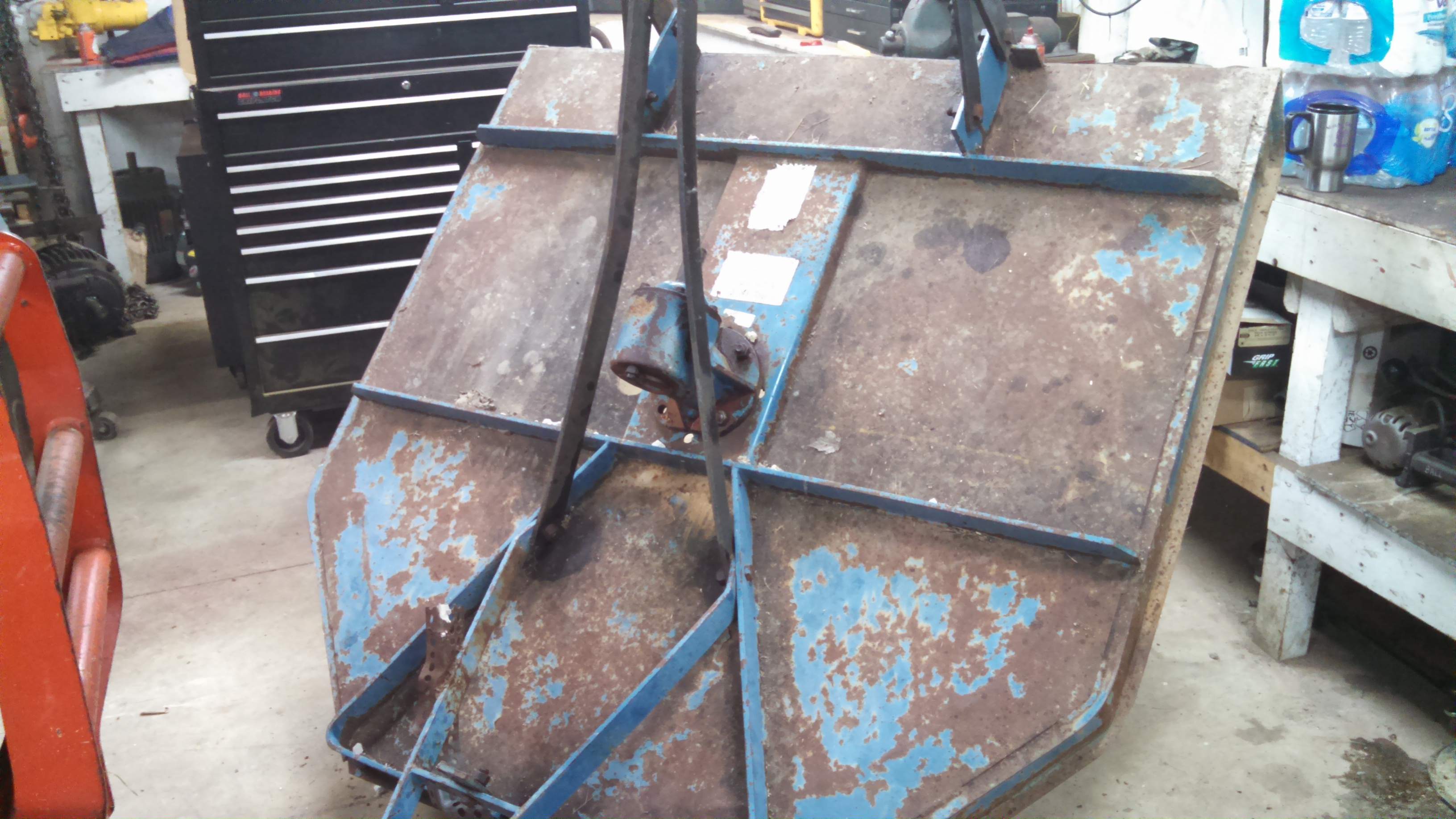

Had to get a new stump jumper and blades. And had to re-make where the gearbox bolts on cause it was all cracked. Then a coat of paint.
Here is what I started with:

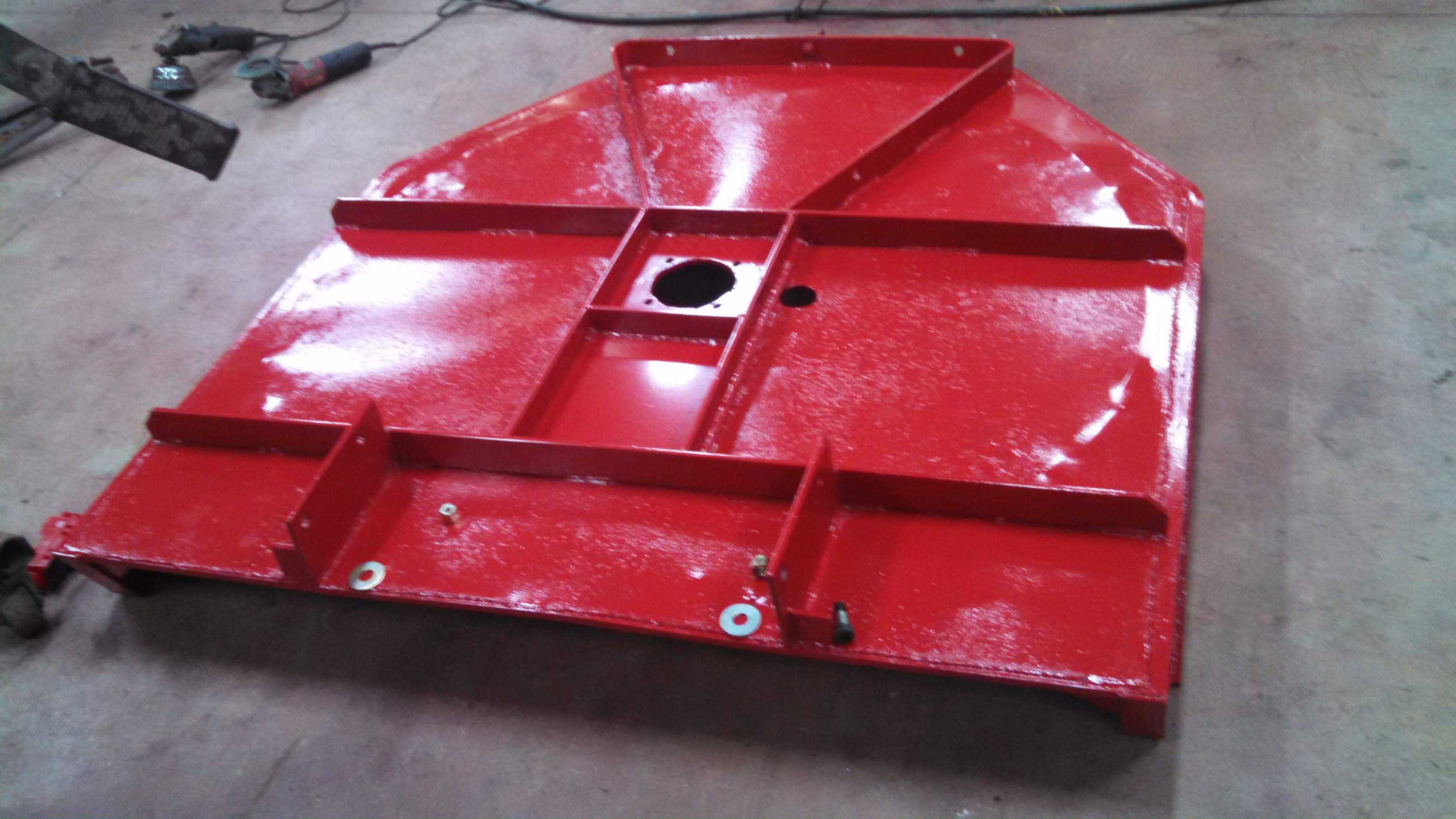

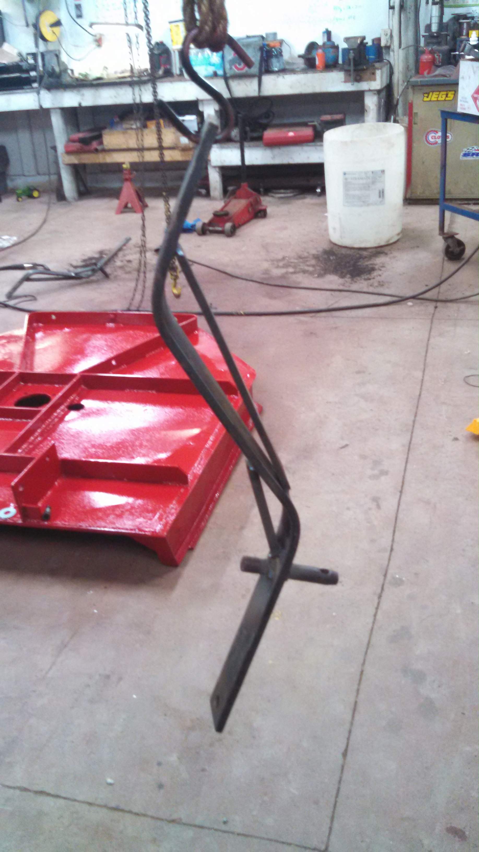

Here is how I did the gearbox mount
   / KK 60" rotary Cutter fix-up

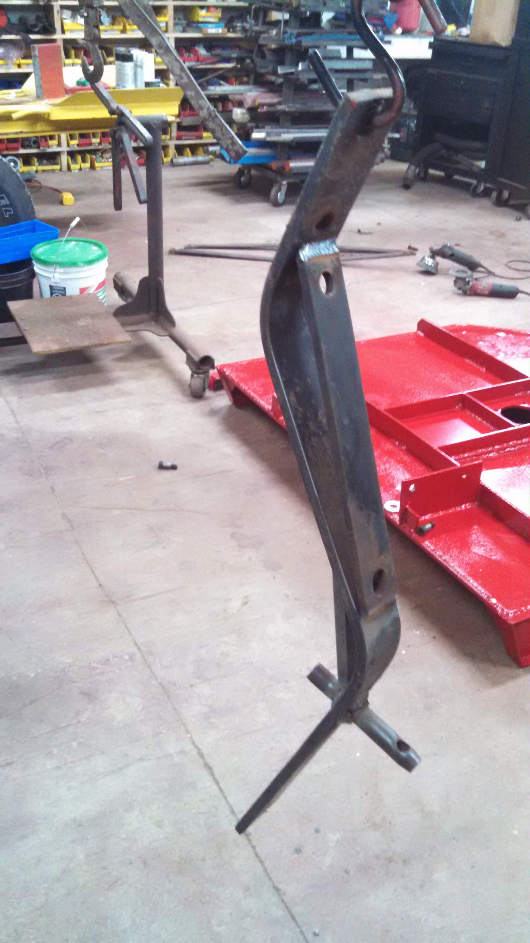

And some paint. I also got rid of the ridgid links and went with a swinging a-frame. Also added a few gussets to the a-frame for strength.

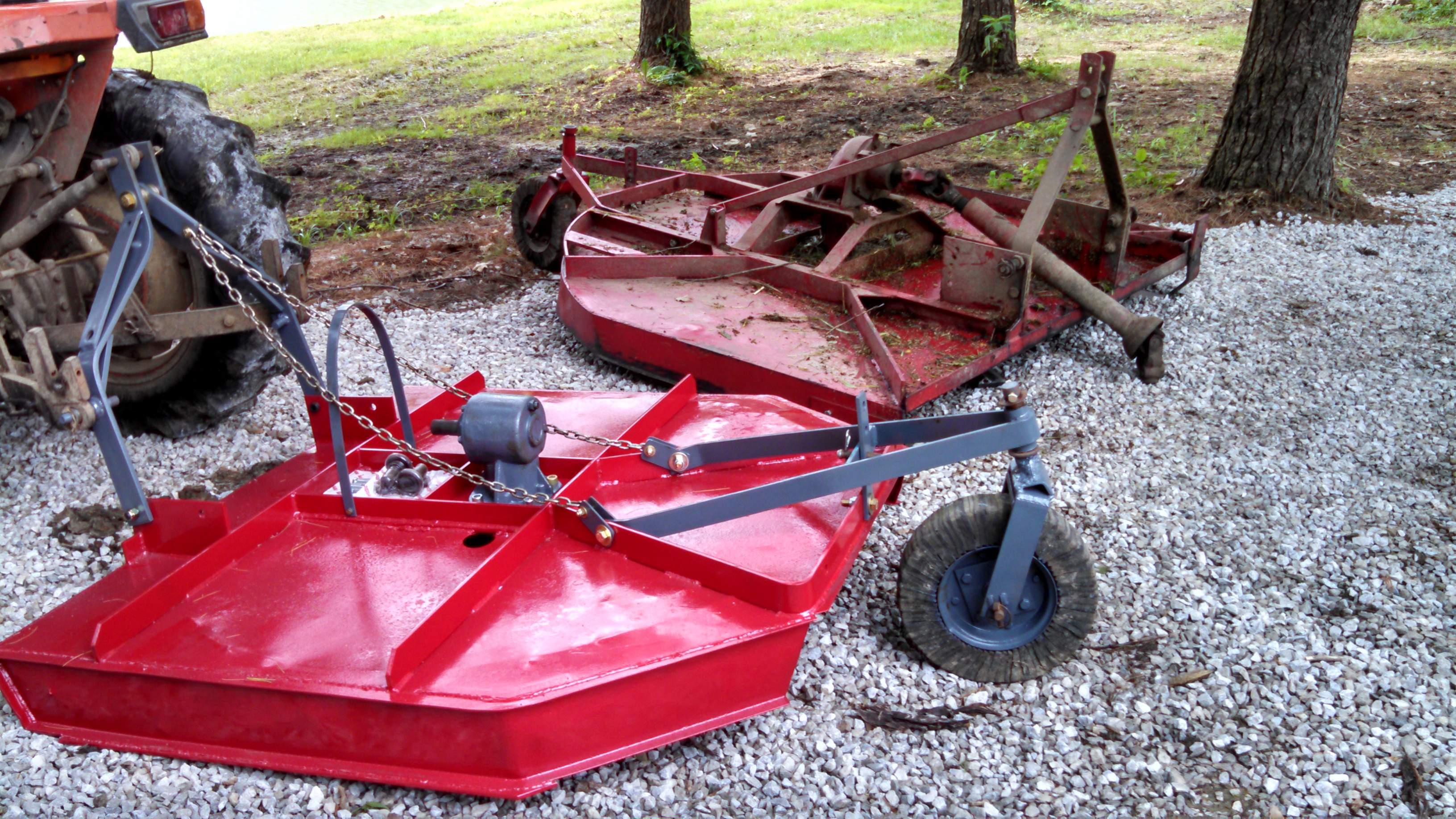

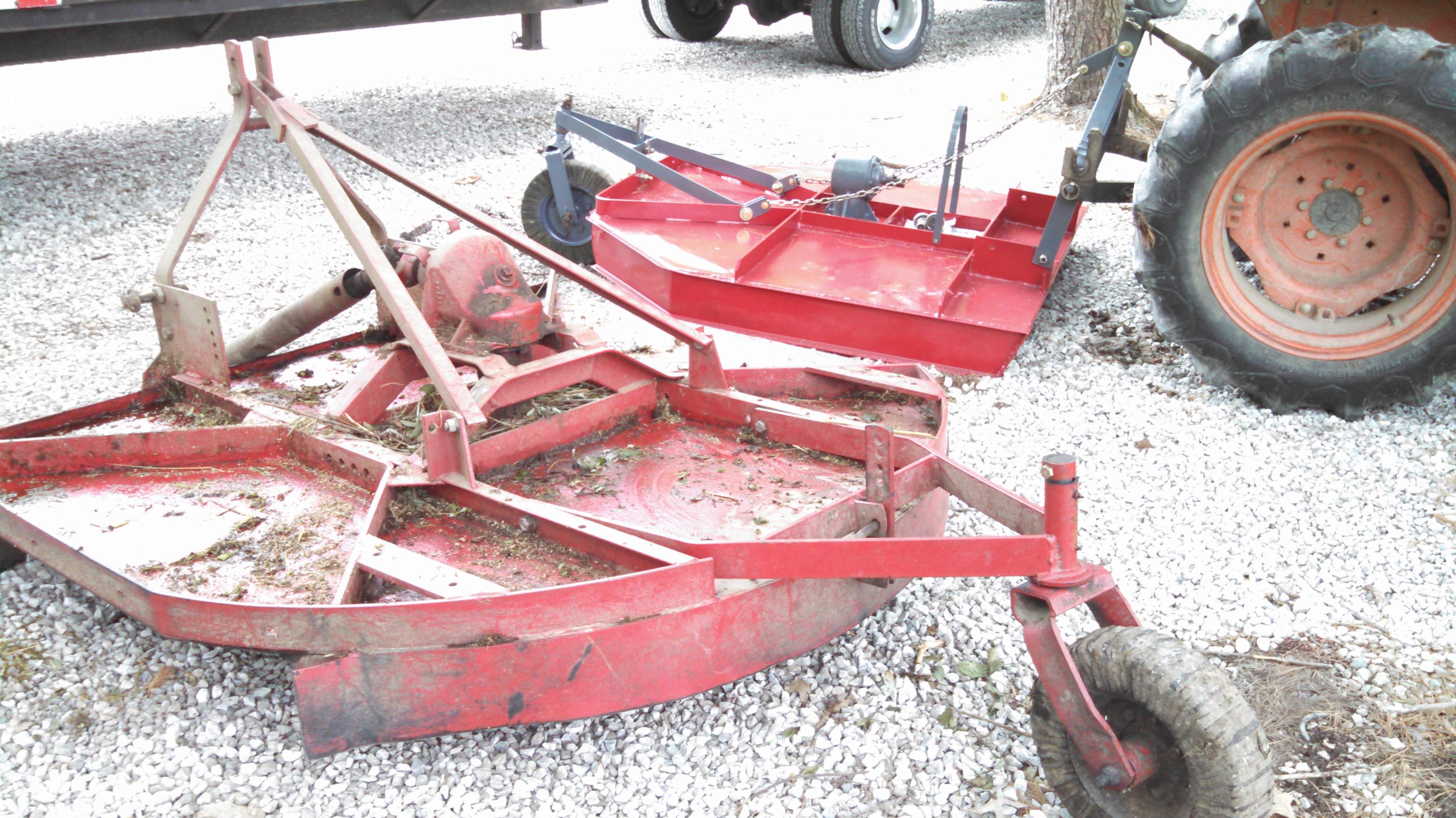

And here she is complete. An parked next to my bushhog 306 cutter for a pictorial of the difference between a 5' light duty vs a 6' HD cutter
