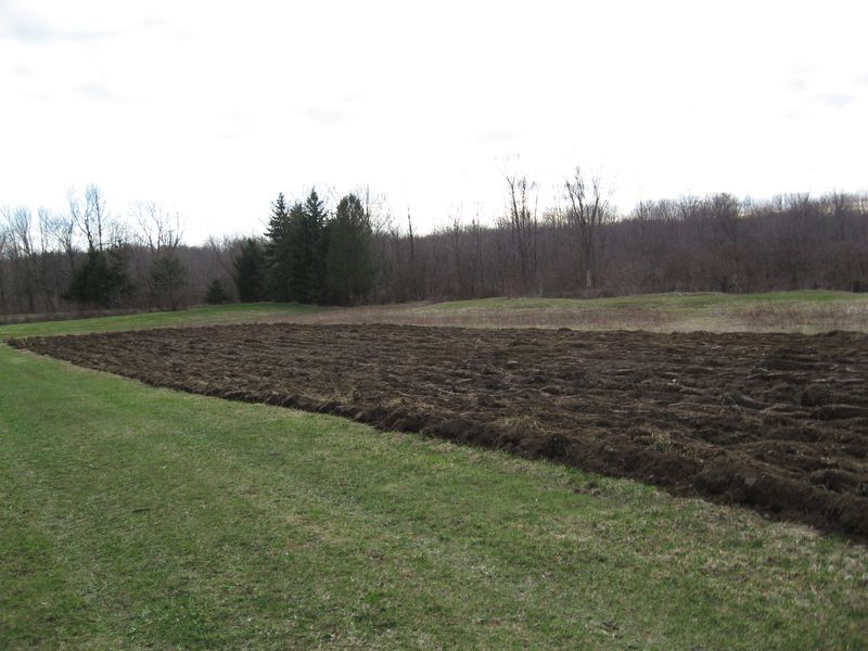

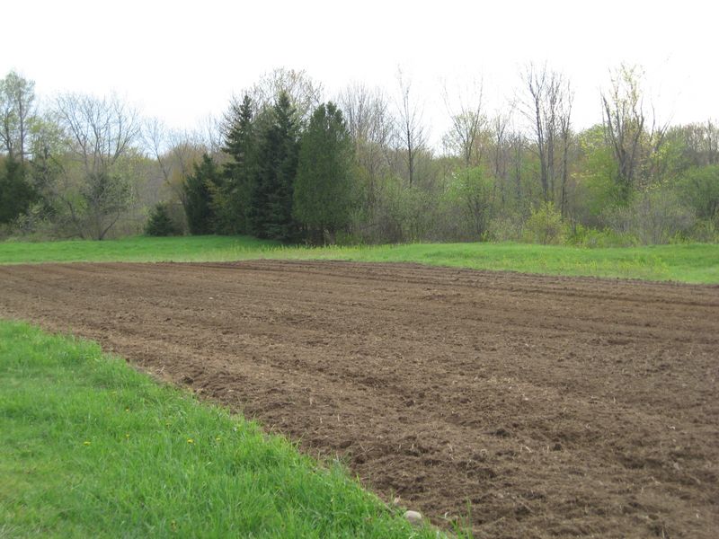

You will still have to go over it at least 2 times with the tiller to make a nice bed.

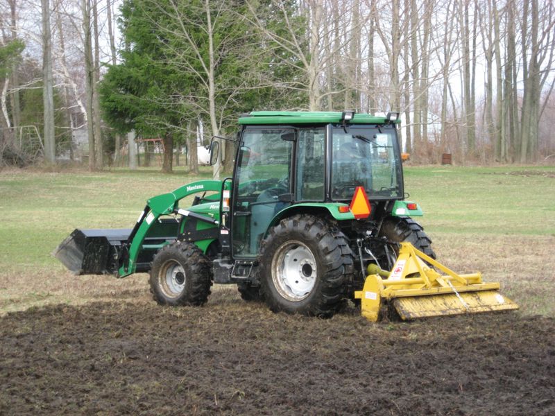

My KK tiller does great. It's hard to go slow when you could be dragging stuff and covering ground. Take your time and you'll have seed bed ready to go in one or two passes. Watch out for the big rocks. They can kick the tailgate out pretty far!
I used the tiller the other day to break up and smooth out a friend's riding arena. He ended up with some erosion from heavy rain and after using the FEL to reclaim the sand, we tilled it and packed it down.
