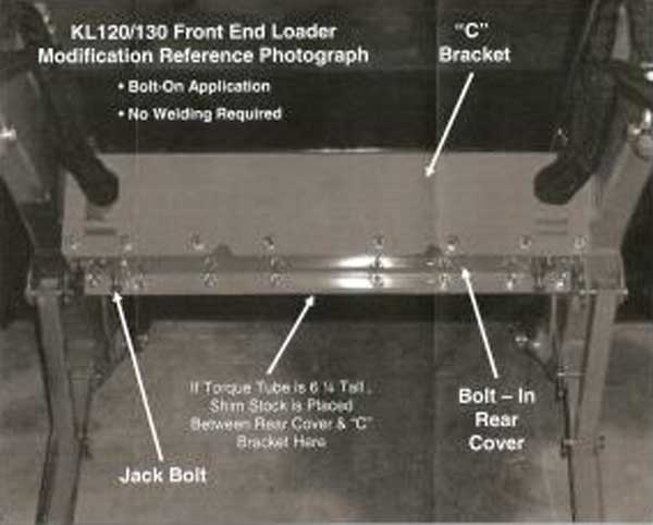

The fix is here for the Kioti KL 120 & 130 torque tube cracking issues. It is a bolt on fix and looks good too, I will try to post pictures. Your dealer should have details, there are serial number breaks, so give your dealer a call with serial number of your loader and get the parts coming.
Labor of install, parts, and parts shipping are all covered under warranty. Tractor transportation to the dealer is not.
Customer is going to be responsible for any labor costs after april 30th, 2007, so get these problem loaders to your dealer ASAP.
This program includes:
KL 120 with serial numbers 30519001 thru 60509061
KL 130 with serial numbers 20209001 thru 60510080

Yes I have a black and white photo kioti sent with update...... I forgot how to resize pictures to post them.
I believe this is going to apply to all loaders that fall in this category of serial numbers regardless of cracks or not is my understanding.
No they are not going to ship direct to the customer, I believe they want the dealers to install this correctly. I can service this for anyone in my area. I have 50 some loaders to do myself that I have sold plus I have already had a few customers call that bought at other dealers.
The loader has been revised after the serial number cut off.
Could someone please refresh my memory on how the picture resizing works? I will post the B&W immediately and colors once I have done one.

I took your photo and blew it up a little while getting rid of the white border for easier viewing. Thanks for posting it.
See attachment

Oh.... that's the kit..... wow, I guess it's better than my hack job, a little.
   / KL 120 & 130 loader issue FIX READY #10
It not what I would have expected but if it works then that is what is needed.
I'm surprised that it just appears to be a cover piece that clamps over the existing torque tube and has no apparent connection to the main loader arms on either side. I just figured it would have tied the two side pieces together with a reinforced torque tube. I guess I figured wrong (that's certainly happened before). It is also possible that the two main loader arms are somehow connected to prevent twisting but we just can't see it in the photo. I'd love to see multiple photos that show how they added rigidity. Its also nice to see a resolution come to this issue.
