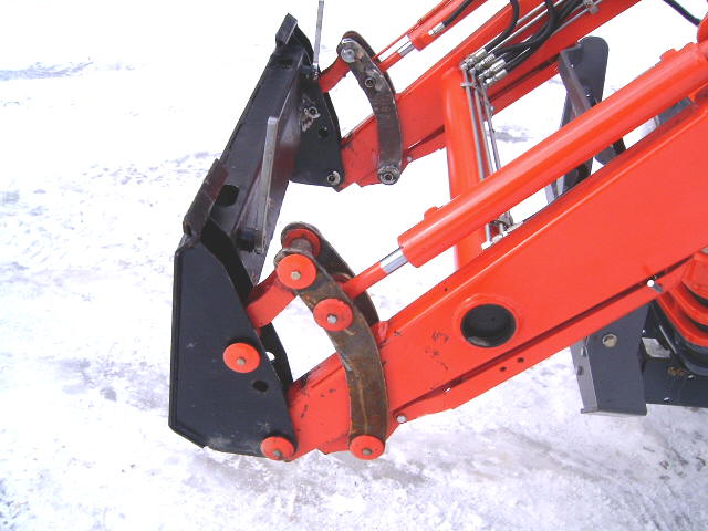

In previuos posts I mentioned I was dissapointed with the tilt power for my bucket.
I have been doing a few changes to hopefully help.
I made longer bracket where the cylinders attach and moved the pins on my quick attach up 3".
I still need to dissasemble and paint the new pieces.

Another

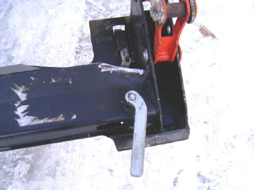

I had to trim back the quick attach a bit for the pins.

I also bumped the loader pressure up to 2400 PSI (I'm not recommending this, but I'm doing it !!)
I still need to test the tilt cylinder seals for any leak by.

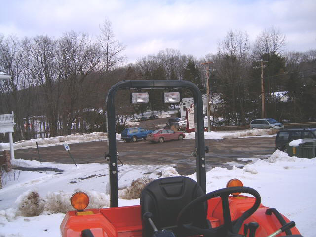

Also added a set of lights to the ROPS.

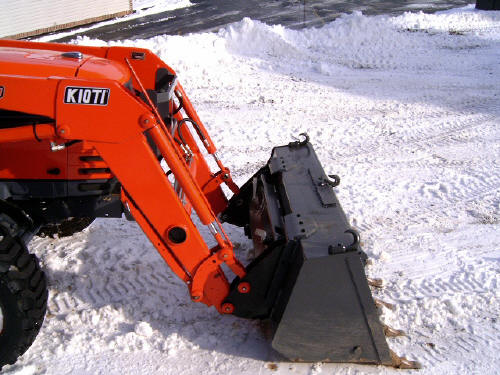

Here is a picture of what the original bucket linkage looked like.
