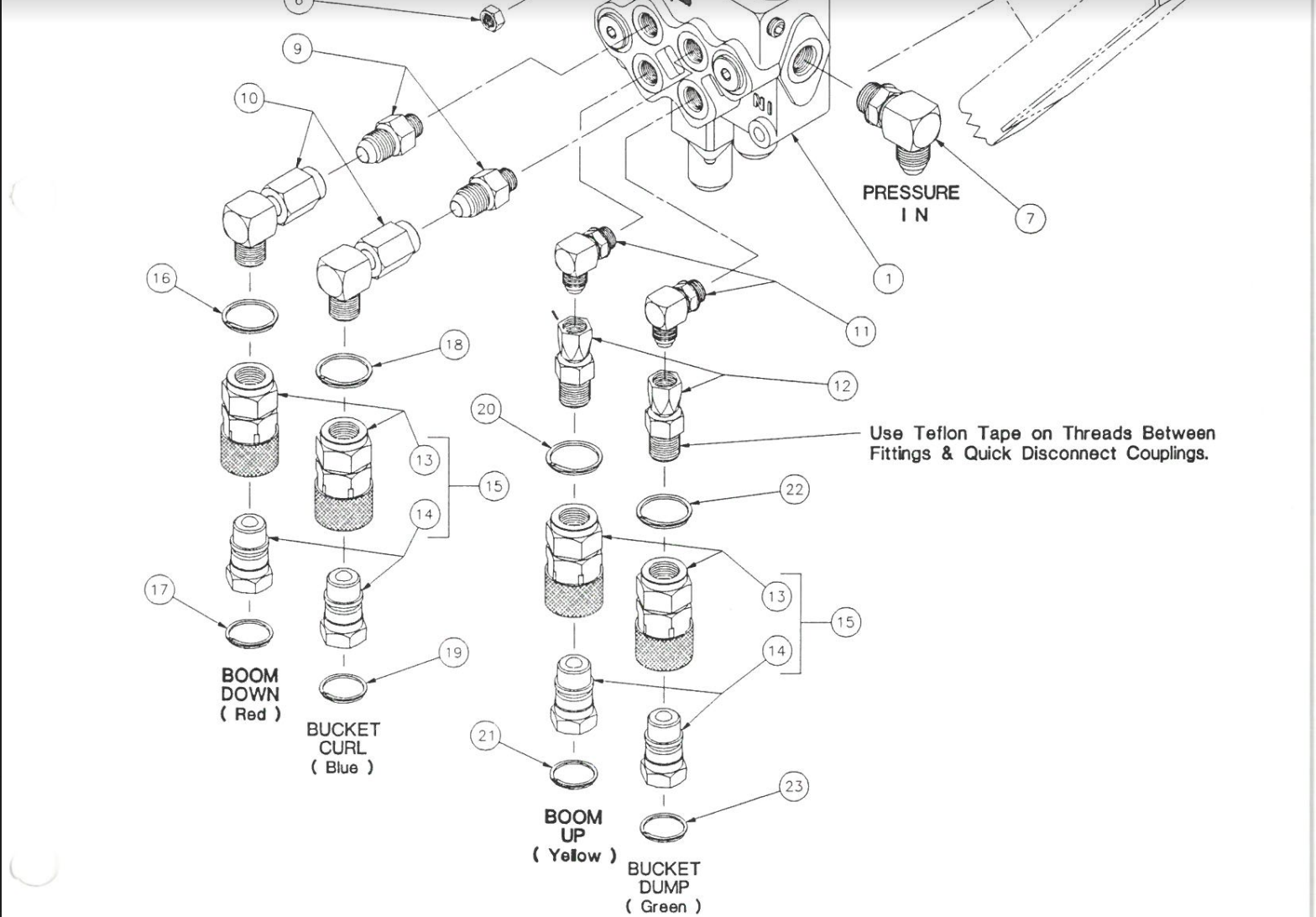

Looking to double check my hoses going from the control out to my rams. I hooked them up the way they came but I want to make sure. Any help out there?

If it is just the ones going to your cylinder you will know when you move the control lever. If it functions the same as before you are good if not just swap the hoses till it does. Just trace the lines and keep the lift cylinders on the same spool and the curl ones on the other set. This way you only will have to change it once if it is wrong.
   / Kl 254 FEL hose placement
Does not look as though there is much interest in my question but I did find an answer. To anyone with a similair system. My kioti dealer helped me out
