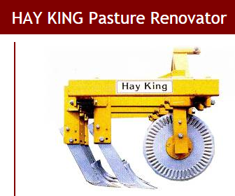

Instead of ripping riddles across the pasture to get better irrigation distribution, I was thinking of using knife slicers. I have a box blade with the typical shanks. Does anyone make knife attachments or replacement shanks (Landpride unit)? I have already tried a small disk unit with no luck. The concave disks wanted to lift and tear the sod. I want to cut about 4" deep and not rip up the sod as the current shanks do. Slice ridges are OK, I just dont want sod chunks everywhere. A sub-soiler might work, but I cant afford another piece of specialty equipment unless the shank sections might fit my box unit.
Thoughts - Thanks Keith.

Have you investigated pasture renovators such as this one? I think you'll need colters to slice the turf.

The Hay King Pasture renovator's shanks like to pull rocks to the surface where I live. Some hay farmers have tried them and the hay equipment did not like rocks pulled up and destroying the cutting blades. The Aerway style is not the rock seeker like the Hay King.
