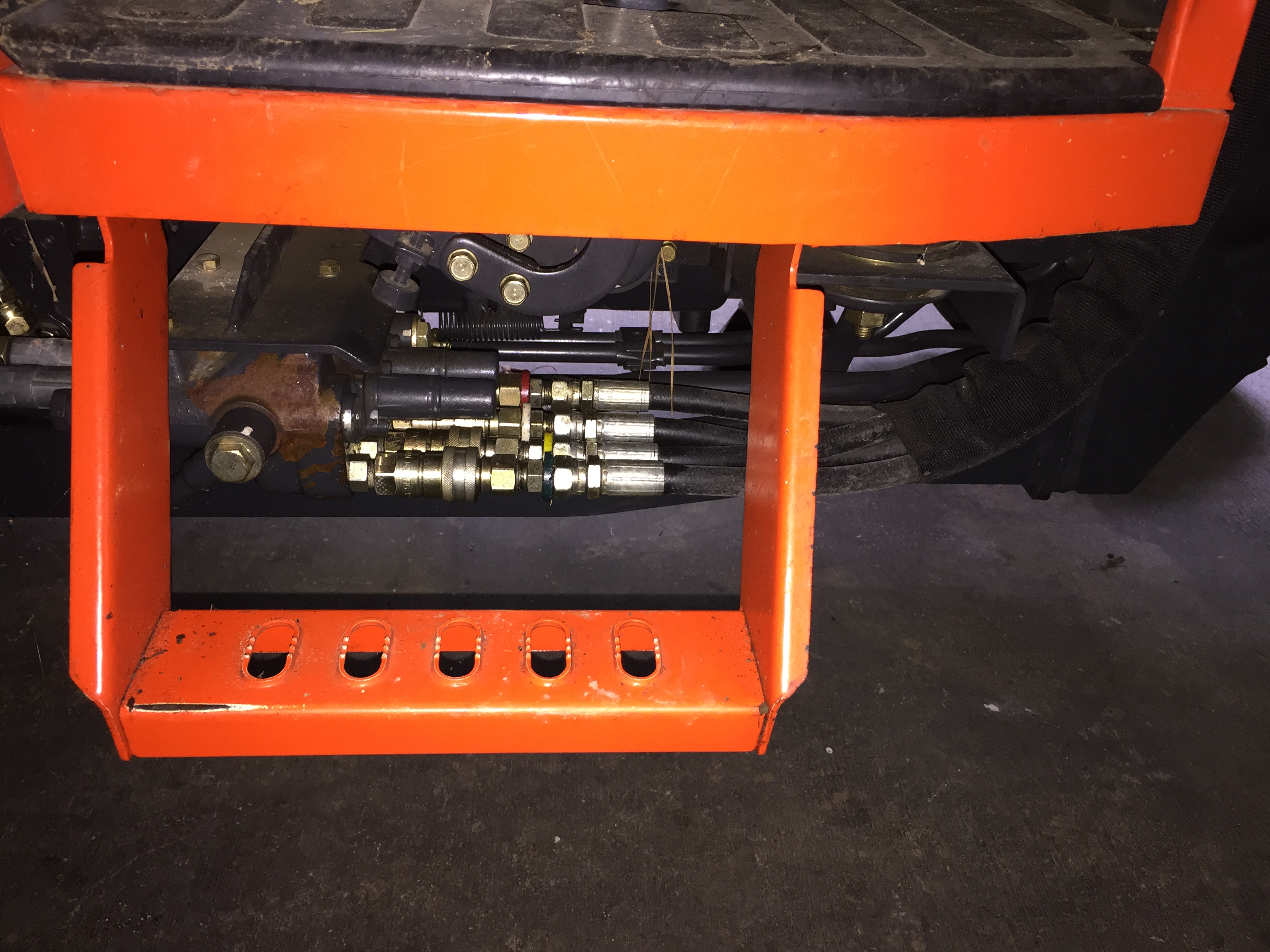

Hey folks - I have a 2013 DK45SE that I have had for about a year. I really like it and it is perfect for my use. BUT..........i have an issue I hope someone has a suggestion or fix so I don't have to "reinvent the wheel (or in this case a part)"
I am frequently hitting the loader's hydraulic connections under the tractor with debris and knocking the connections off. That is a pain because typically the loader is under pressure when it happens so you have to release the pressure before re-attaching and that is a messy process unless you enjoy hydraulic fluid showers.
It needs a "skid plate"/cover to protect the connections. My questions are - others having this issue, does anyone know of a cover that can be purchased or has had one made and can share pictures, plans,materials, etc.?
Thanks'
Steve

First, Welcome to TBN! :D
Think many of us DK owners have been and done that. Murph1 had a plate made, and had an extra which he sent me. I tried to fit it but no joy.
In the meantime I'd recommend you put colored cable ties to match up your male to female ends under there for now. I see some remnants of the colored collars from the factory but the two outside hoses seem to be missing them.
I seem to have managed to not disconnect them in recent times- maybe set in my mind the Achilles heel of our DK series tractors, and I just steer clear of things that might cause issues.
One idea would be to take a clear trash can liner and twist it up until it is like a long snake and then wrap it around the area where the QDs are being forced apart by errant brush. This wrapped tight plastic does a good job of making a removable shield to keep branches etc, from being able to hit the edge of the female QD, which then disconnects the hose from the valve body. If you cable tie the ends to the QDs, you can then, if access is needed, cut the cable tie, disconnect the QDs as needed, and rinse/repeat as you reinstall the loader assembly. I used this method to tighten up the additional hoses I had run through the valve body area for my loader torque tube install of QDs for my grapple and or snowplow, etc.
It's much easier than trying to fit a solid bracket that is near impossible to design due to all the hoses, fittings, lack of space, etc. inherent to the: 'where's the engineer who designed this cluster- ...k! @%&
If only I could find his neck to grab him by it to shake some sense into him/her...
Good luck Mr. Phelps, in your mission, if you decide to follow through.....

Just thinking here, but you could cut short sections of EMT or PVC conduit slightly longer than the distance from the valve to the quick coupler collar. Then disconnect the hoses, slide the "pipe" over the hose, reconnect, and then slide the pipe back over the female coupler. That would keep branches, etc, from pushing the collar back.

I would be moving the QC up higher and where you can reach them.

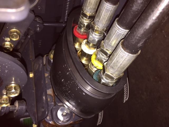

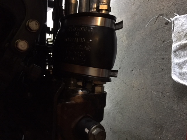

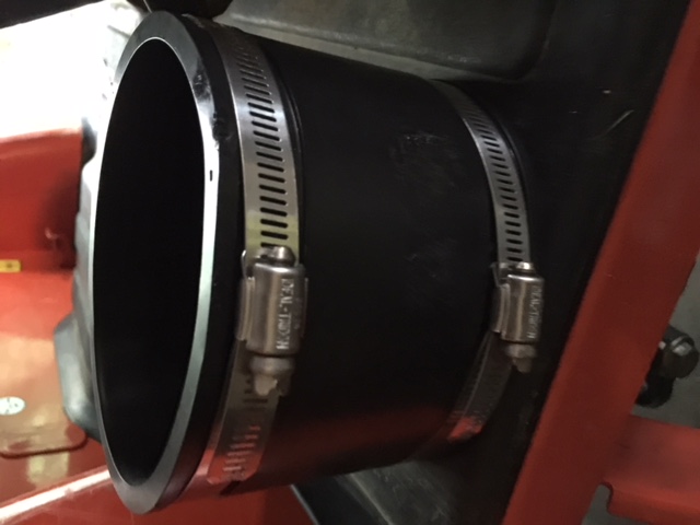

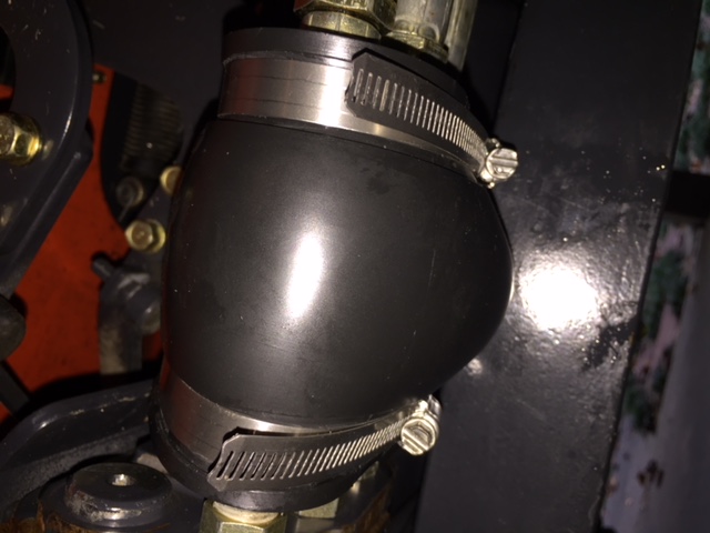

Okay folks - what I have used is a 4" plumbing connection. I have included pics as promised. I bought it at Home Depot. I had to get one big enough to fit over the entire cluster because there is not enough room between the QCs to do them individually as I originally planned. We'll see how this works.image1.jpegimage2.jpegimage3.jpegimage4.jpegimage5.jpeg
I have learned to be more careful when backing up (especially after I stripped all the blades off the cooling fan) but sometimes you are pinched and have no choice so hopefully this will help!
