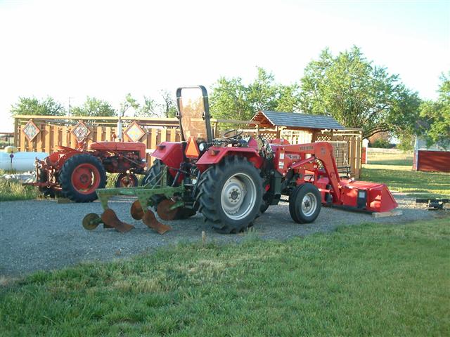

Mahindra will give you good value for your money. Mine is a 2008 Mahindra 5525 (54 hp engine, 45 hp pto, 2WD, gear tranny 8F/2R, power steering) with the ML250 FEL (6-ft bucket, 2950 lb lift to 10.5 ft). Also have a skid steer quick attach adapter on the FEL arms (highly recommended). About $19K invested in that rig. My place is 10 acres, flat, 6 acres in hay (Kanota oats).
