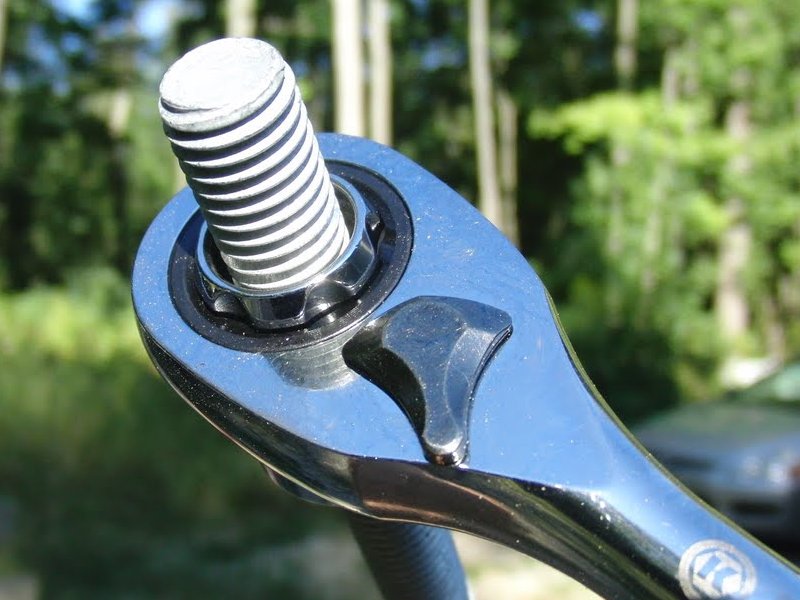

Anyone else use these?
I'm building a deck and keep running into scenarios where I'm bottoming my sockets out on carriage bolts, so I thought I'd give them a try.
I have to say they deliver. The fit between the socket and the wrench is a little loose for my taste, but I think this overall design has legs, and just needs to be built to a little closer tolerance. The ability to just keep on crankin' without bottoming out is really nice on projects where your fasteners come in 2" increments. I don't think I would try to use them on anything that requires serious torque, but they definitely have their place.
I do wish companies would stop with the laser etched sizes though, that stuff doesn't last. I'm sure it's cheaper, but I have sockets that are 30-40 years old that I can still read without a problem because the size is stamped into them.

I like the looks of them. I don't think they will be in my tool box at the hangar, but think they would work awesome on various farm projects with all thread.

I have a set for the exact same reasons you bring up--I kept running into situations where I would bottom out with a standard set.
I have had mine now for about 1 year. So far, so good. I have been happy with them and they were worth what I paid for them at Lowe's--maybe $50.

I have a set of through sockets and the accompanying drive tools I find handy for certain things. Not a new idea..I've had mine probably 20 years...
