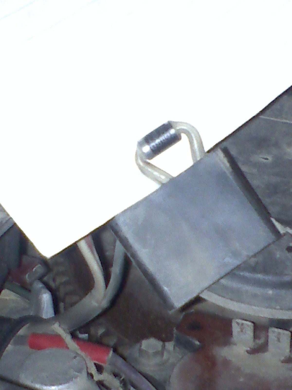

I havent had a chance to look for a wiring diagram, but there is a diode or something that is burnt in two. (see picture) diode.jpgThis is on the plug that plugs into the coil. This is a 2-cylinder 25HP kohler motor. The plug has 3 slots. Red, White, and black wires. There are two wires together in each slot, I assume the second wires feed the other coil. This diode thing goes between the red and black.
Just wondering what in the heck it does and why it may have "popped". Cause I can start and run the mower and it runs fine. And no, it isnt just running on the other cylinder either. This cylinder is actually firing.
Thoughts??opinions???

Might be the rectifier-regulator. Is the battery charging? Check the battery voltage with the engine running and without. It should be higher with the engine running.

Quick Update:
Got the following numbers/letters around the barrel
PK
IN6
277A
1.5KE
18A
0849
For whatever its worth???
And heres a diagram if you want. Page 38 I believe http://www.kohlerengines.com/onlinecatalog/pdf/sm_24_690_07.pdf
It dont show in the diagram. But it appears to just be a "clamping" diode. Used to dissipate the voltage spike cause when the coil fires. (I had to refer to the old college textbooks for that)
So now the delima. What to do?? There is a diode on the other side, and these are wired in parallel, so??? Wouldnt the one good diode still work in this circuit?? And since they arent even shown on the diagram, perhaps they dont use them anymore??? And if one ever failed, how would one even know cause everything still works fine??? The only way I found it was when the diode split in two, the two halves were still barly touching. Creating some smoke when key was on. But if something happened while mowing, and vibrated apart, one would never know. I really dont want to have to replace the whole engine harness which looks like the only good way short of trying to take the connectors appart to solder in a new diode and hope you dont break something. (connectors are a PITA.)
Additional thoughts? Opinions?
Edit, forgot to mention that this is a 27HP. Model CV740S

Those are very much still in use. Except now that are between the wires on the electric pto clutch. The problem kohler was having with there spark advance modules was the electric clutch winding down to a stop was causing voltage spikes that were frying the ignition modules. This problem was also frying the ECU modules on the EFI engines,
Heard a story a few months ago concerning a Kohler EFI engine. The technician had his laptop connected to the diagnostics port for the engine. The engine and pto were running and when the guy shut off the pto, which didn't have a clamping diode installed fried the ECU on the engine and also fried his laptop.
   / Kohler 25HP Diode thingy on the coil?????
Thanks for the reply. This is not an EFI engine though. Still has a carb. Just the fancier ignition BS:confused2:
