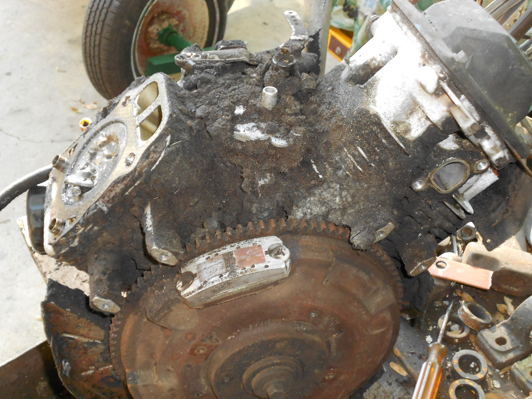

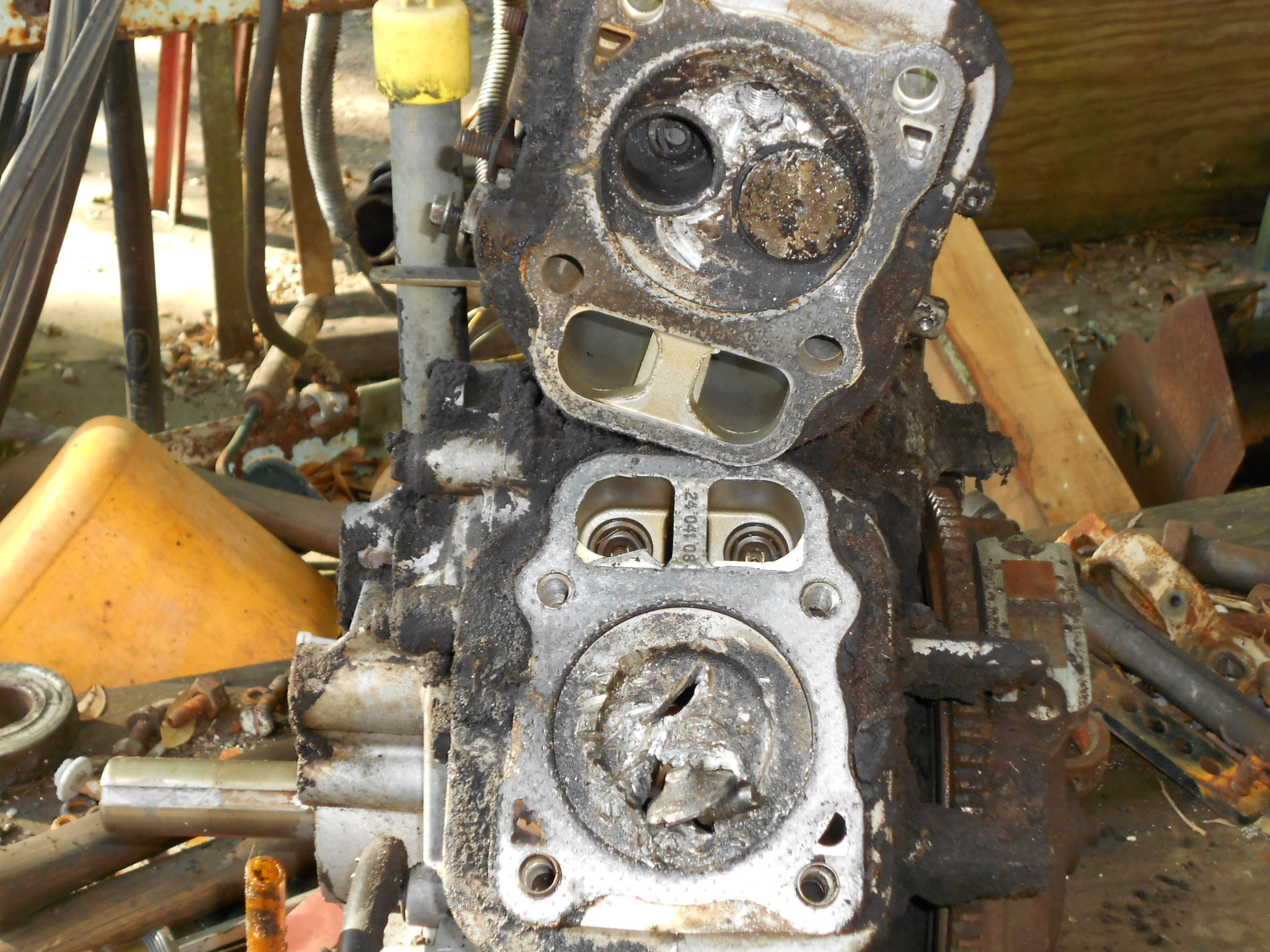

You don't say how old/hours?
Here is what happened to a 22 hp Kohler when the fins clogged up and it was overheating.
Exhaust valve stuck open and it ate it.
It had 3200 hours on it!
