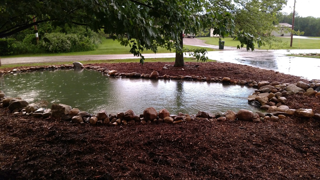

Fast forward to today, I have moved. Back in may I dug another ornamental pond. Bigger this time. Approx 20x50, 5-5.5' deep, and about 14000-15000 gallons. (based on the number of hours it took to fill with a 6GPM well and 7GPM city water tap).

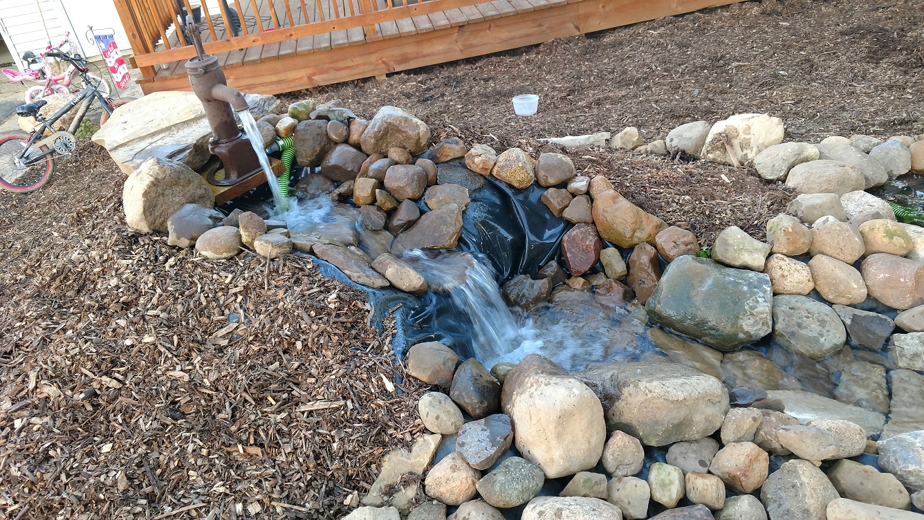

This time I have a 3600GPH pump but no fountain. It feeds just a waterfall. But it does NOT pull water from the bottom. Rather from a shelf ~2' down.
the bottom is flat and ~4' wide x 3' high to the shelf x ~30-40' long. So there is a good 3000 gallons + water well below where the pump is. And the pump is at the end where the waterfall is as well.
Pictures of what the pond looks like.

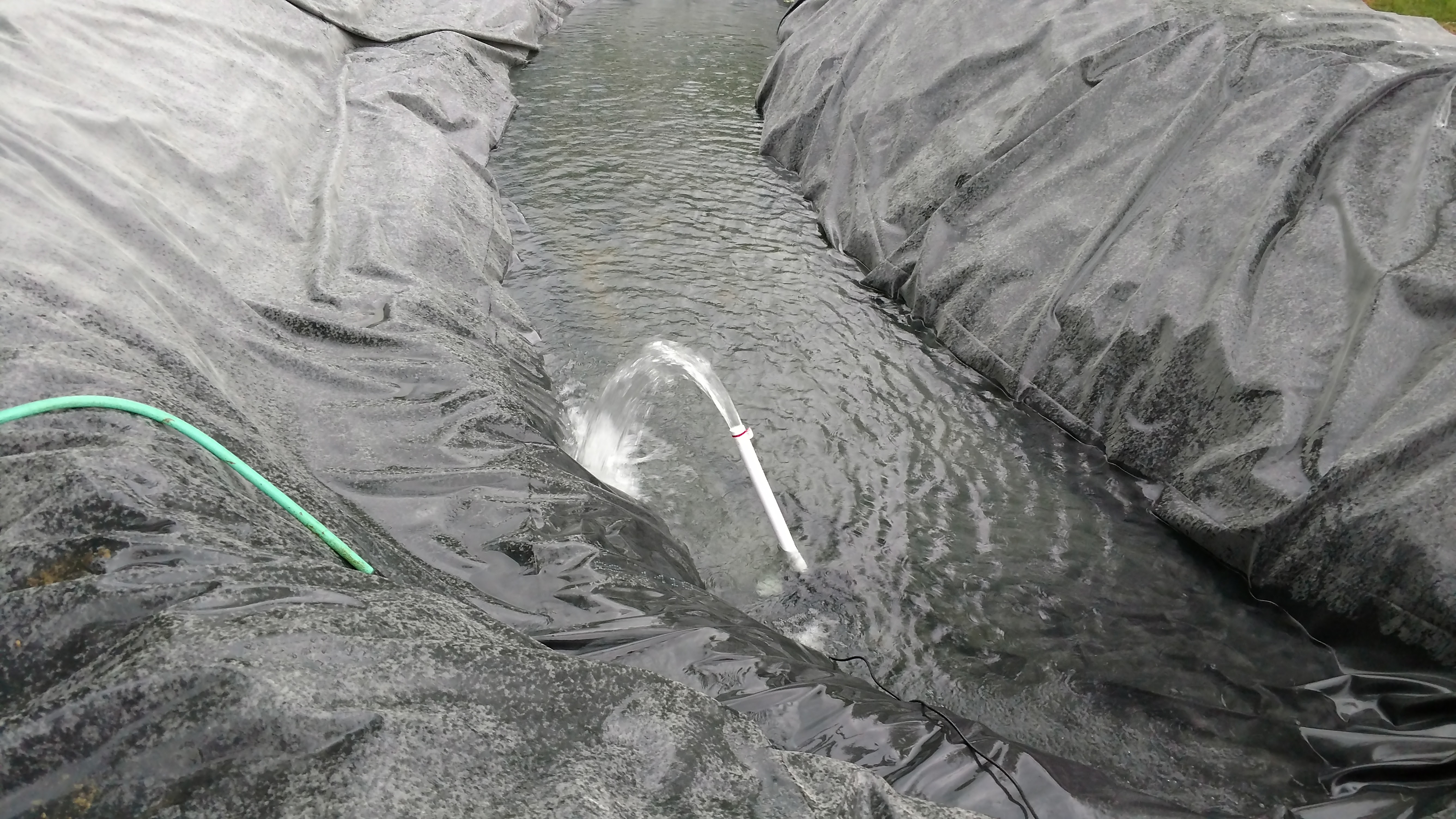

And this picture shows what you cannot see now that their is water in there. It shows the wide flat bottom and the shelf to the left. That shelf to the left is where the pump is, up in the corner where the waterfall is. The pump is in the bottom in the pic just cause I was testing it out to see if 3600GPH was gonna be enough water movement for the sound I wanted.

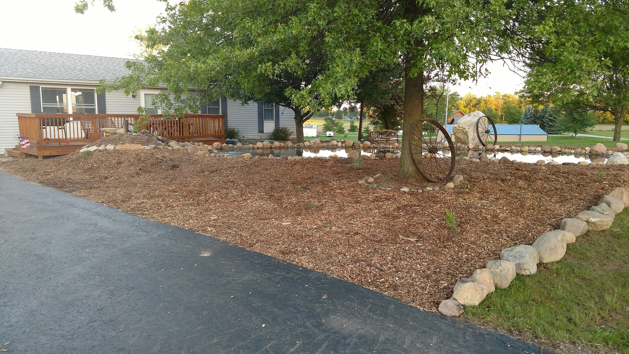

So now that you can see the layout, and how the pump and fountain are situated in the pond and at what depth.......what would you do for winterization that will allow my ~50 or so ~3" goldfish to survive a central ohio winter?
Would you just leave things as is, expecting that the water where the fish will hibernate wont be disturbed and will maintain a warm enough temp from the ground?
