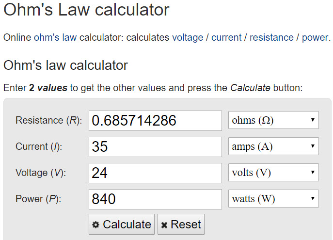

That glow plug indicator on my D20A-6 burned out too, maybe from leaving the glow plugs on too long? When it failed, I pulled it out then used a hole saw to punch a 2" hole through the dash, then fitted in an amp meter. The glow plugs on mine draw around 35 amps when cold , then rapidly and steadily drop to 25 amps in about 10 - 12 seconds then I fire it up. Glow plug resistance measured with an ohm meter will be near dead short on a cheapo meter (less than 1 ohm for all 4 in parallel) as the elements inside the plugs heat up resistance increases drawing less current.
