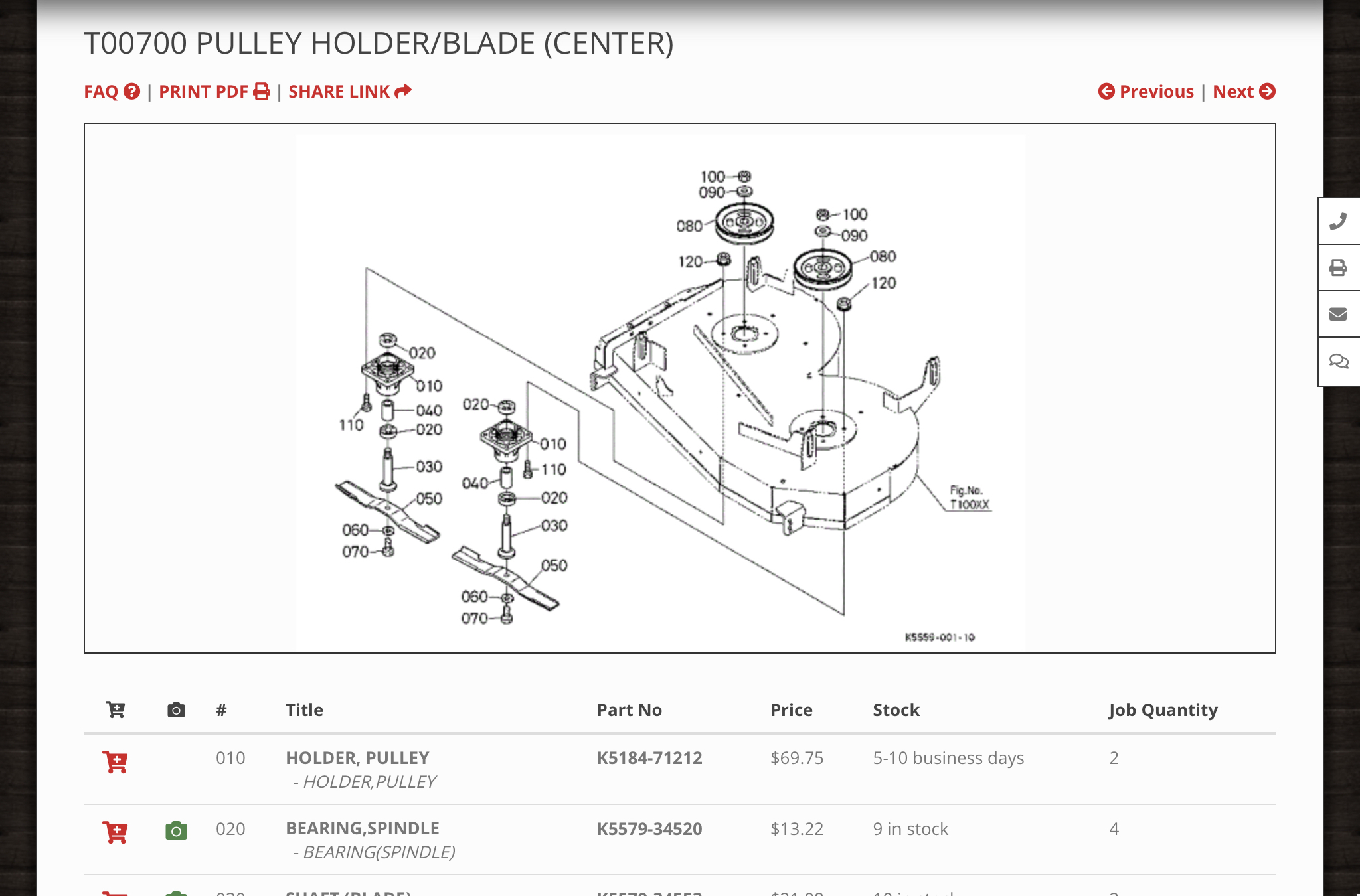

Anyone know if the spindle assembly on the 122r-42" is a sealed unit or can the bearings be replaced?
thanks

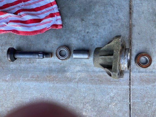

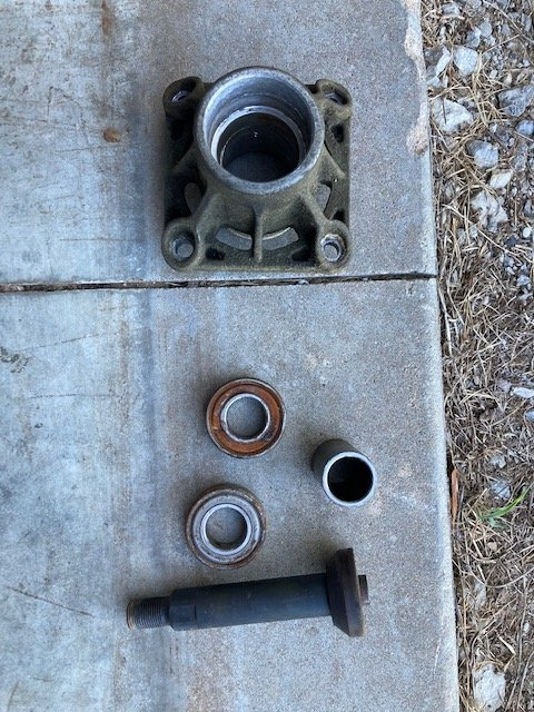

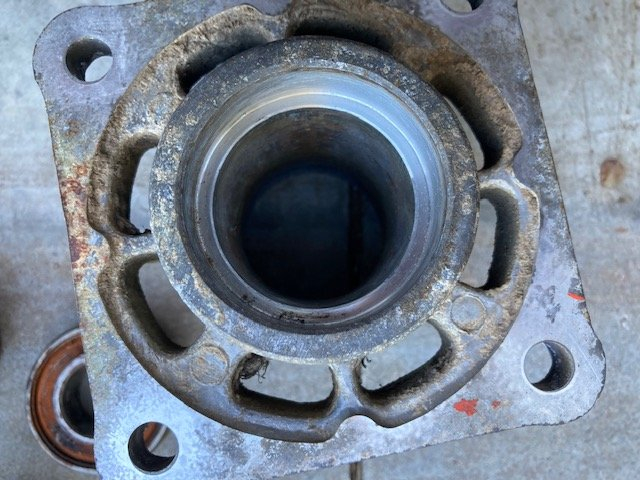

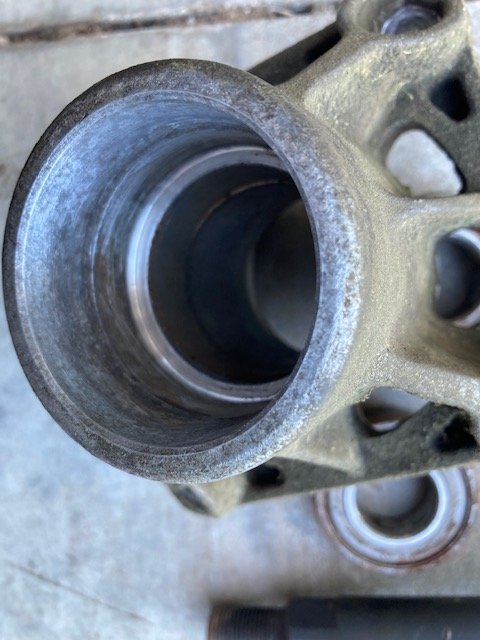

Hmmmmm......got the bearings out, they don't look that bad. Now I wonder if I am trying to fix what aint broke! Photos below for those interested.
RickB - I did not find a retaining ring like shown in the video. There is a slight lip (photo 569) to force the bearing past to make it seat. Not sure of that design, dont like having to force a bearing to fit.
