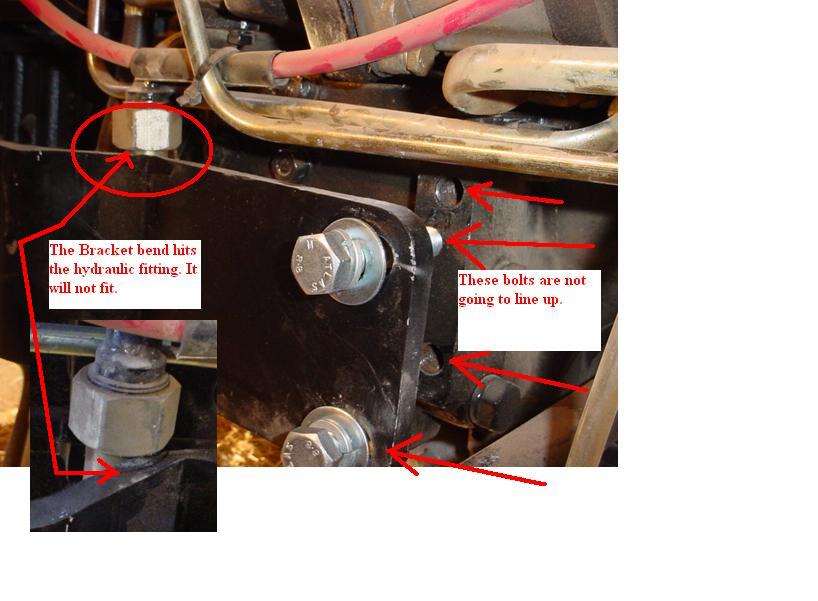

Well I went to install the Koyker 160 FEL onto my brand new 2005 Jinma 354 LE. I started on the left side and installed all the brackets NO PROBLEM it went smooth. So I figured well this is a breeze lets start the right side then OMG WTF, this is not right. Take a look at the three photos I am posting.
First I had to remove the clutch inspection side plate to install the FEL mounting brackets - no problem. But when I went to mount the FEL bracket it does not completely cover the inspection hole and all the bolt holes do not line up. Additionally the bracket will not go into place because it is hitting the Hydraulic lines coming out of the Hydraulic pump.
MY QUESTION :
Has anyone installed a Koyker 160 FEL onto a new 2005 Jinma 354? If so Please send me a photo of the right side mounting brackets.
I have e-mailed my dealer and will call Koyker first thing Monday to see what they have to say.
Stay tuned.........................................

Problem & Photo # 2 Mounting Bracket & Hydraulic line conflict.

Obviously they sent you the incorrect mounting brackets. Give Koyker a call, they are real helpful.

You have the wrong bracket,you need the LE bracket.I think the one you have is for a non-LE
The right bracket is the only one that changed on the LE. The right bracket completely covers the big hole,and the small inspection cover stays installed.
However since you drilled out the other bracket, I doubt Koyker will take it back now
