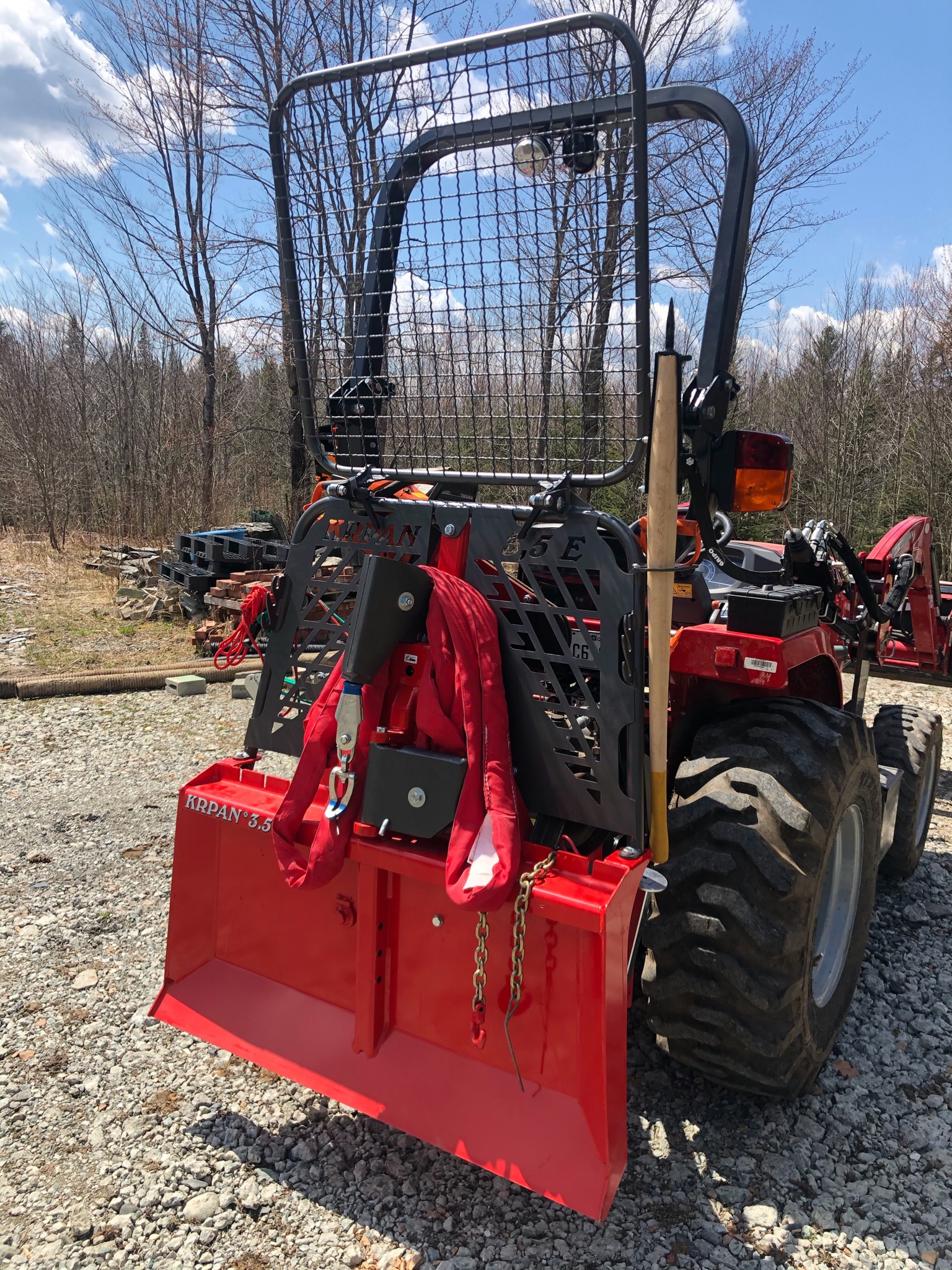

Done!

Congrats :thumbsup: Now you can be the Krpan guy - tell us how you like it when you get going.

Looks good! I have a Farmi winch and wish I would have bought a winch years ago. Two things to consider. One, a self releasing snatch block makes in much easier when your woods are dense and you can't get a straight line pull. I highly recommend getting one. Two, I had issues with the ropes to activate the winch and reel lock. They kept getting in the way and I would set the winch down on them. I tied a loop in the very end and an intermediate loop about half way. Now I can hang them up. They are alway usable and don't get tangled up.

I haven't done it yet, but a couple of pulleys mounted high on the protective cage will keep the ropes up out of the way. To the OP, congratulations. Please post some pictures of it working once you start using it. Despite what the specs indicated, that looks like it fits your tractor quite nicely.

Thanks both of you, it work great, a like the very long wire (230’), It was good help on a very muddy area. Pulley and good sling is essentiel in that case. But I need to get use to the control rope. Maybe your idea of pulley on the protective cage?
