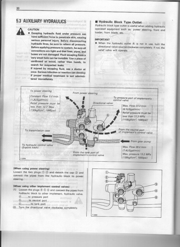

Hello, new here, have a kubota 2150 hsd that I am building a FEL for. my ? is, on the factory outlets it list 3 fiitings,
A: to pressure port of imp. control valve ( understandable)
B: from tank port of imp. control valve ( understandable)
C: from neutral port of imp. control valve ( questionable)
Is C power beyond port on loader valve??
Is this used because you have to turn the directional valve on the tractor?
any help appreciated, have a basic knowledge, just don't speak kubota

Does your valve have seven hoses attached?
There is no neutral, you will have.
IN port
OUT/tank port
PB port must use adapter
4 work ports

here is a picture of the "block" on the tractor
planning on using a 2 spool double acting directional control valve on the loader

Neutral makes sense as a name for a power beyond on a joystick, since when in the "neutral" position the fluid to the work ports is stopped and would flow to the PB circuit.
Check with the valve manufacturer to be sure. Lots of valves you can tell which it is, since they have a fairly complex plug with various o-rings.
