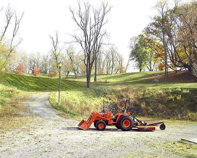

How often do you cut? And at what height do you set the mower, and how high is the grass? I have been using my rotory cutter here at my shop about once a month, but I used the finish mower the past two times since it was here. It does look alot better but I don't know how long I could go between cuttings. Here is a photo of the hills I am cutting, its very steap so I want to do it as little as possible.
/ Kubota 3010 used #17
Von -- How often I cut depends on the rainfall. Despite last winter's snowfall this is shaping up to be a dry summer, so mowing will probably be an every third week sort of thing. A couple of summers ago it rained or sprinkled nearly every weekday, so I was mowing every single weekend. /w3tcompact/icons/shocked.gif
I never let the grass get higher than a foot tall when I had the old underpowered B1750. Not sure how well Clementine will do, but since I was able to mow up that steep slope with no loss of power my bet is she'll do a much better job. FYI: the RD mower came set at max height, so that's what I used this time. Think I'll drop down a bit next time.
Pete
PS: That sure is some pretty land you've got!
www.GatewayToVermont.com
